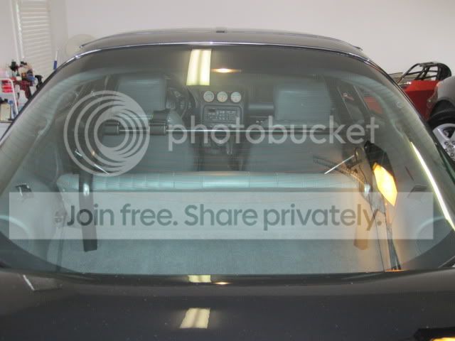

Quick question...did you remove the fuel tank in order to weld the two rear over-seat bars to the "floorpan?"
Old Mar 30, 2010 | 07:39 AM
03 BUSA's Avatar
iTrader: (25)
Joined: Dec 2004
Posts: 2,554
From: Kannapolis, NC
Yes I run at Mooresville and no removal of tank to weld in the bars.

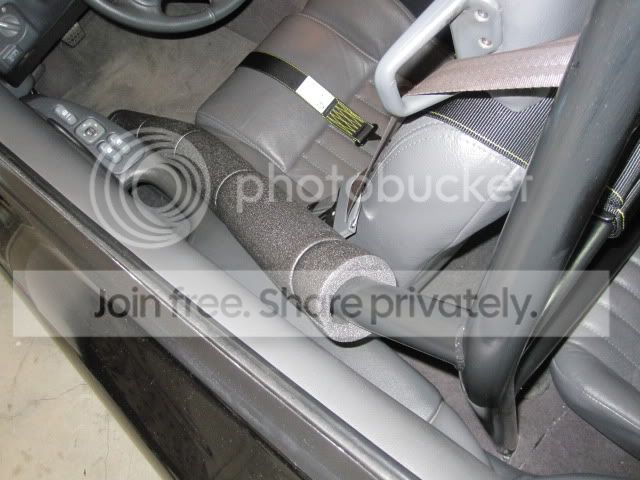

From the 2010 rulebook:
Adequate padding must have minimum 1/4-inch compression or meet SFI Spec 45.1. All
cars running 180 mph or faster, SFI Spec 45.1 mandatory. Don't need the expensive stuff yet (though its never a bad idea)
Old Mar 30, 2010 | 10:25 AM
ryarbrough's Avatar
iTrader: (18)
Joined: Jan 2007
Posts: 1,194
From: Mechanicsville, VA
Hmmm... Good to know. Was just passing on info from MM when he put his stuff on.

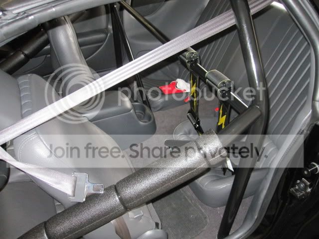

No halo?
Old Mar 31, 2010 | 12:04 PM
Broke EF's Avatar
Joined: Oct 2006
Posts: 1,190
Likes: 237
From: IL
Nope that is a "6" point roll bar. It depends how you count the points. Eric does not count the two diagonals off of the main hoop to the center as points (some do) so if you have a Cage from him with the halo and the front down bars he calls it a 8 point cage.
Sean
Old Mar 31, 2010 | 01:33 PM
  #33
03 BUSA's Avatar
iTrader: (25)
Joined: Dec 2004
Posts: 2,554
He might not but evryone else does. It is an 8 point bar good till 9.99 FWIW It is tying the bar to the car in 8 places. Did not do a full cage as I did not want to pull the dash just yet.

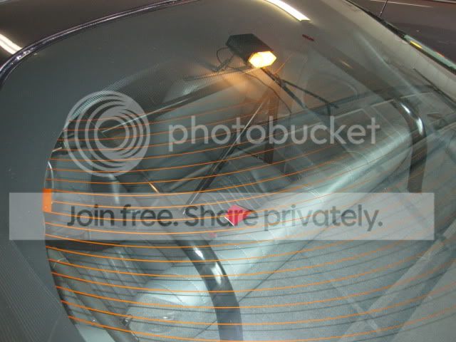

They MIG'ed a chromo cage in???
Old Apr 1, 2010 | 06:49 AM
  #35
Fireball's Avatar
iTrader: (21)
Posts: 8,484
From: Cecil County Raceway!!!
hard to tell from the pics...but it sure does look MIG'ed....lucky that it doesn't need to be certified by an inspector (since its only a rollbar)...but if it truly is MIG'ed then you are going to have to cut everything out and start over if you ever want to go 9.99 or faster

That pic is of the last bar we installed at 4am so we were both tired and ready to get home. The pic does look worse than it really is. And no it was not mig welded. We know better than that.
Will not put price on board, you need to call Eric. It is cheaper by a ton than everyone else.
