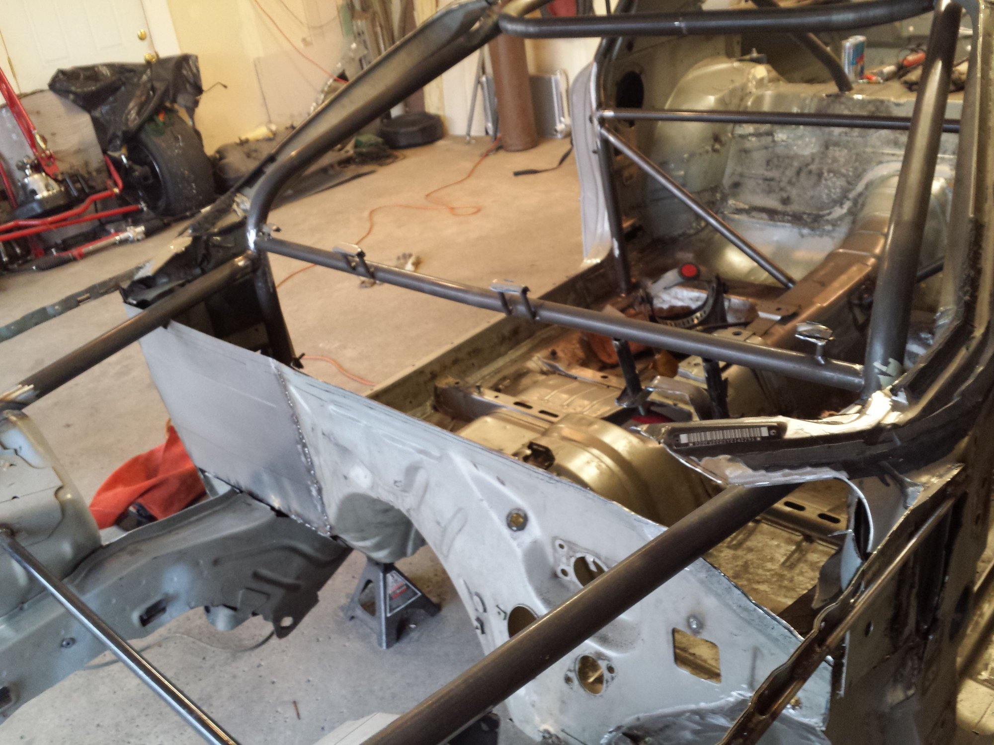

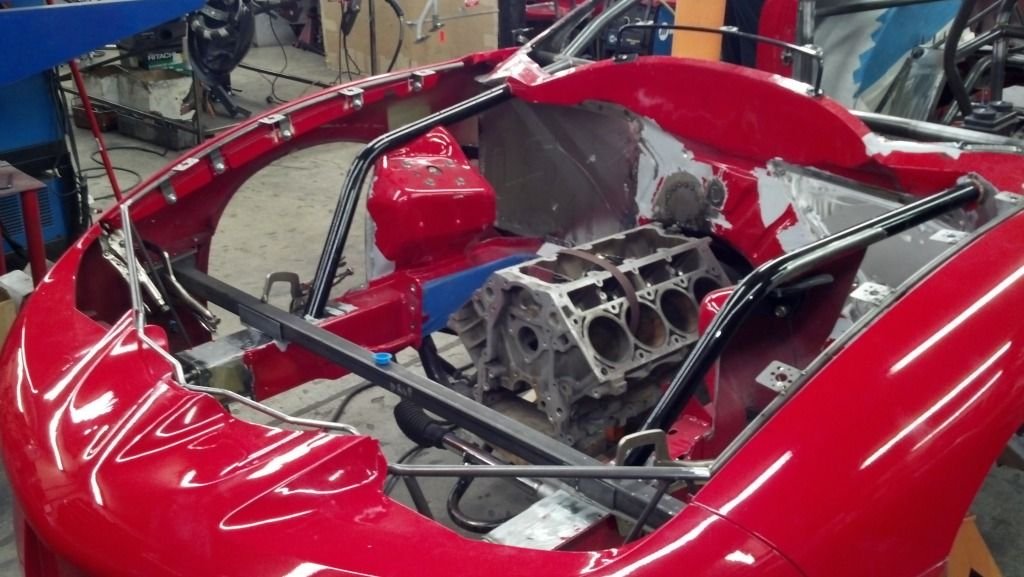

Mine is being done now.
doubt you can do it with the motor in the car.
Some of Brian Black's build

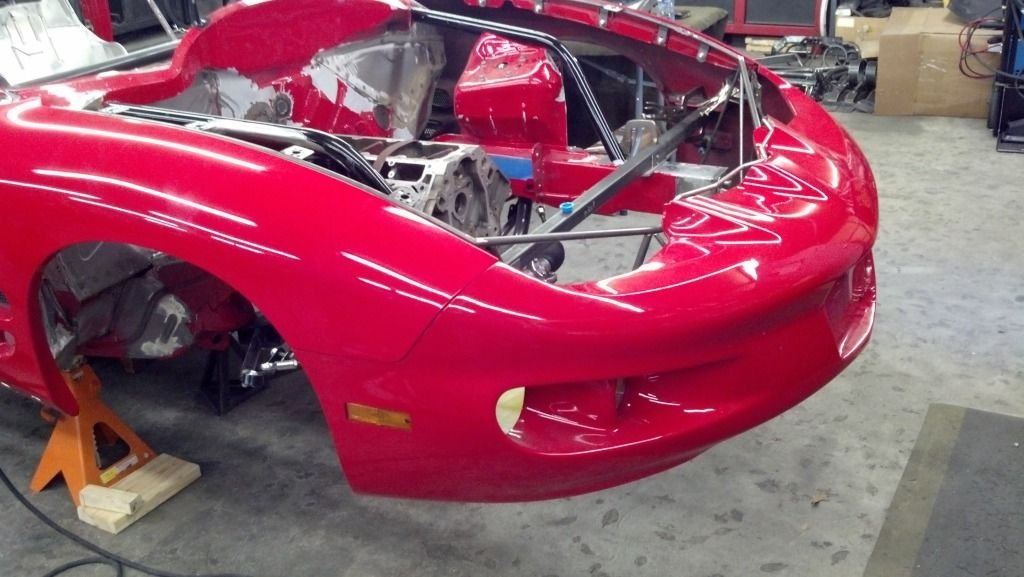

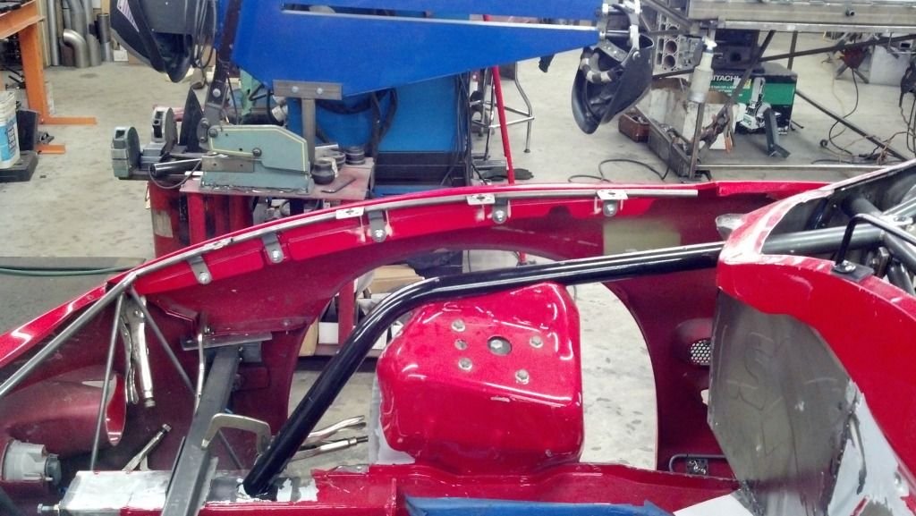

Prob a better question for ssvert99.

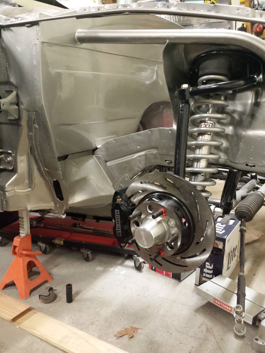

I'm not sure, my guess would be 50#'s, maybe less? It's a 1 piece front end setup. Makes working on the car a TON easier. Here's a shot of Andy's and I'm sure you can imagine how easy it would be to work on.

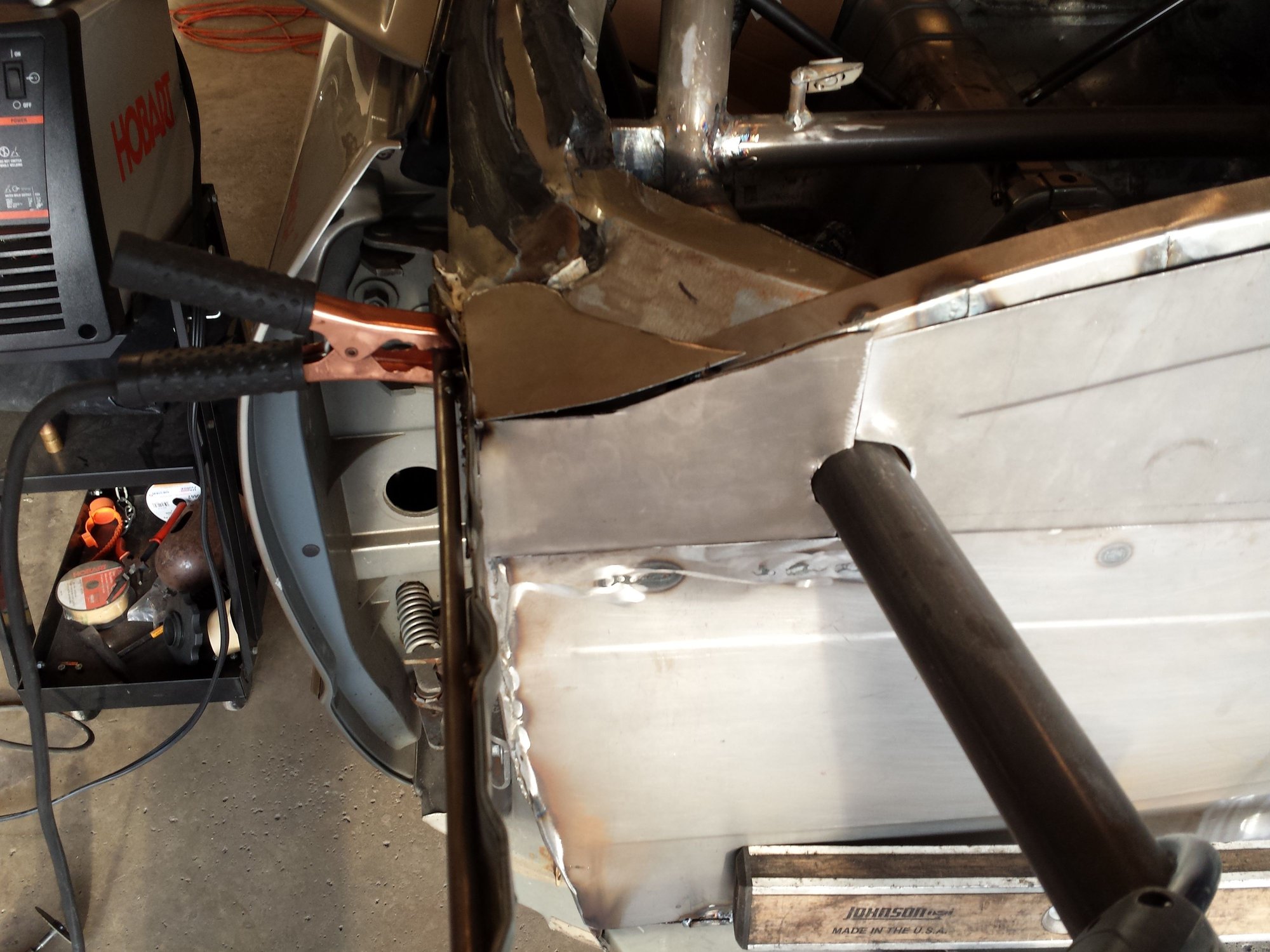

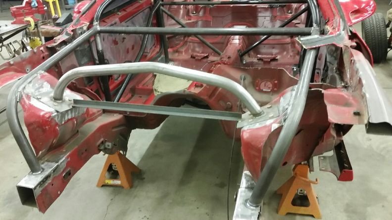

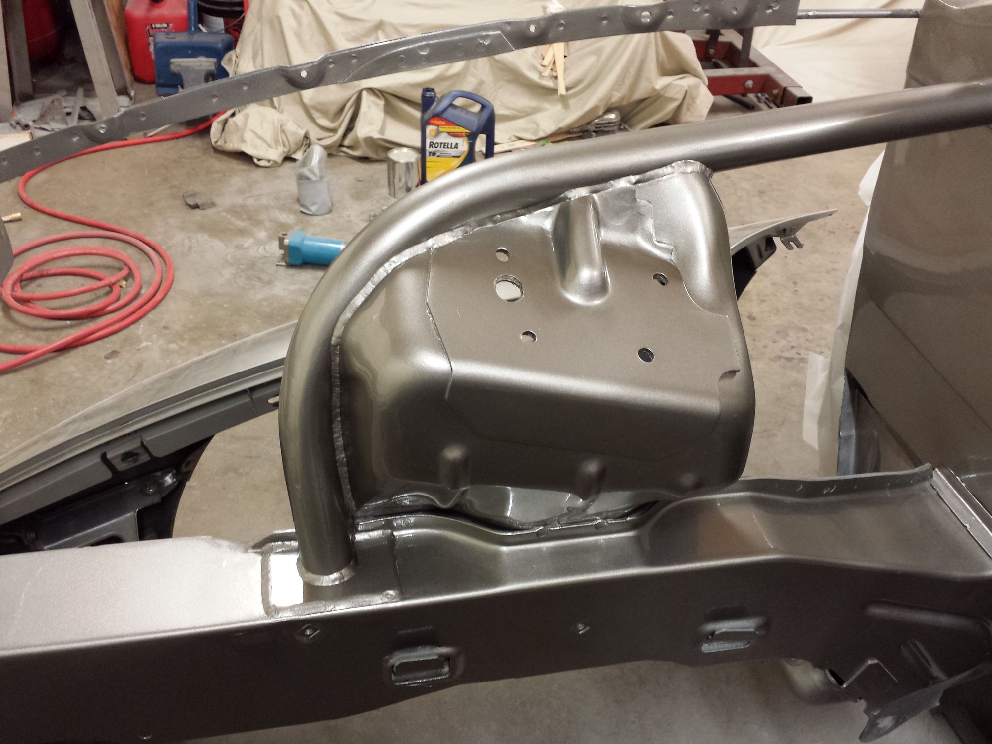

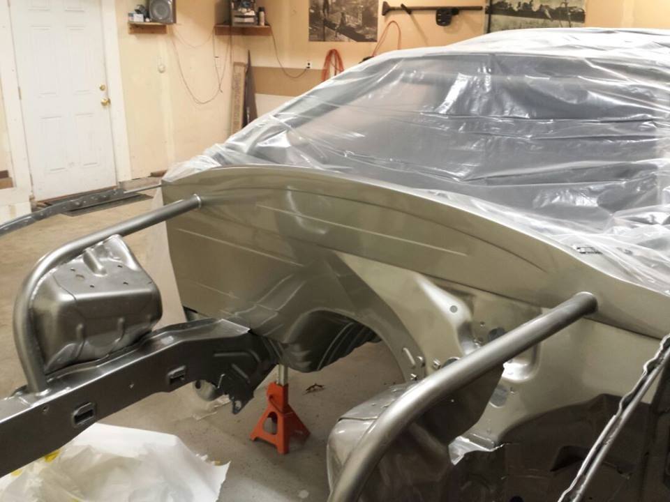

here is mine just sprayed it turned out flawless still have to install the lexan i got everything from eric at midwest and can honestly say i don't think i would ever go anywhere else took awhile and i cut a lot out also but i know eric will be proud!

Sorry there not in any order this is a pain do do this from my phone

Great Job, did you mig weld around the J bars where they go through the firewall?
