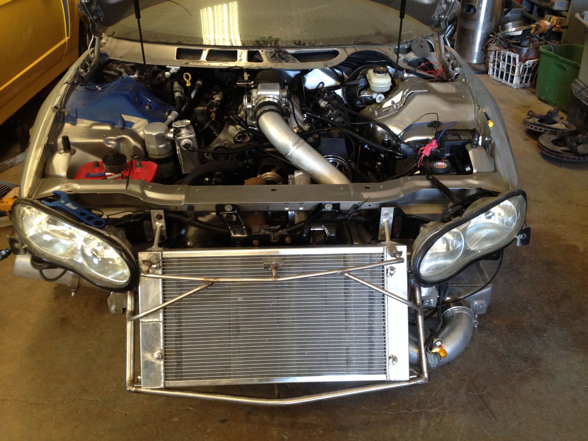

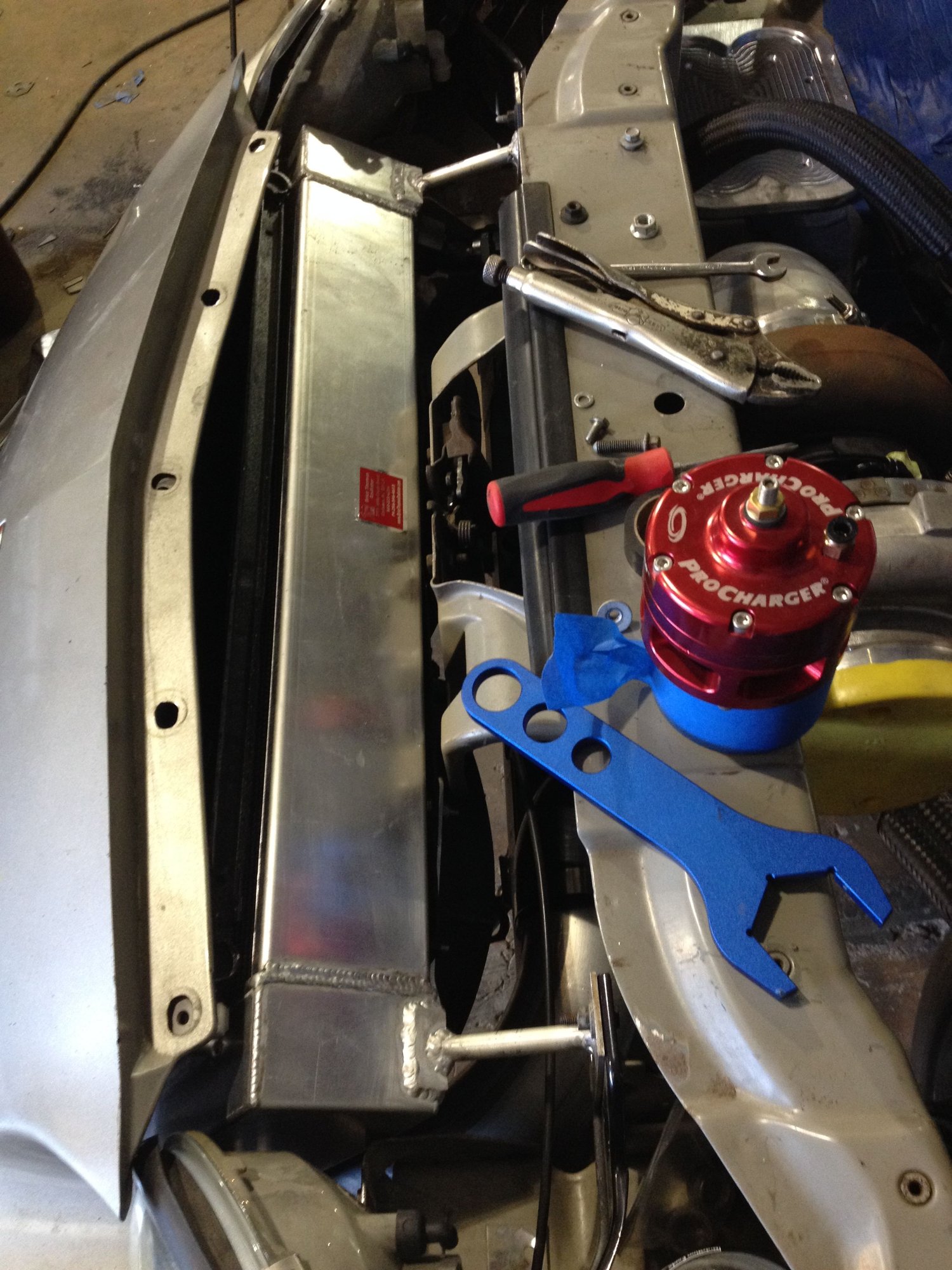

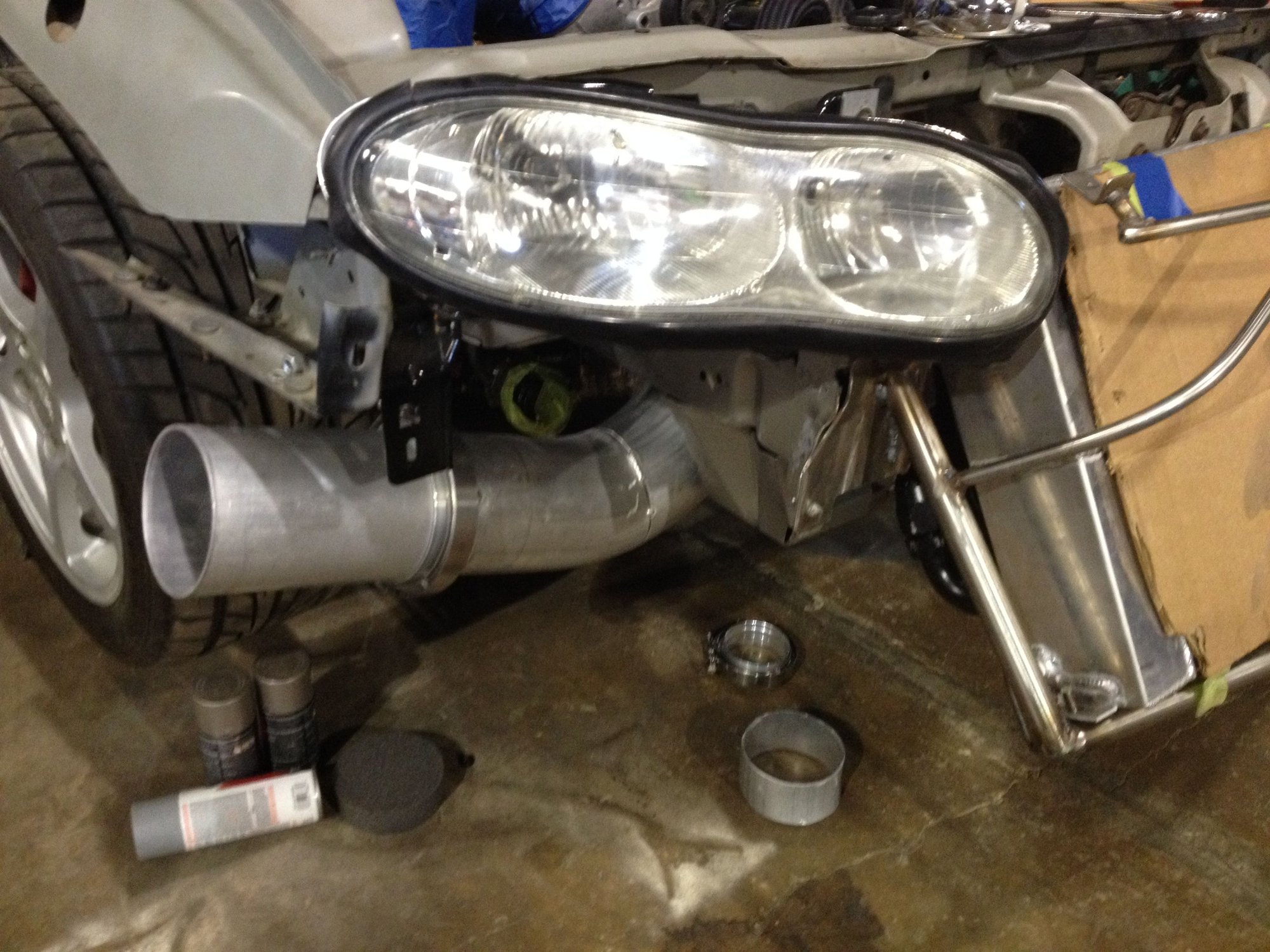

You mean like this?

tha's pretty sweet. how are you making your hood stay latched? pins?

93camaro_zzz's Avatar
Joined: Nov 2005
Posts: 2,211
From: San Diego, Ca.
Yeah, I run those aerocatch hood latches on mine. You can see the red rods on each side of the car.
Also, this was the radiator I used. I measured the space I needed to fill, and this one fit the bill nicely.
http://www.summitracing.com/parts/gri-1-25241-x
