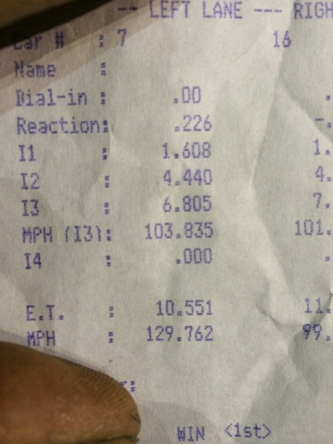

Here's the time slip for this pass I'm also running out of gear up top.

She is definitely making the power and moving on the backend.

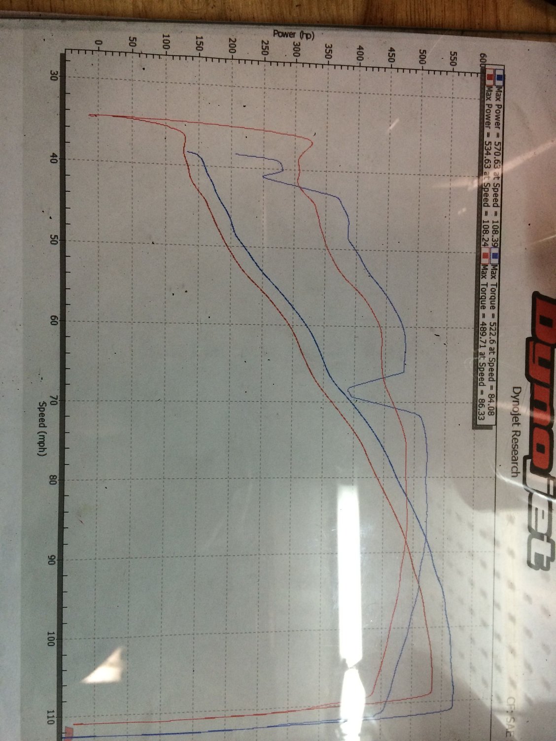

Here's the dyno sheet. They did it in mph rather than rpm. I think the loaded part jacked the numbers up. It laid down 535 through the sealed ram air set up then he loaded the dyno and it went to 555. Then he pulled the air box lid off and ran a open bellow and it went to 570.63. My valve train is ls7 lifters (only about 30 preload) hardened pushrods stock rockers and the PAC 700 springs. Cam is a 251/259 .624/.624 114+3.

Graph looks nice and smooth, but at 108 mph we both know that wasn't revved out as high as your running it at the track, so we can't use it to attempt to come to any type of theory.
I will say that your cam is larger than mine, and every characteristic of it would push your powerband higher than mine, if not limited by the intake that is. Point being I don't think it should lay down like you describe.
That's rather light on the preload on those lifters. Any particular reason u set them that light? What diameter and wall thickness pushrods are u running?
I don't have any experience with those springs, so I haven't a clue what their open and seat pressures are. I can say I shimmed my AFR 8019s for better valve control. I also went with custom length 11/32 .120 wall pushrods for less deflection. Morel 5206 link bar lifters in case your curious.
