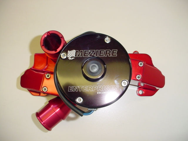

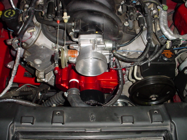

It was actually a pretty simple mod. But then again, I'm not running AC or my heatercore for the time being. <img border="0" title="" alt="[Wink]" src="gr_images/icons/wink.gif" />
I first want to say thanks to Meziere, because I called them last tuesday and they said they didn't have any ready to go. I told them I needed it this wednesday and it was Here! I'll have to call them and express my appreciation.

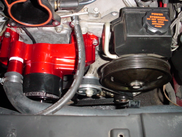

They sent me the WP119HD? pump for street use and their NEW eccentric tensioner for the LS1. The pumps was around $370 or so through a local hi-performance shop and the tensioner was like $70 extra. You can use it with or without the power steering, just use a shorter belt. But the shorter belt version, the rib side of the belt will be on the tensioner. Boohoo! And I couldn't find a short enough 6 rib belt so for now the 5 rib will have to work. <img border="0" title="" alt="[Smile]" src="gr_stretch.gif" />

Wow that looks badass! You didn't happen to weigh it did you?
I wonder how it would do on a daily driver.

cool deal! i figured someone would do it soon. how are your temps and all driving around. no t-stat? any issues?
BTW....whats with the power steering? you can pull your a/c and heater...but not the PS? odd.

Yes it does look badass. I was never worried about looks under the hood, but I think I'll spend a little time detailing it up now. <img border="0" title="" alt="[Smile]" src="gr_stretch.gif" />

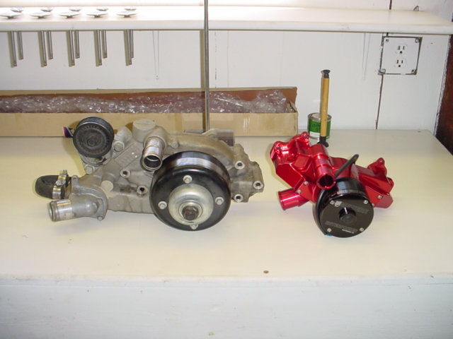

Did I weigh it? I weigh everything! Stocker was 16lbs and Meziere 8lbs. 8lbs savings. <img border="0" title="" alt="[Smile]" src="gr_stretch.gif" />
You can hardly even hear the electric motor, but it works great. I let it idle for 1/2 hour last night and it came up to operating temps and stayed there just like normal. Driving around is normal as well. I can't tell you any seat of the pants improvement yet because I swapped the drag wheels/tires on at the same time. But lordy does the car want to pull.
Another cool thing about it is that I can turn on the pump in the staging lanes and cool the car without starting it.
I could easily pull the PS but it's a street car. <img border="0" title="" alt="[Wink]" src="gr_images/icons/wink.gif" /> My AC hasn't worked in years and who needs a heater in the summer? It's a handful now without the power steering belt on, so I'll leave the PS alone for street driving. Otherwise, the PS is easy enough to take out.
On a side note, I did remove the power steering cooler. It weighed 4lbs. So I probably saved 5lbs with the extra hoses/clamps/fluid that were attached to it. <img border="0" title="" alt="[Big Grin]" src="gr_grin.gif" />
And the diet continues.....

Jantzer, for some reason I can't see the pics... I get a message that I'm forbidden <img border="0" title="" alt="[Roll Eyes]" src="images/icons/rolleyes.gif" />
Any chance you could email those pictures to me? I really want to see the tensioner. I want to put a Meziere pump on my car, but two things are stopping me: 1)I need to figure out belt routing w/o the PS pump, and 2)I still don't have a motor after waiting 2.5 months so far for ARE <img border="0" title="" alt="[Mad]" src="gr_images/icons/mad.gif" />

Nevermind, now I can see the pictures for some reason. Looks nice!
