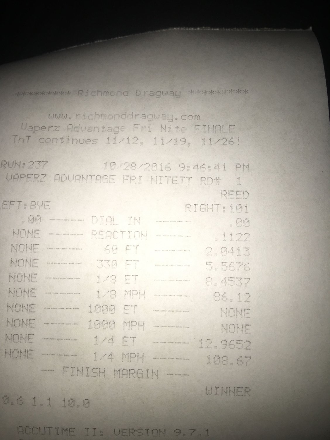

i have a 01 z28 bolt on car a4 with 2.73 gears my problem is the car is faster when it is spinning if I heat the tires up it bogs bad car spun off the line and went a 12.96 with a 2.04 60" pulling around the water with drs just doing a dry hop When I heated the tires up it went a 13.05 with a 2.00 60" I'm wondering will a 3.42 swap help with this I know get a converter but I'm still saving for it I found a 3.42 rear for $200

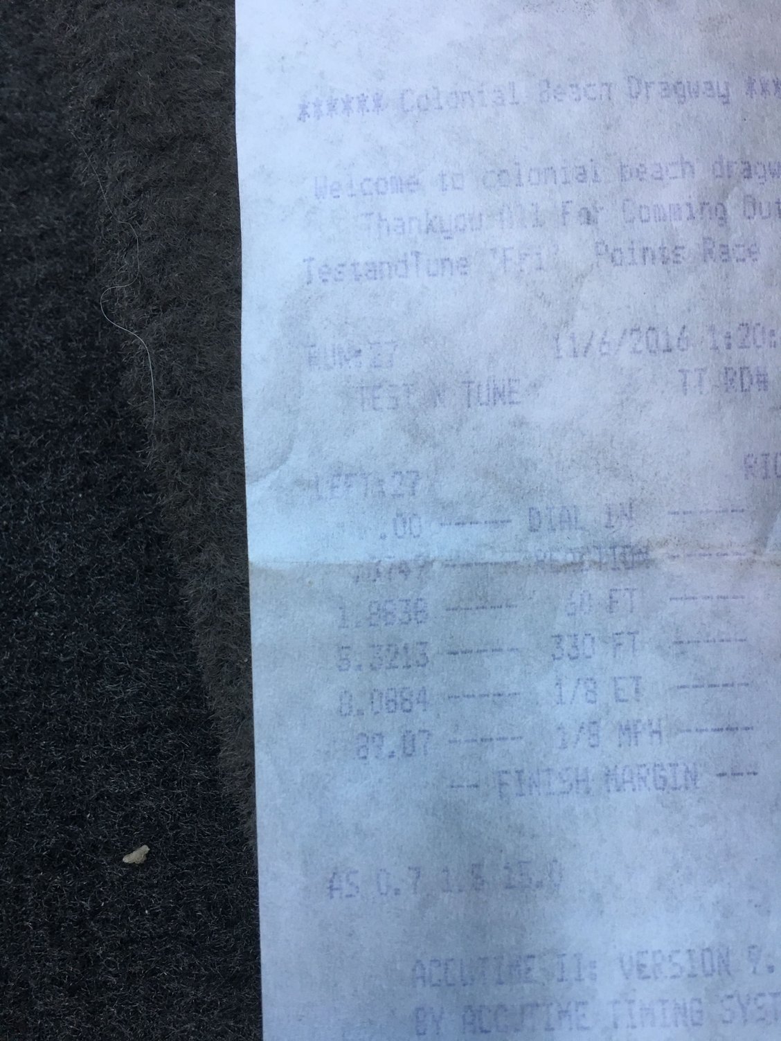

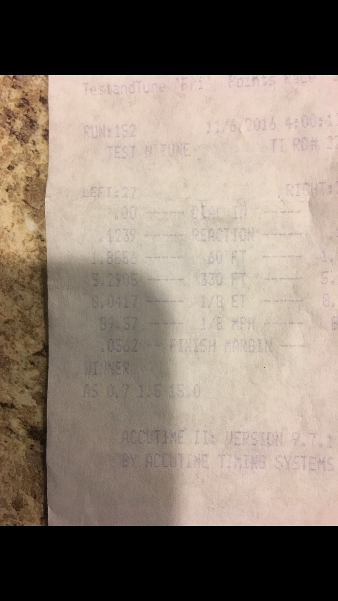

Looks like the gears helped guys nothing has changed but the 3.42 gears other than that same exact setup... and I'm willing to bet the air was worse

3mph in the 1/8th is a pretty big improvement with just a gear change which surprised me. I figured the 60' would improved a bit.

it surprised me too in a good way hopefully that's 12.5s in the 1/4 won't know until this coming weekend

Nice. 4 tenths in the 1/8th. Exactly what my car dropped. Just sucks mine was on a 3200 stall. lol. But I wasn't trying to maximize that N/A setup.
