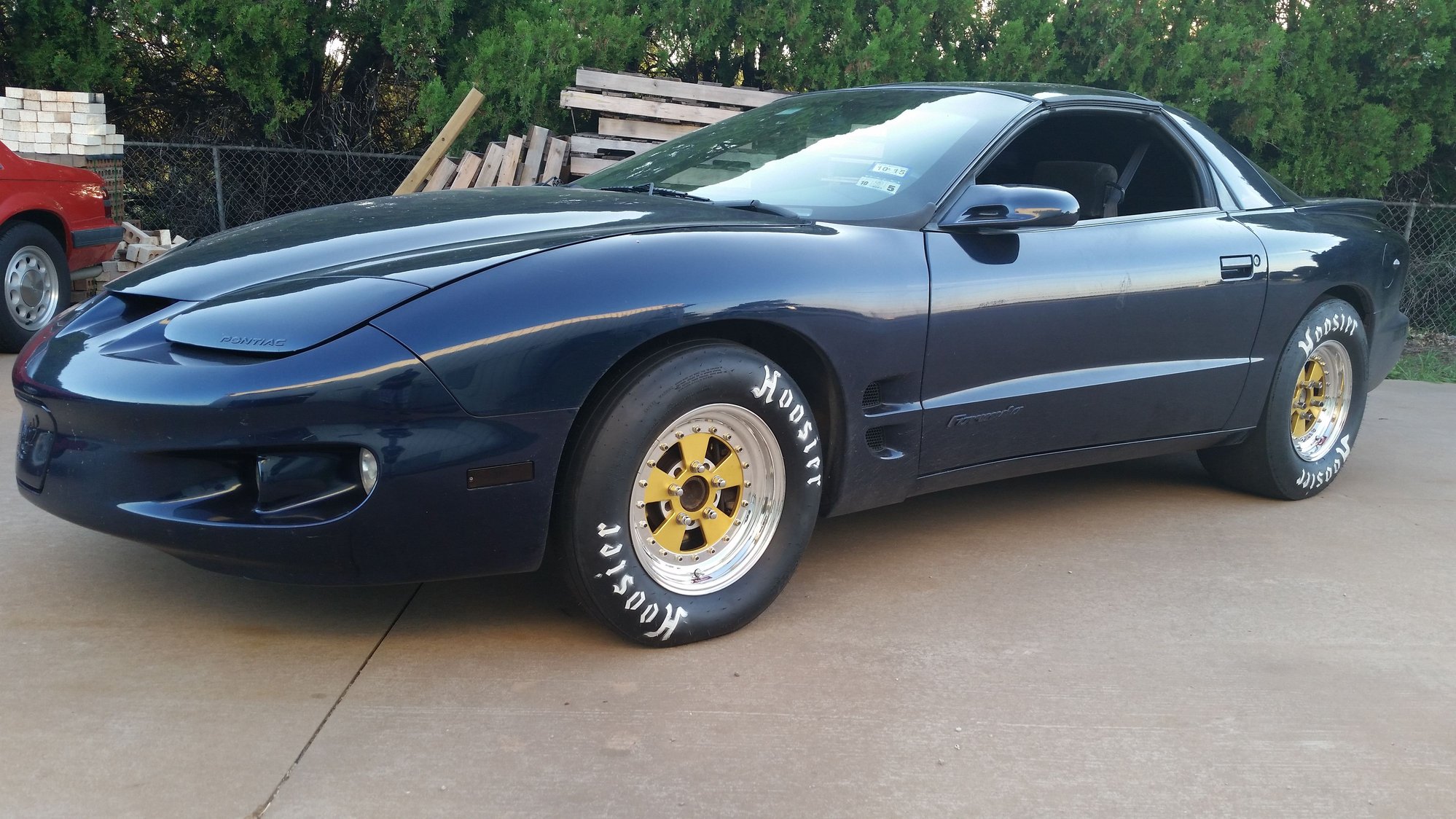

i run a 27'' hoosier qtp and my car hooked real well, 450ish rwhp m6

He's a close buddie of mine. Anyway he's running 9" with 4.10s
