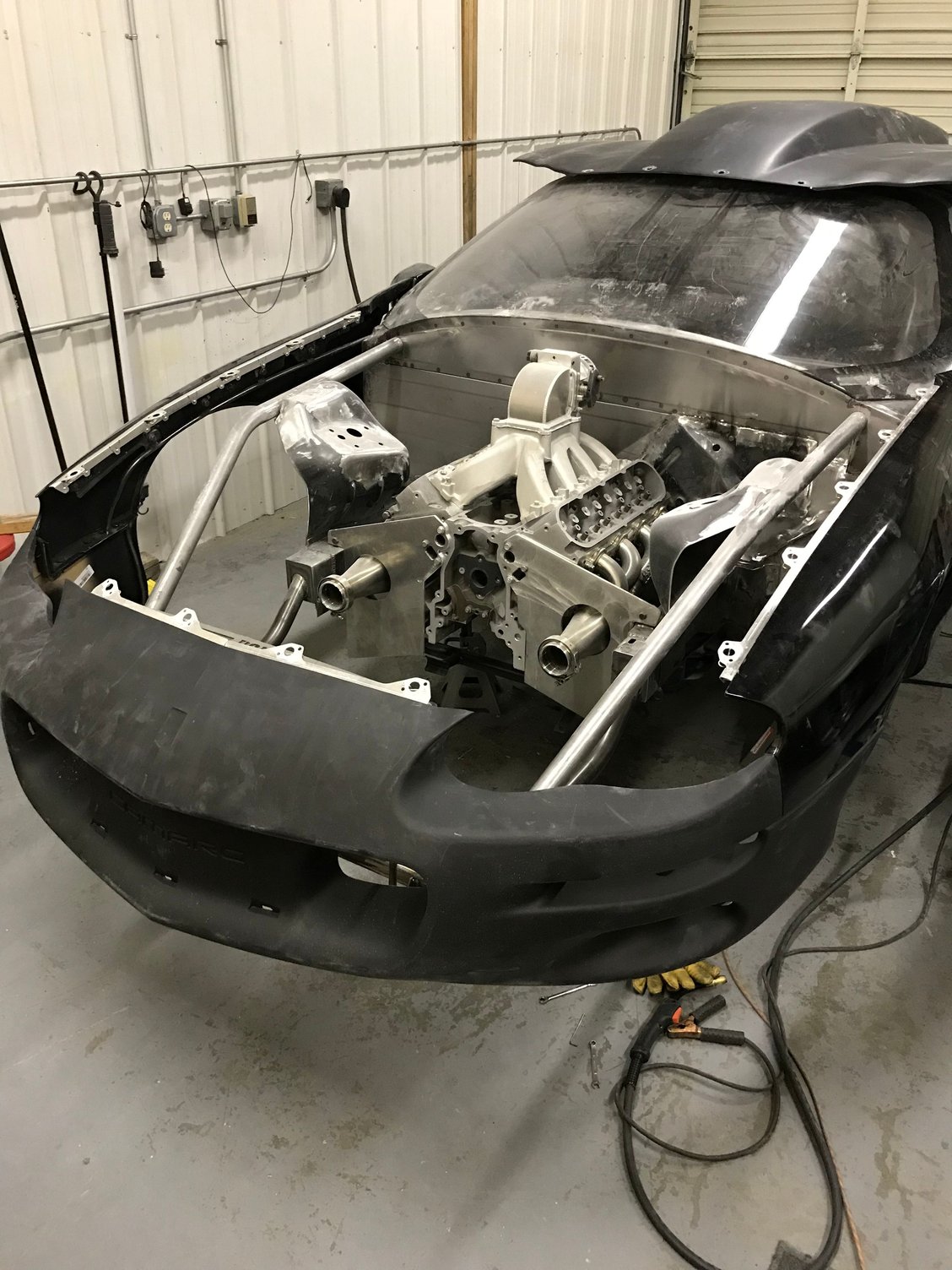

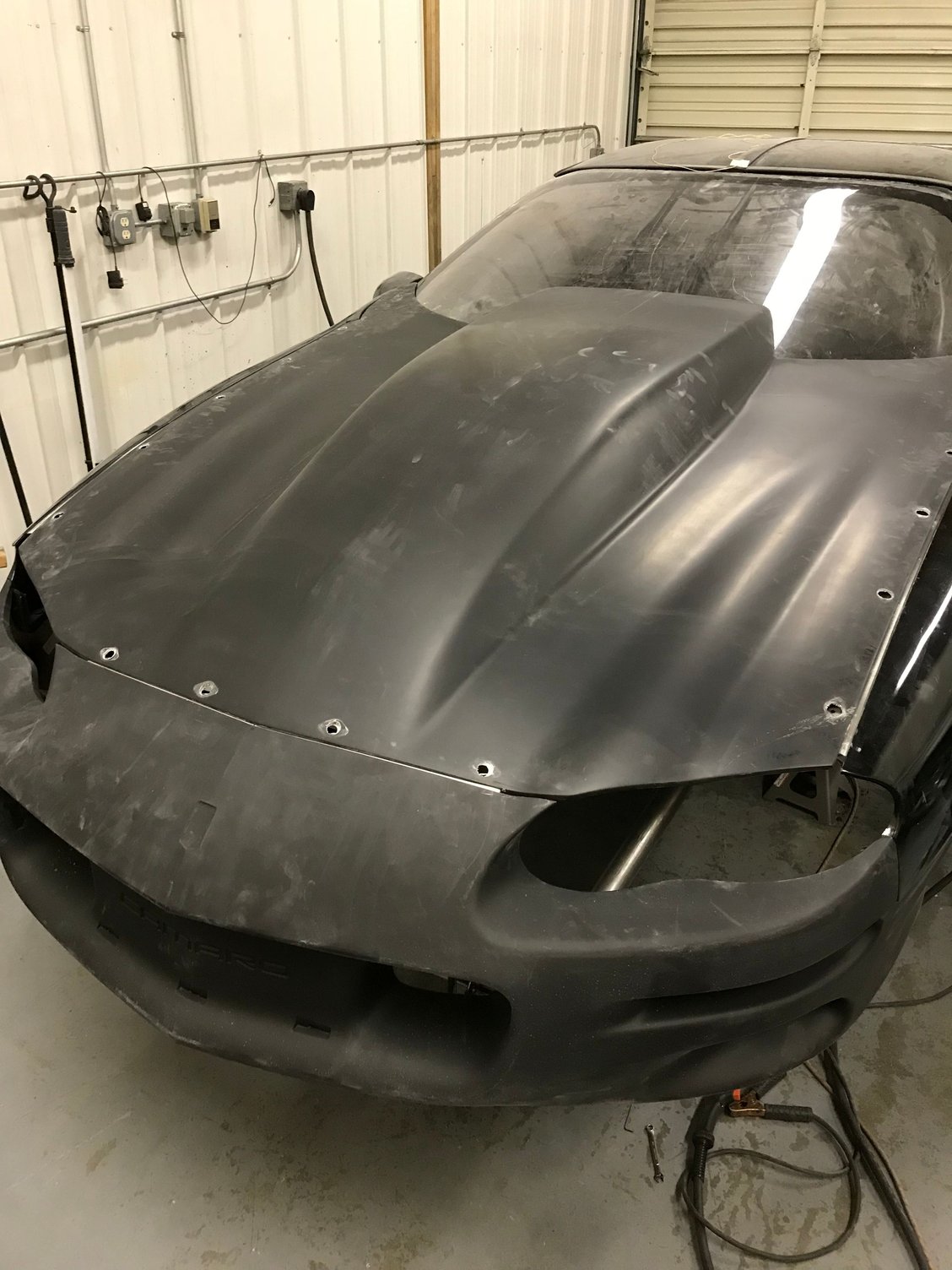

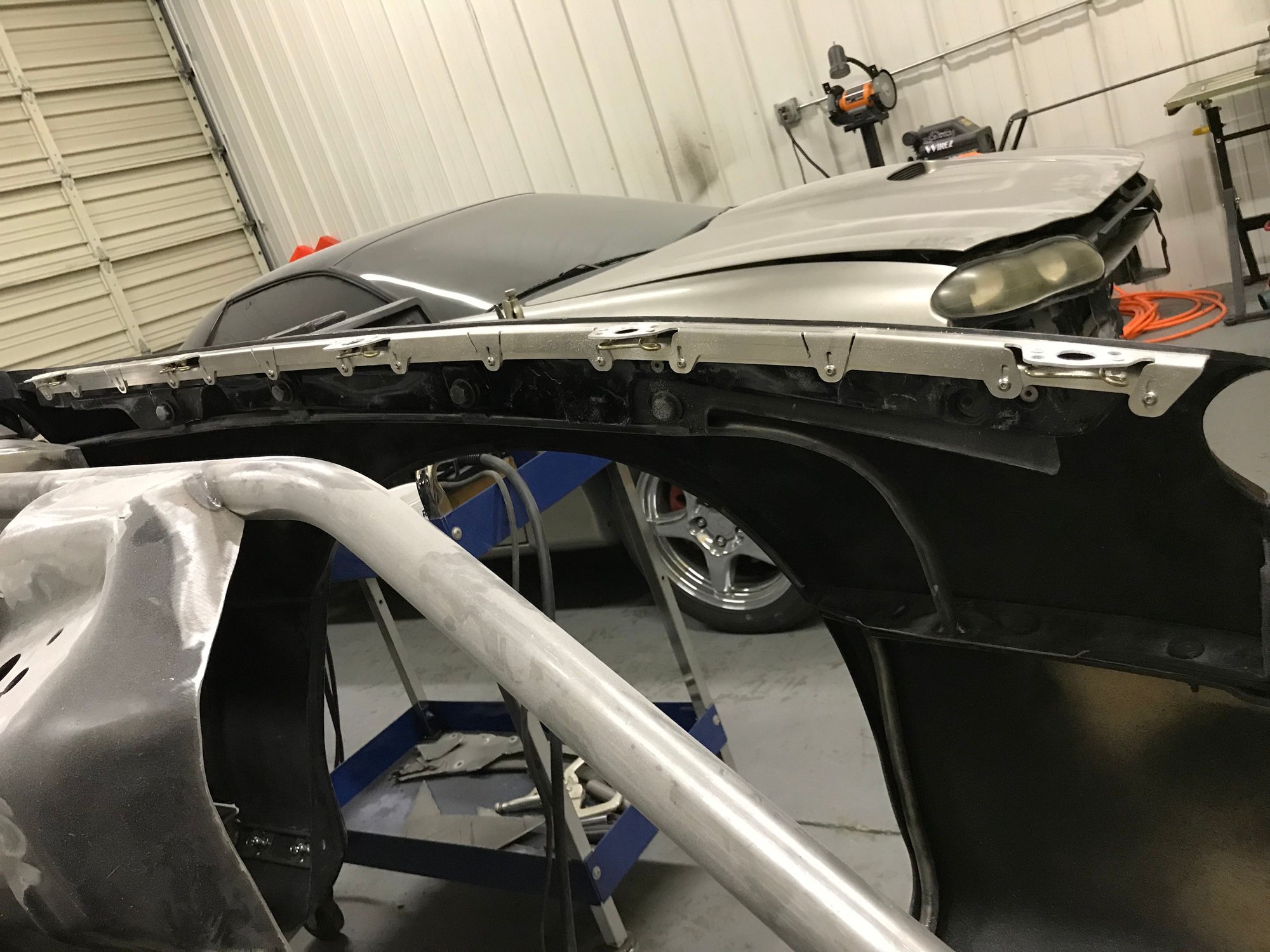

Latest progress. Mounting fenders and building dzus brackets for them. making the one piece front end bars, framing and drilling holes in the hood, mounting dzus rails and 5600 screws! Very very time consuming lol

Looking like a car again!

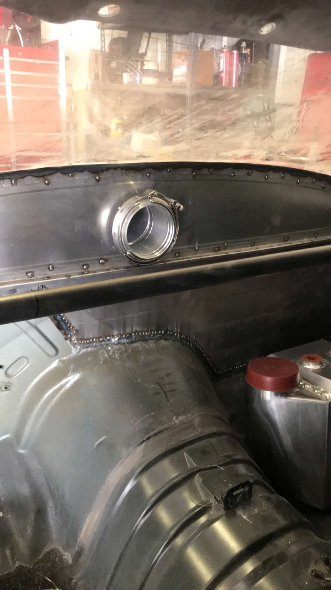

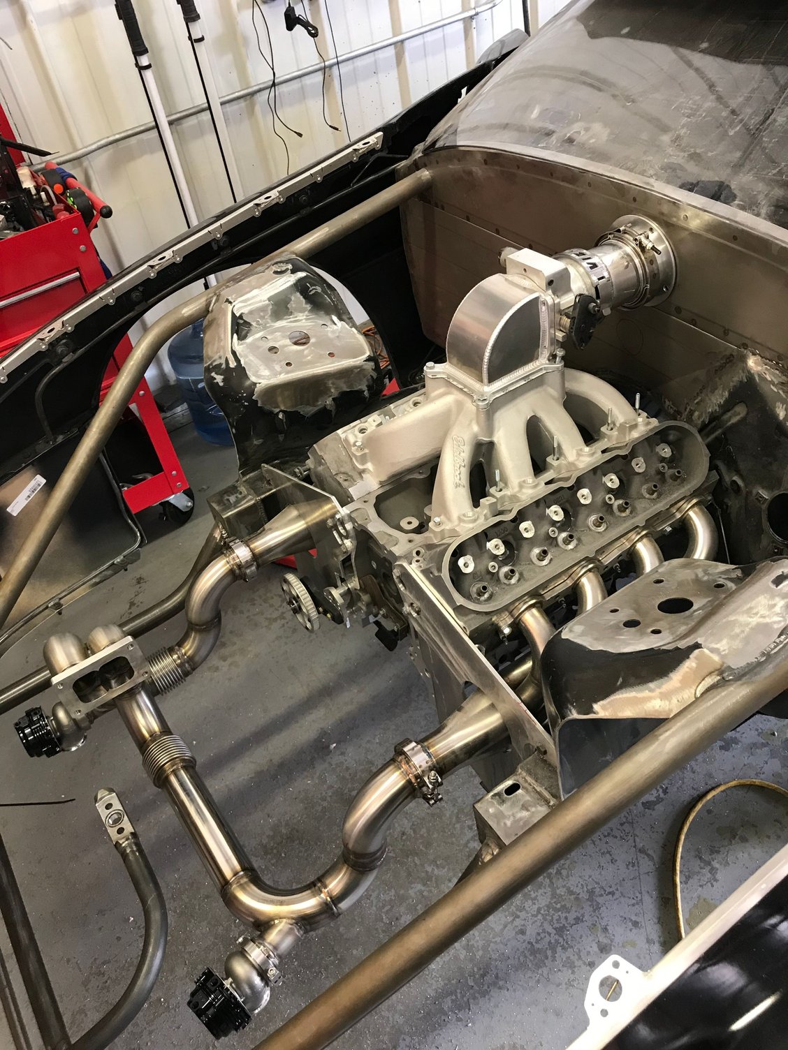

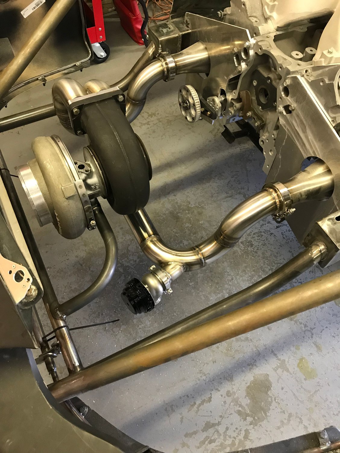

Are you gonna put an ice box in the intercooler setup,is that why the throttle body is facing towards the cab? ,sure is sum pretty pipe work you did thus far....I like the simplicity of your hotside merging pipes on the turbo flange , I'm sure the cold side is where Its gonna get tricky...
Old Jun 24, 2018 | 07:23 PM
  #50
121's Avatar
121
Joined: Mar 2011
Posts: 356
From: Wyo
Yea air to water is in the cab. I try to make it simple lol. I hope cold side isn’t that bad. I have another firewall pass through for cold side. Waiting on turbo to come back from forced inductions.
