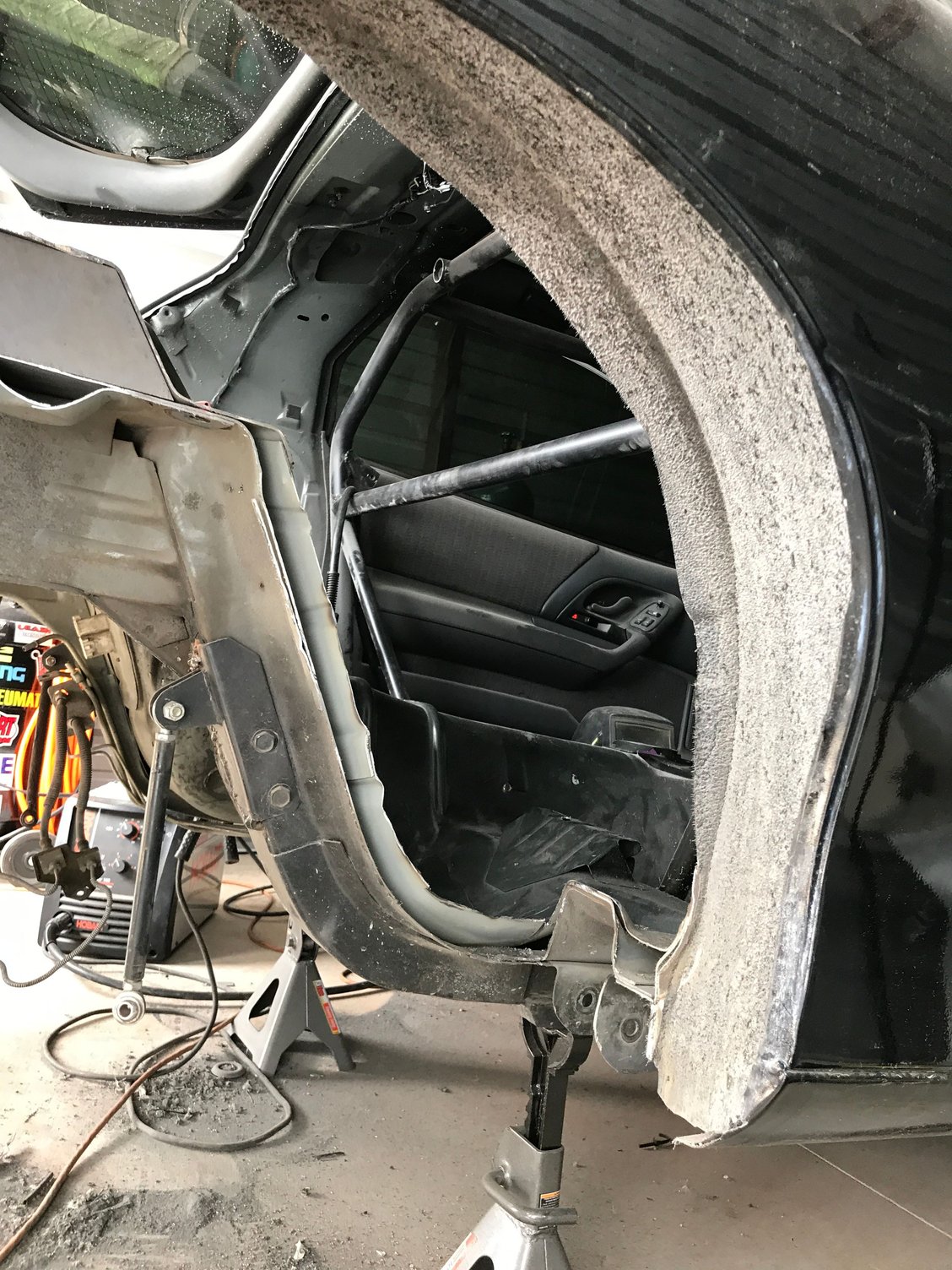

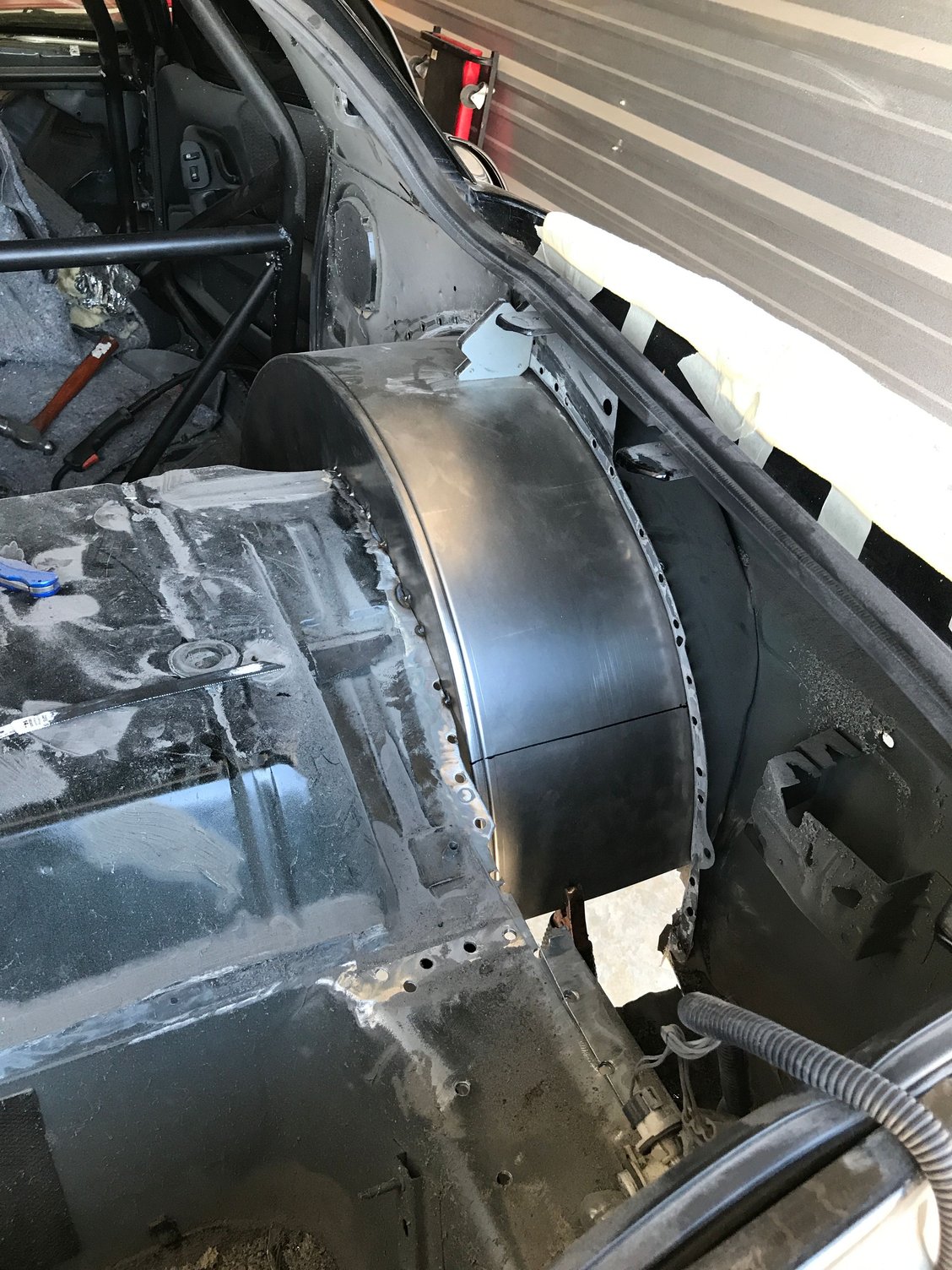

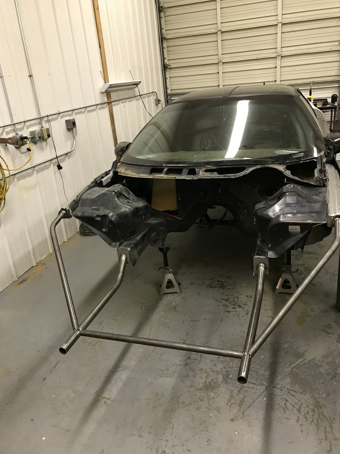

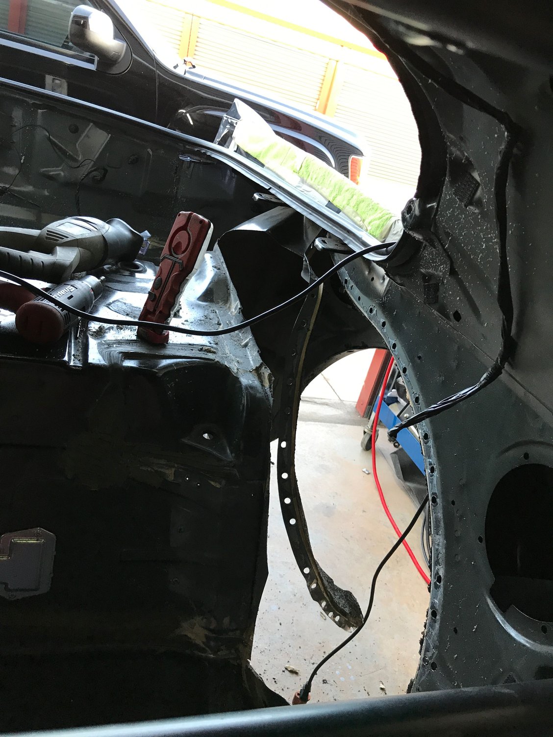

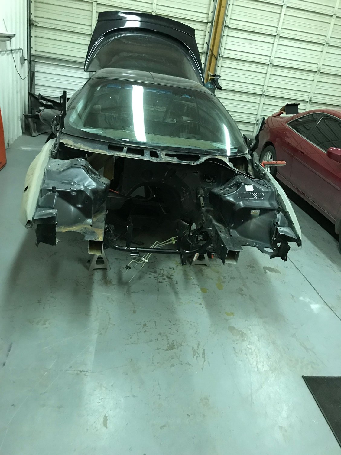

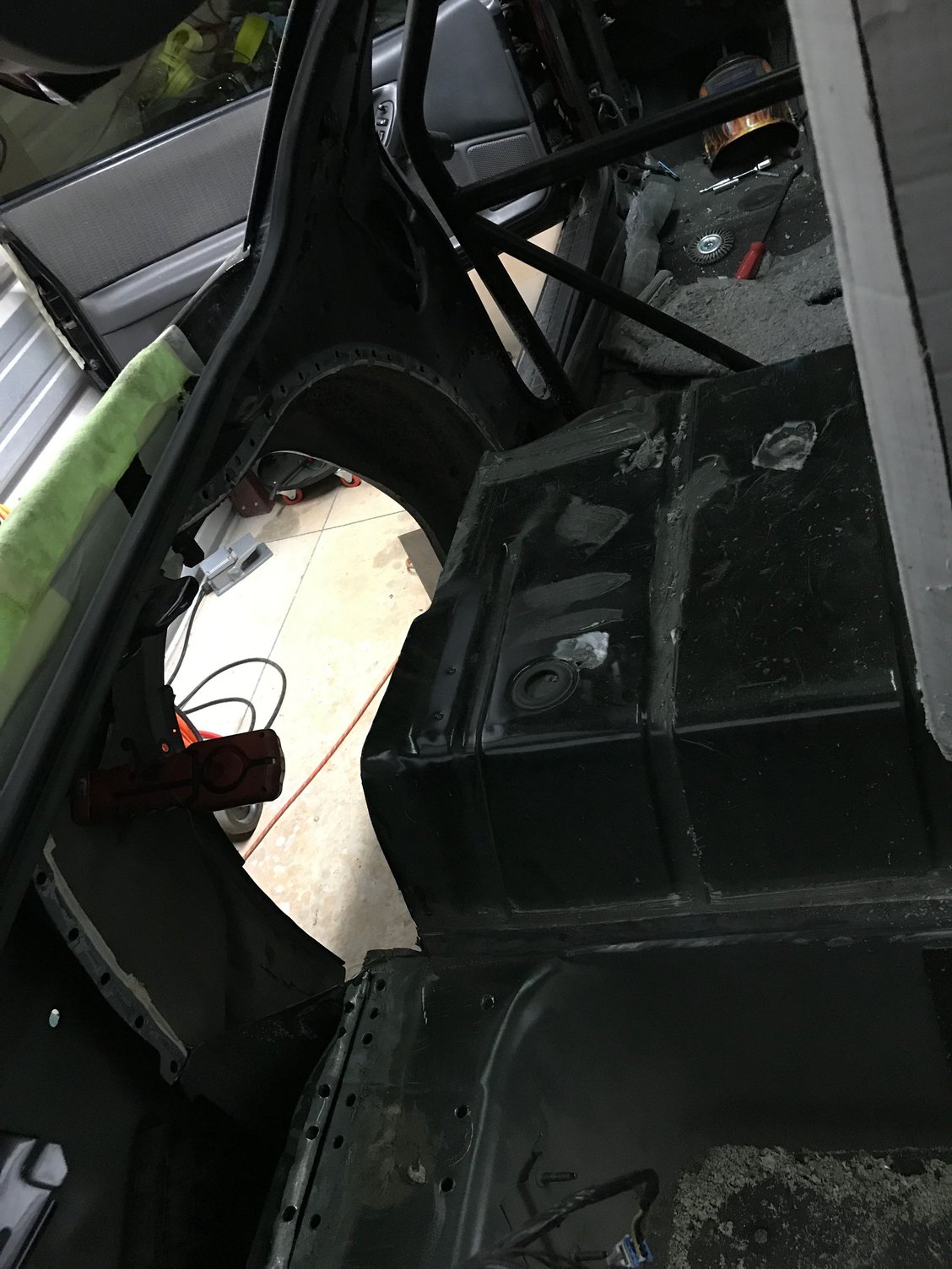

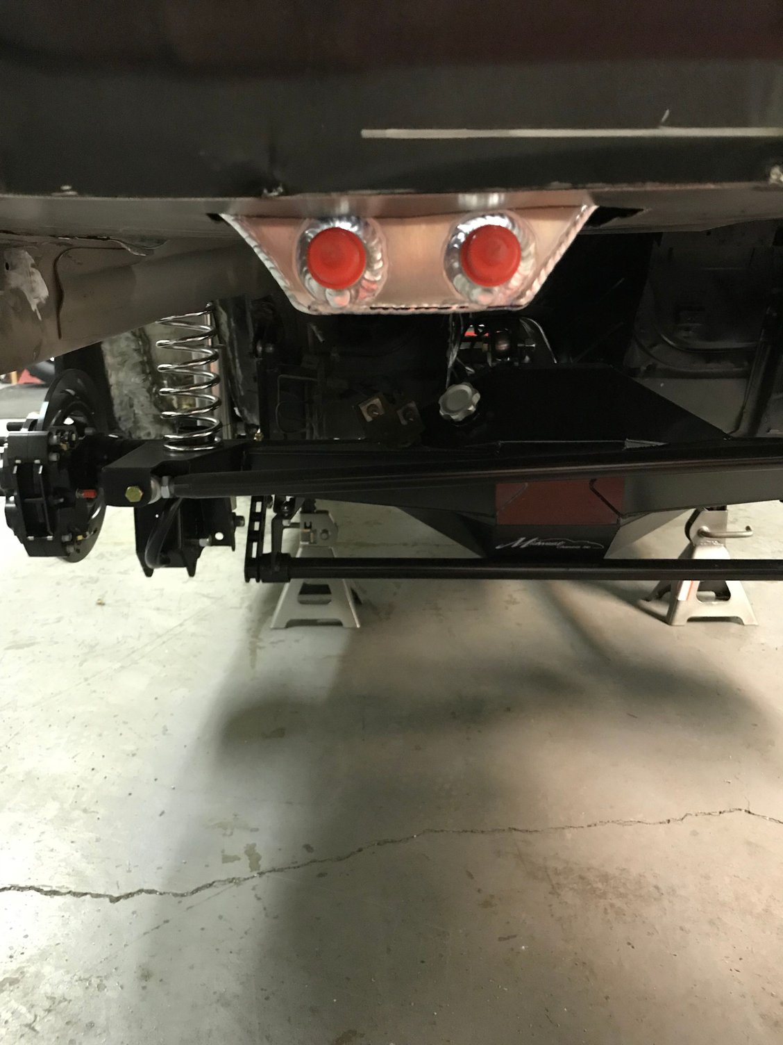

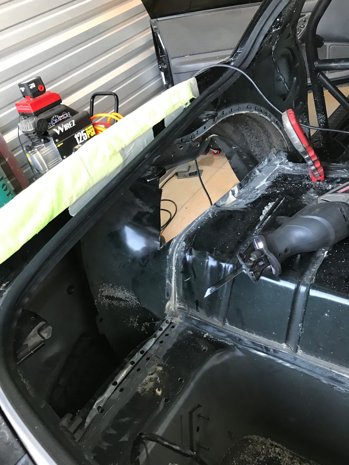

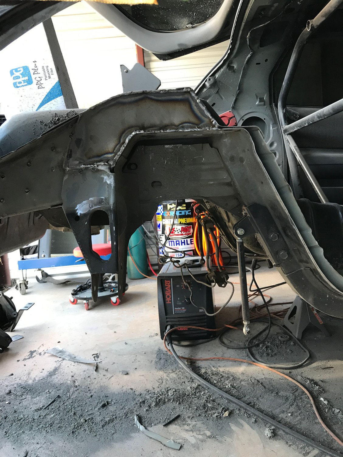

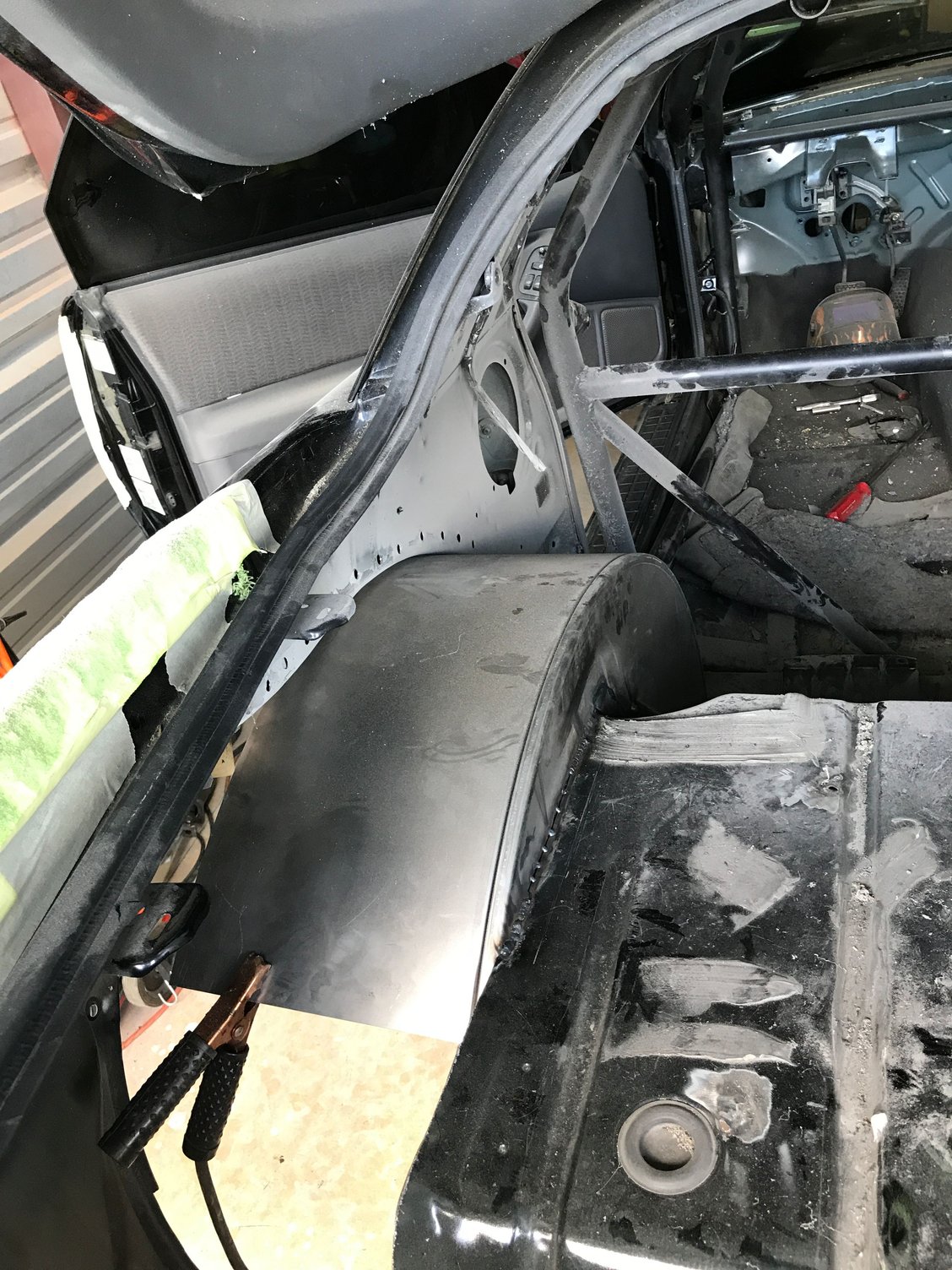

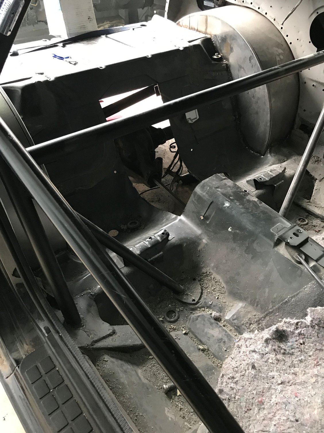

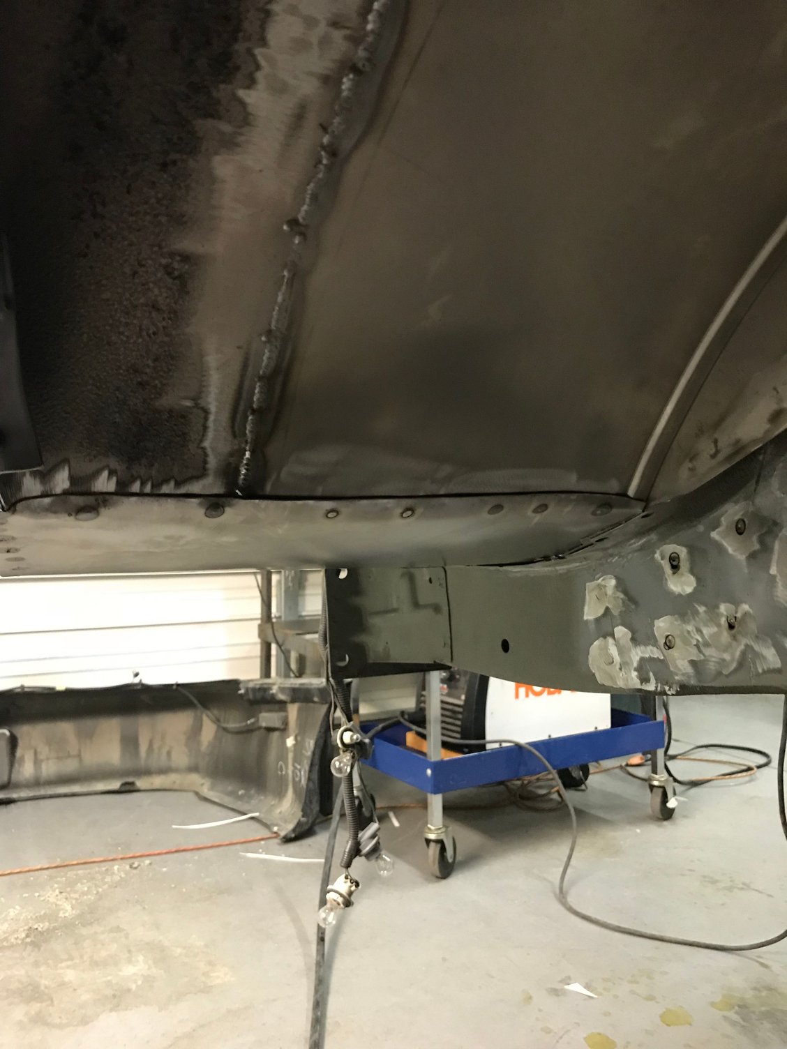

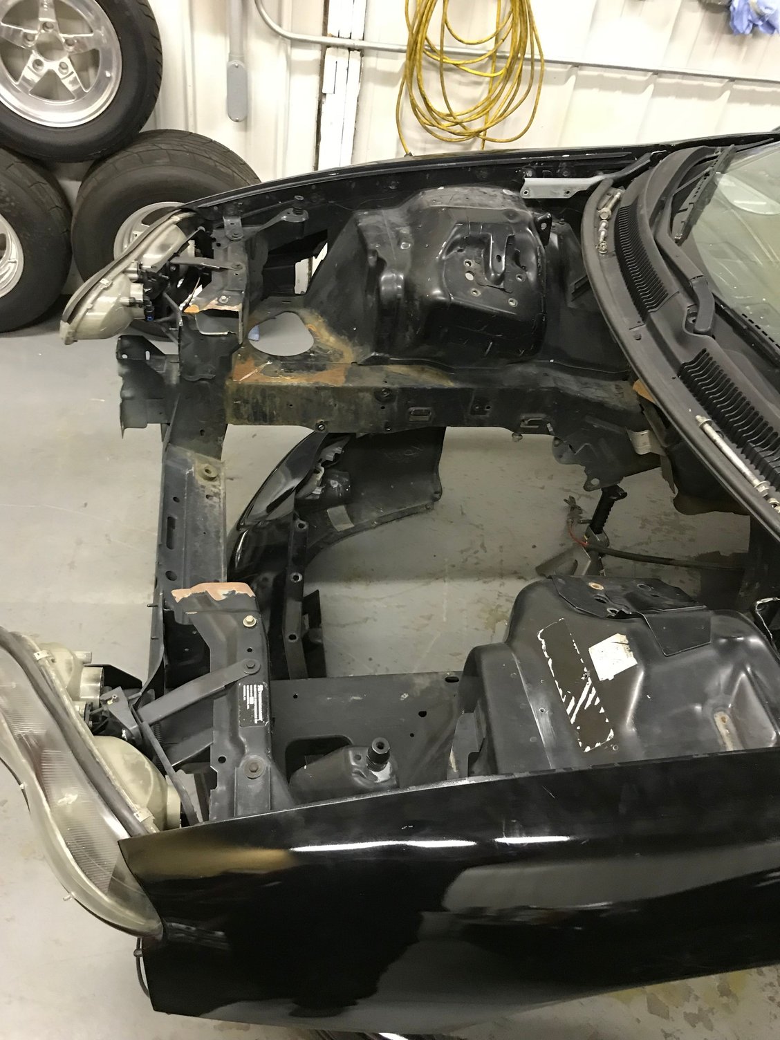

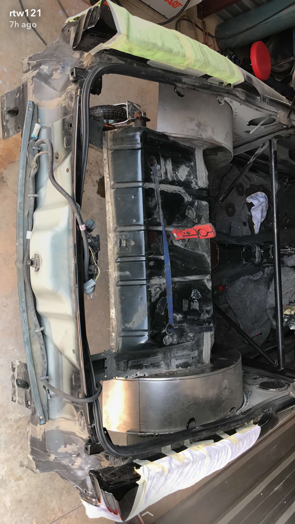

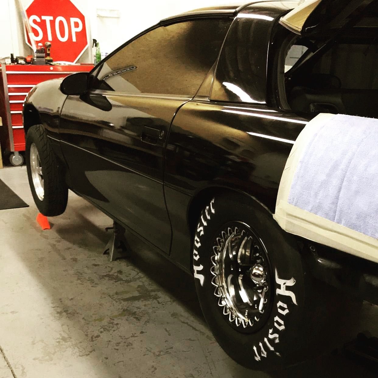

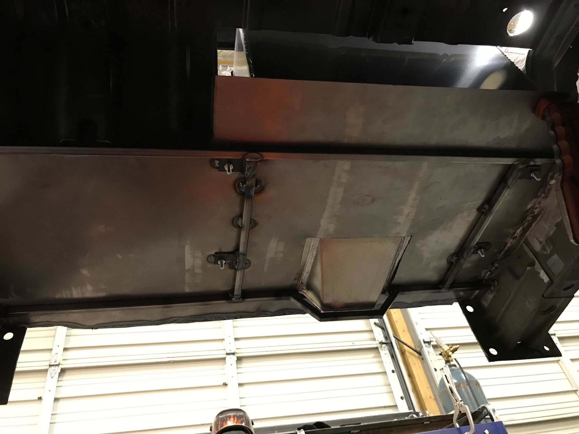

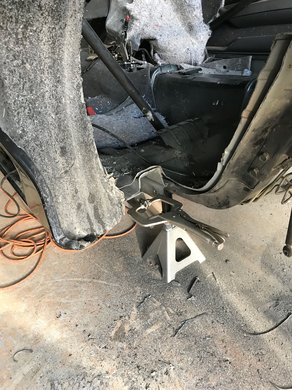

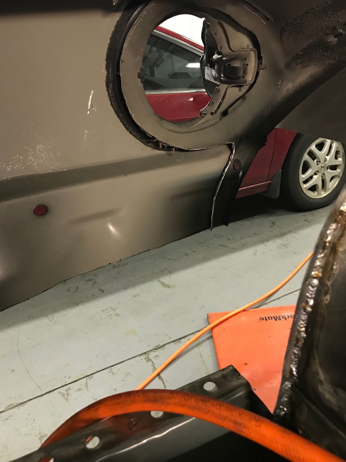

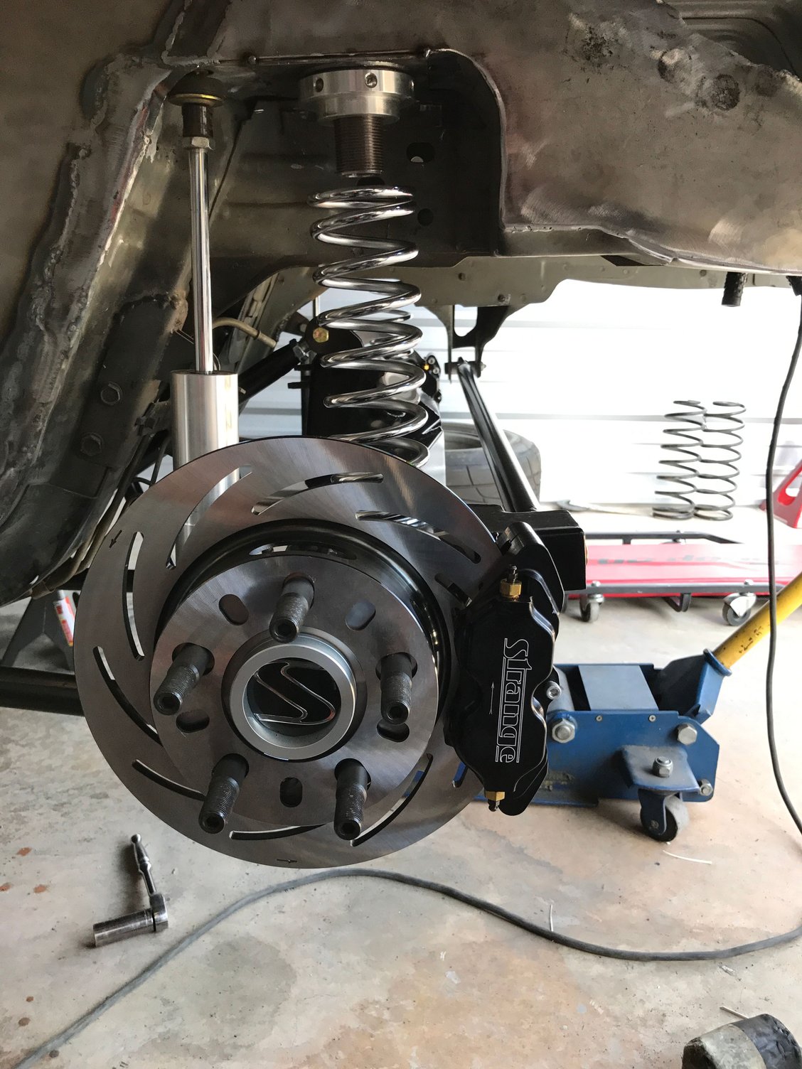

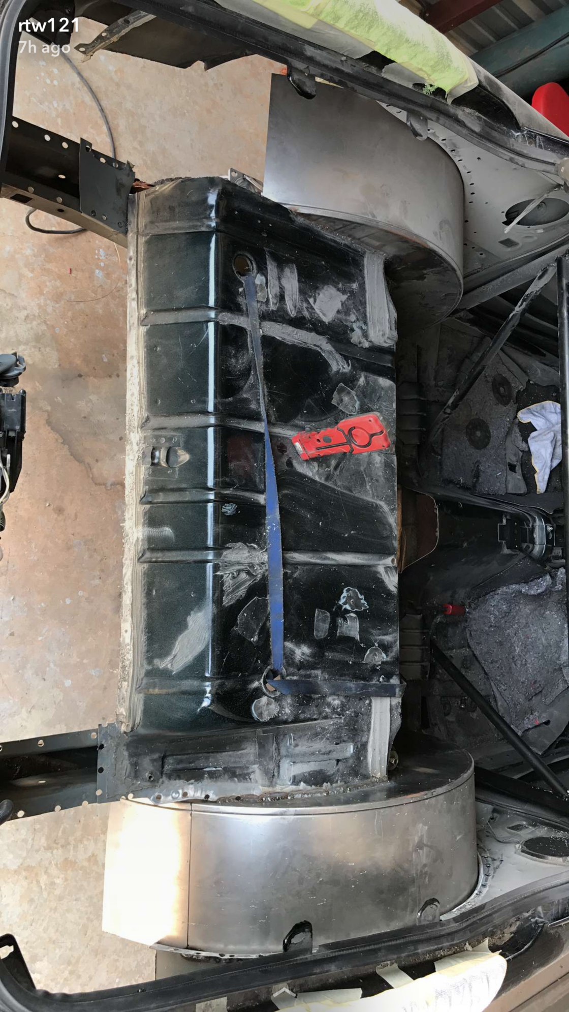

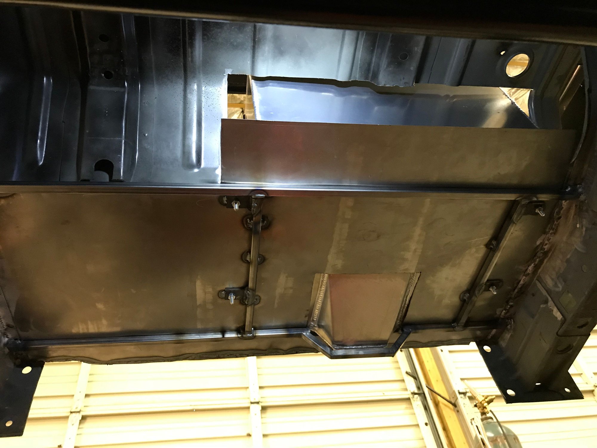

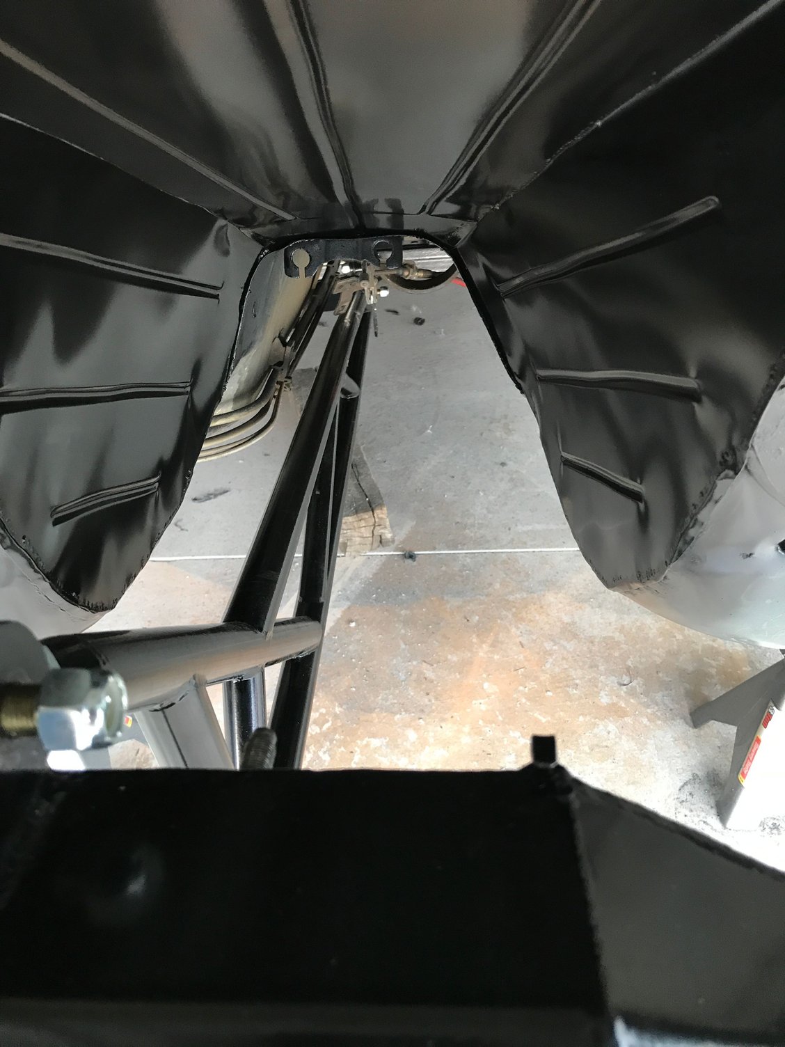

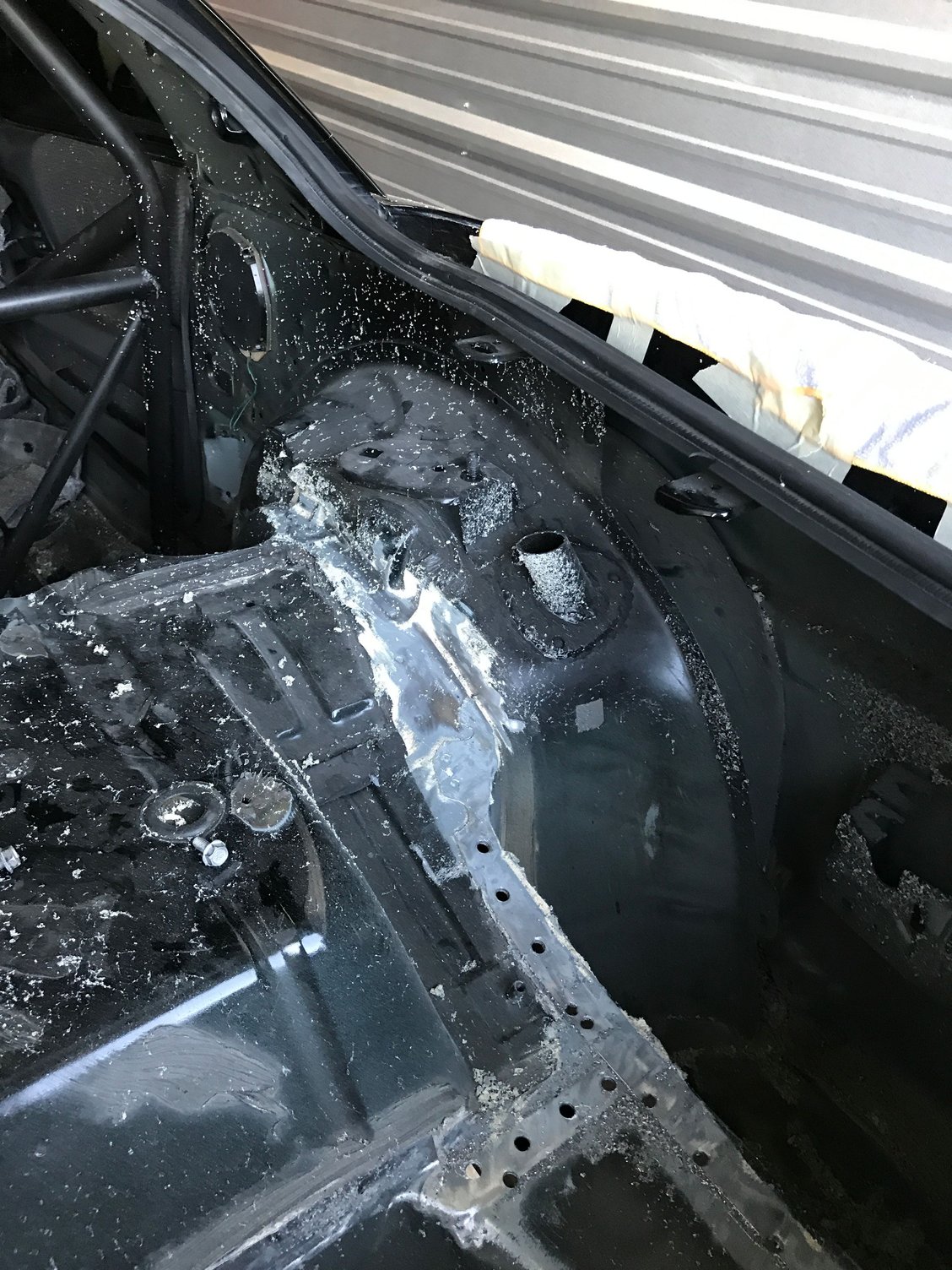

Lots of work on my free time 😳😂 sorry for pics not in order

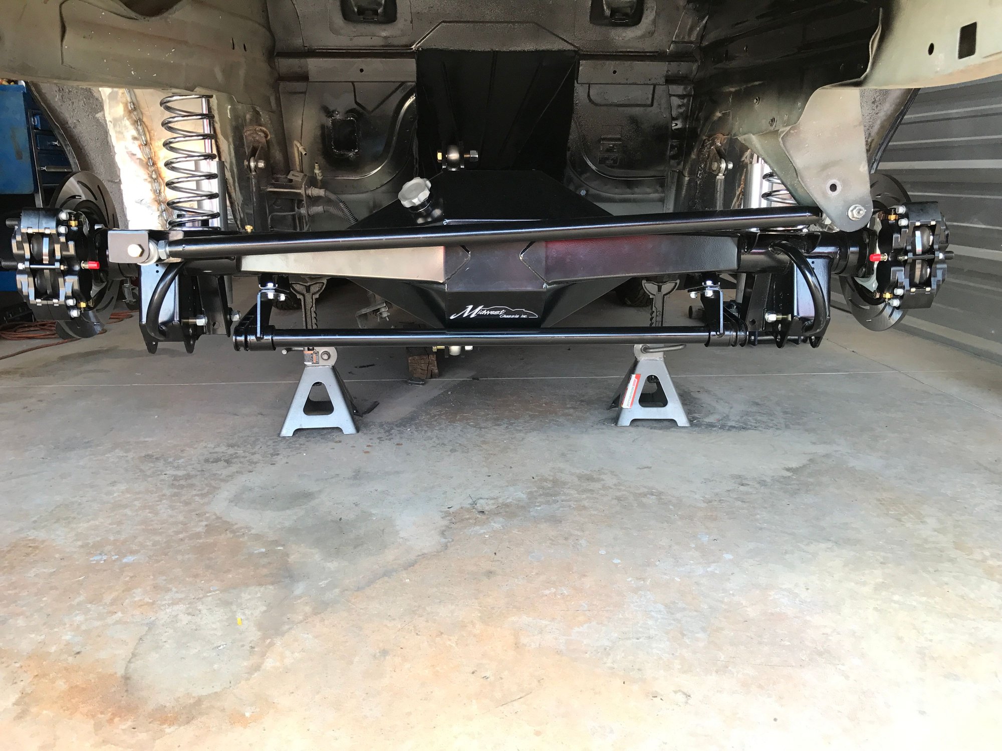

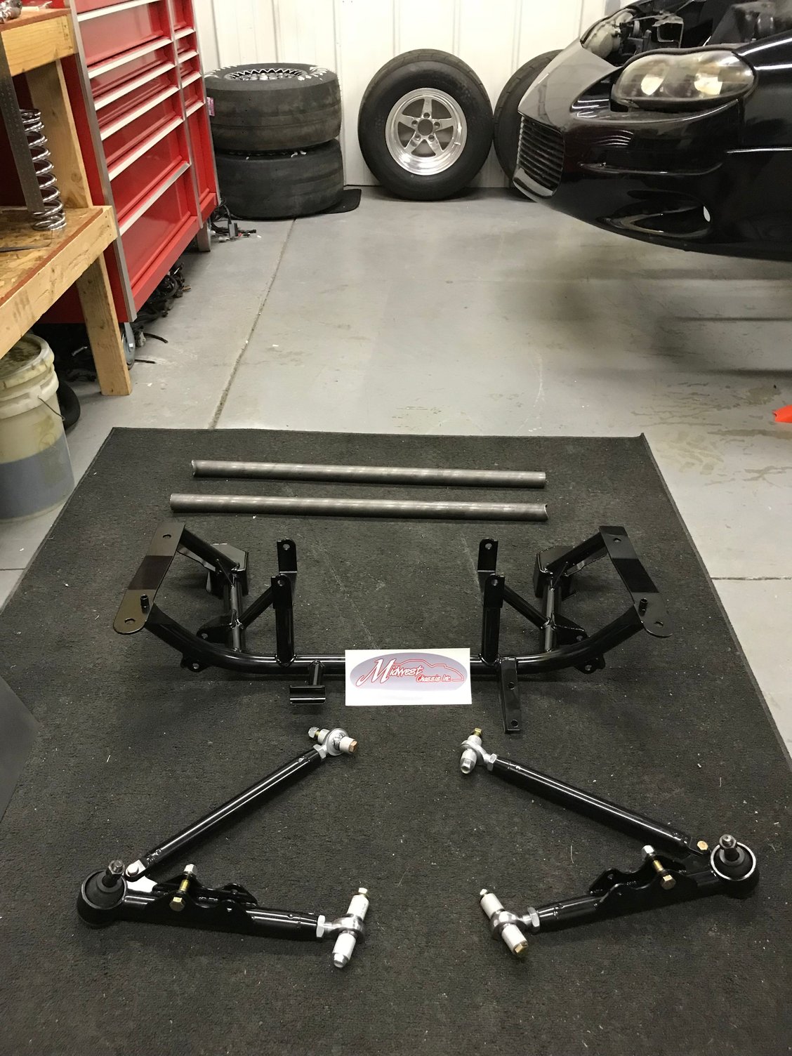

You have been very busy. I have a few boxes from MWC sitting in my garage that I need to install and many more I need to order from them. What shocks are you going with? I will probably get the Viking coilovers. is there a certain class you are building to run in?

Bunch of questions

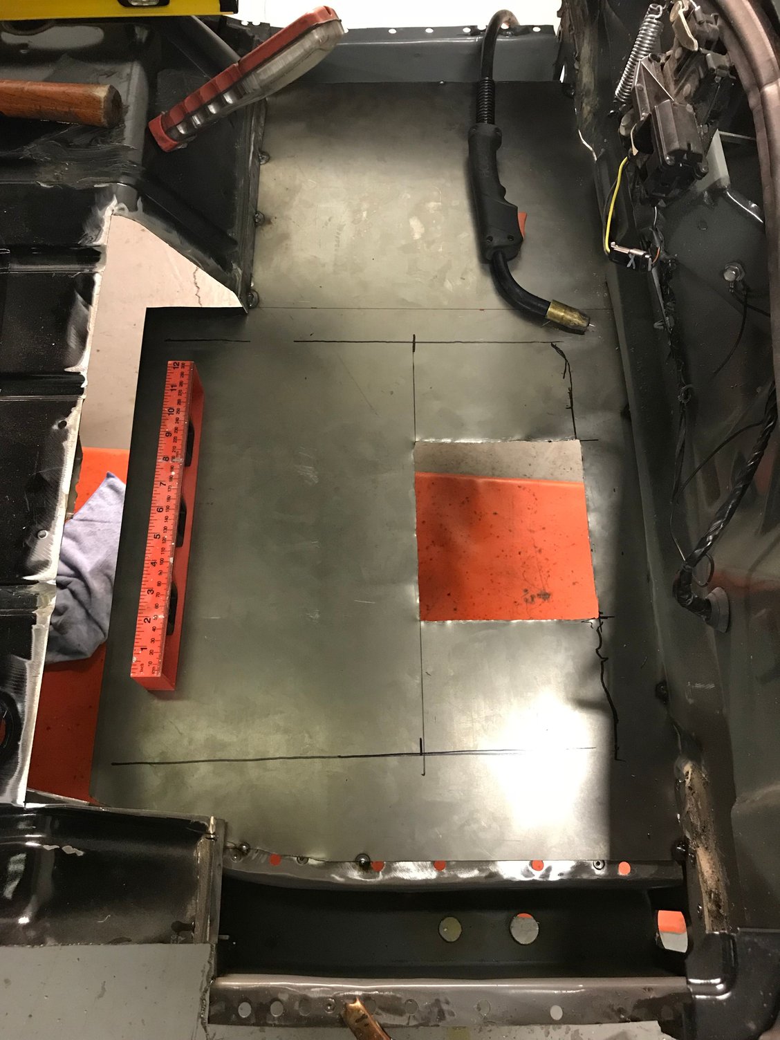

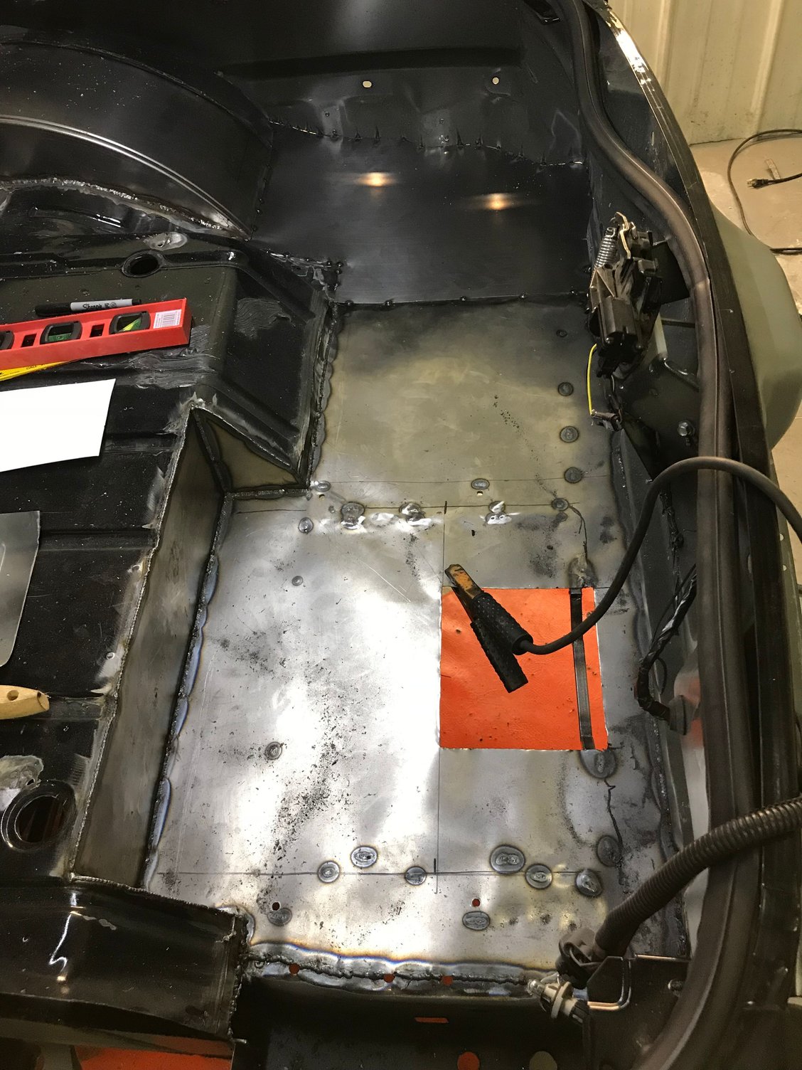

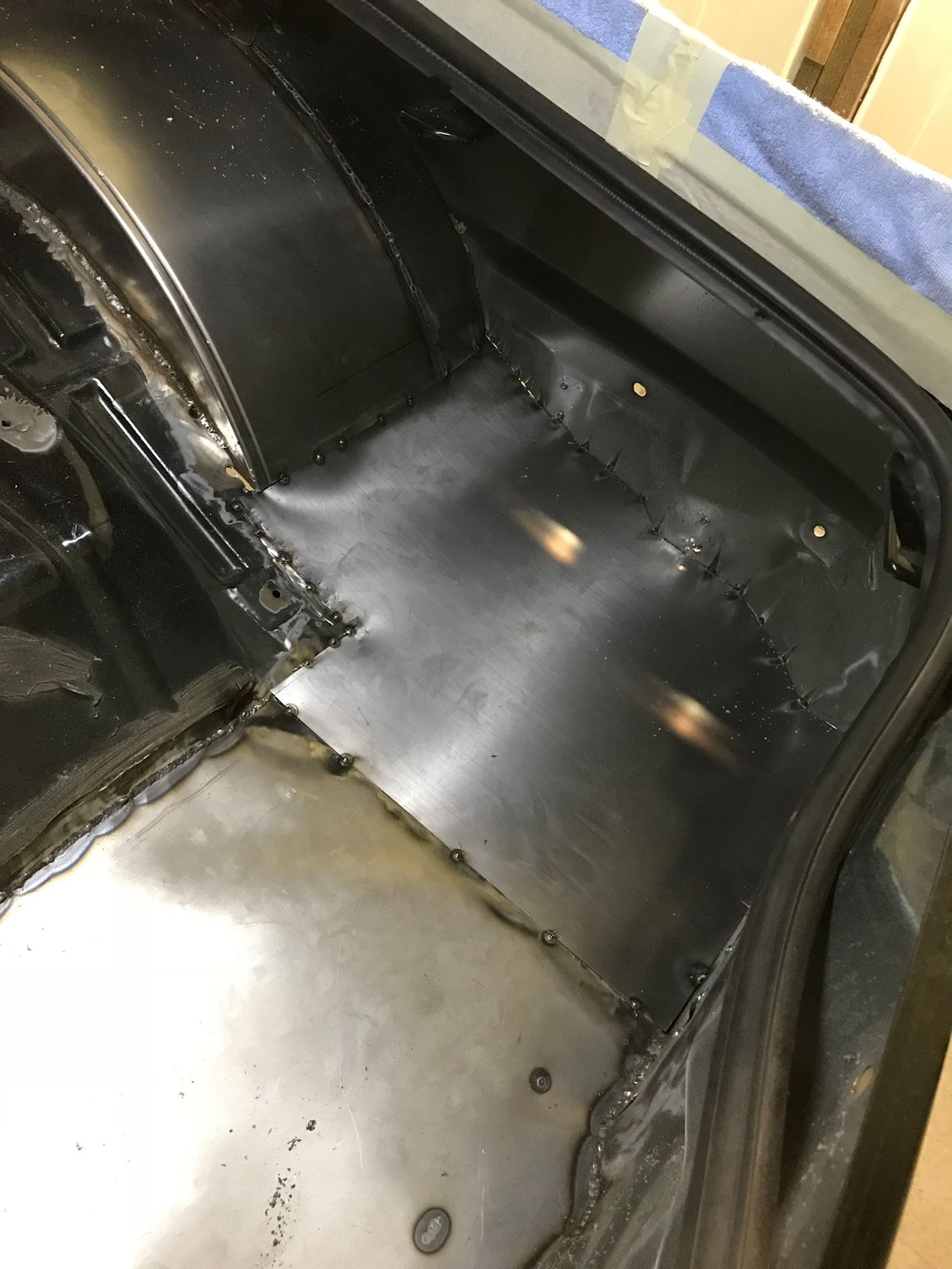

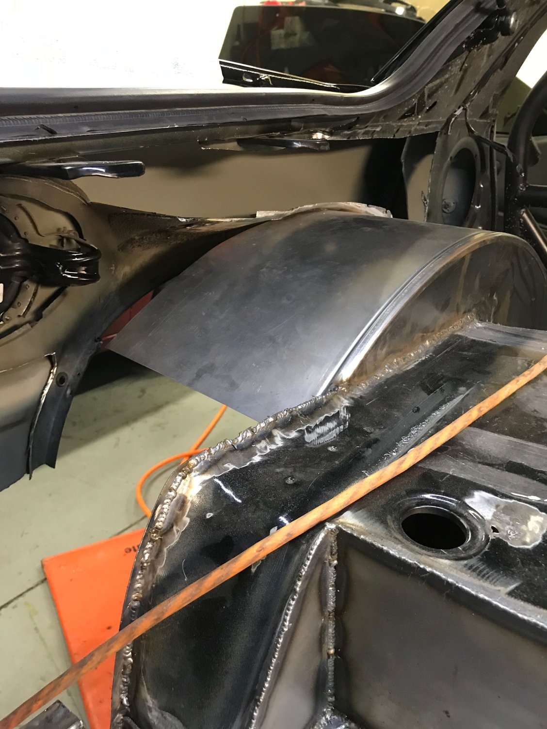

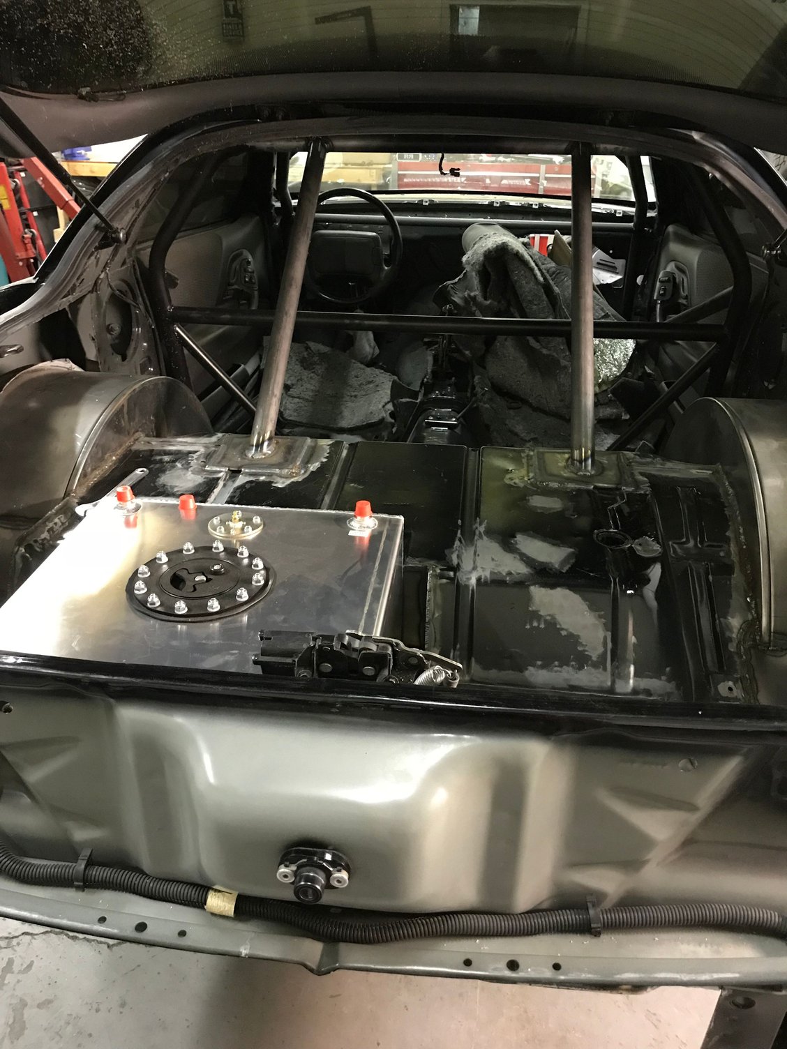

What mini tub kit are you using?
What roll bar kit are you using?

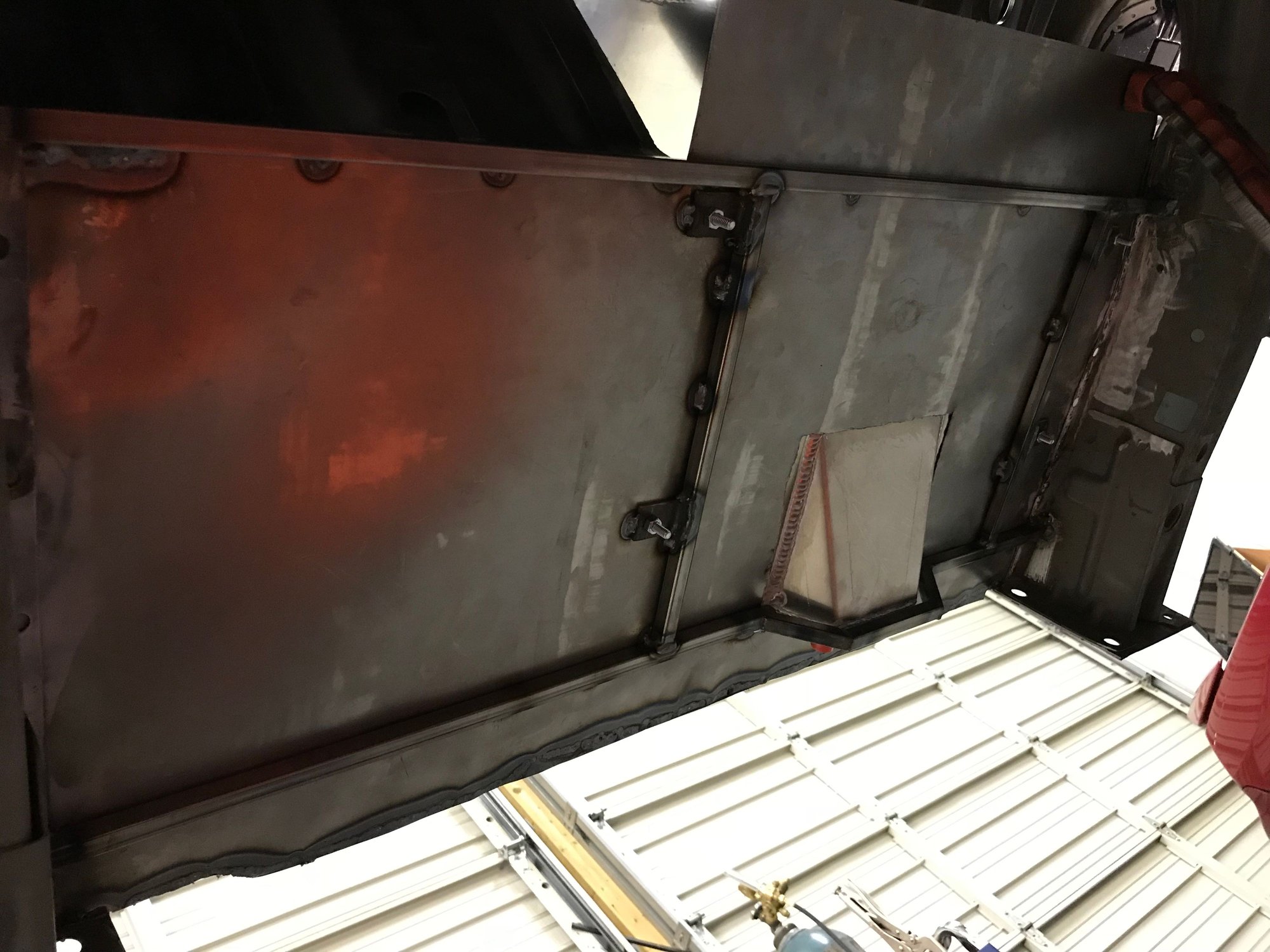

What guage metal did you use in trunk area?
How many gallon and specs on fuel cell?

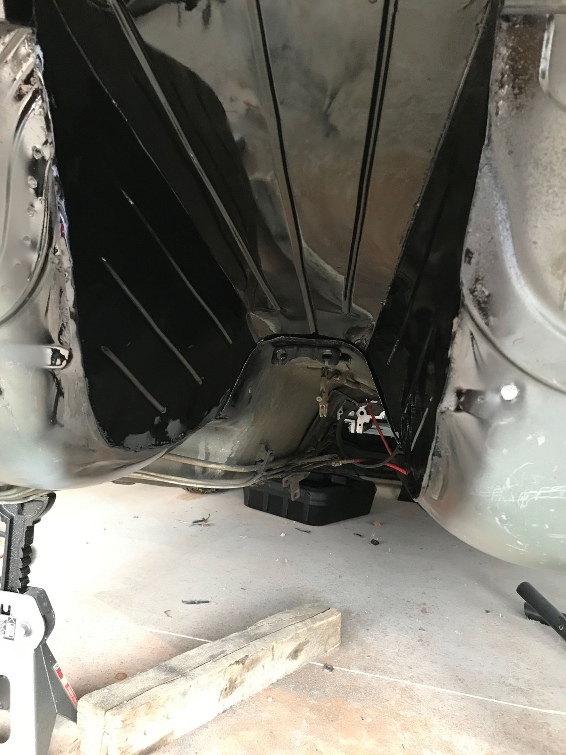

Originally Posted by 121
How much is this rearend narrowed from stock length and what width and backspace is this rear wheel?

Originally Posted by zmracing
Nice work!
Running viking double adjustable in the rear. And coil over up front. I have not decided what class I’ll run. Just building this for a little fun at the moment lol
Old Nov 26, 2017 | 10:13 PM
121's Avatar
121
Joined: Mar 2011
Posts: 356
From: Wyo
Originally Posted by fastlt1
Bunch of questions
Wolfe mini tub kit
Mwc mild steel
22 gauge metal
10 gallon I think it’s 17x17x9
Old Nov 26, 2017 | 10:14 PM
121's Avatar
121
Joined: Mar 2011
Posts: 356
From: Wyo
-3 per side
15x10 5.5 bs

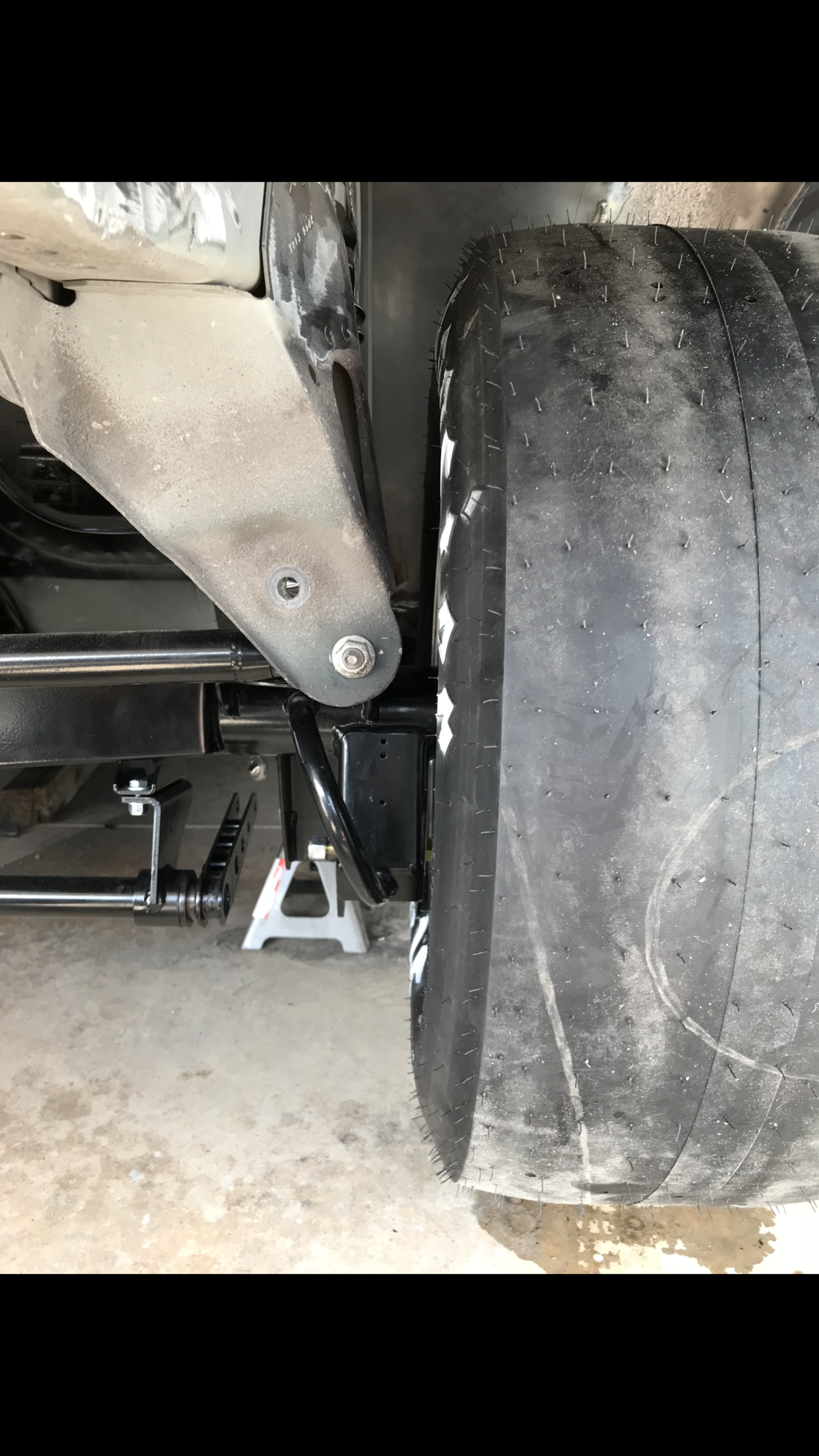

What size tire and what are you doing for lca clearance
28x10.5x15 they clear the lca.

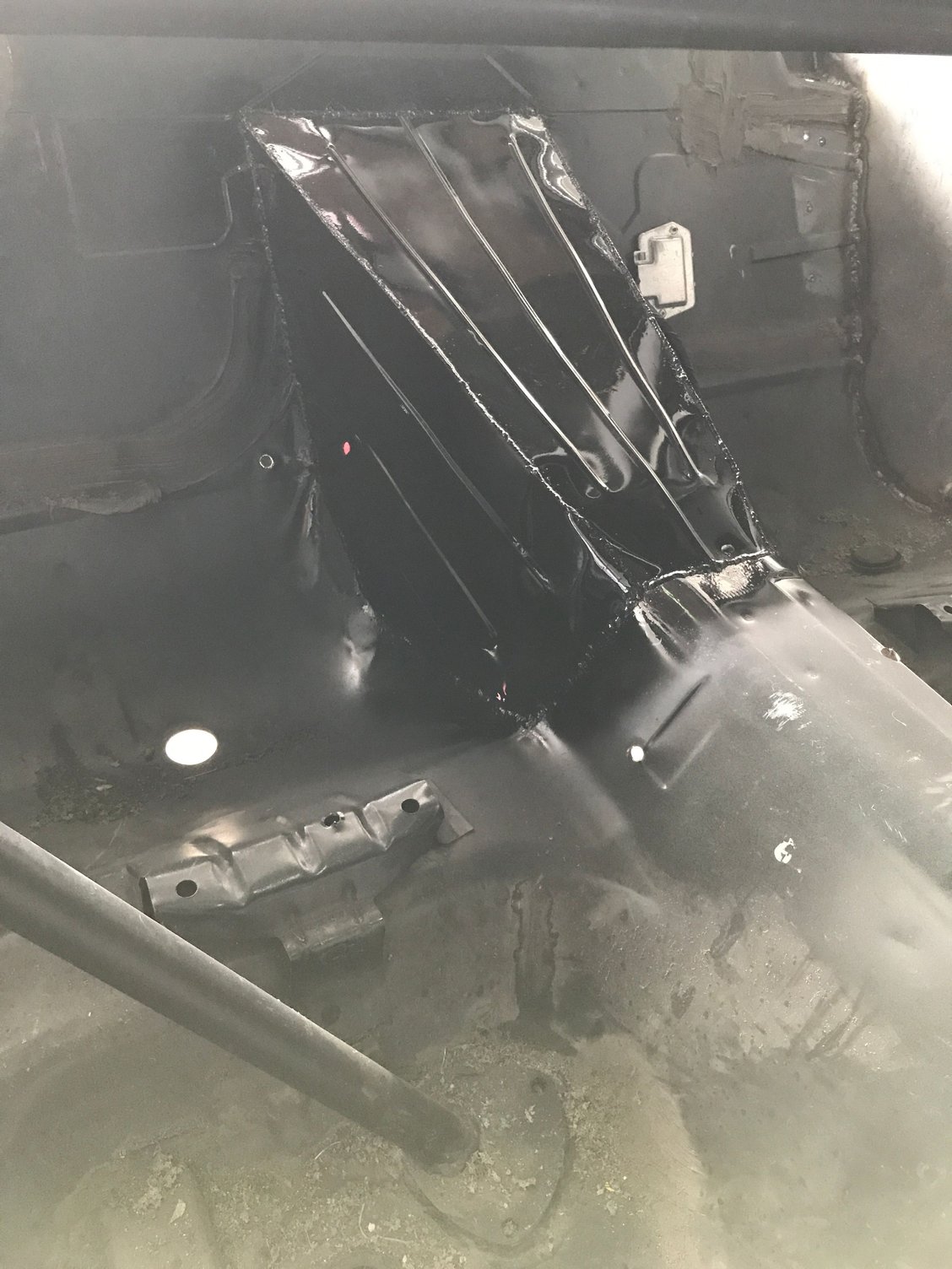

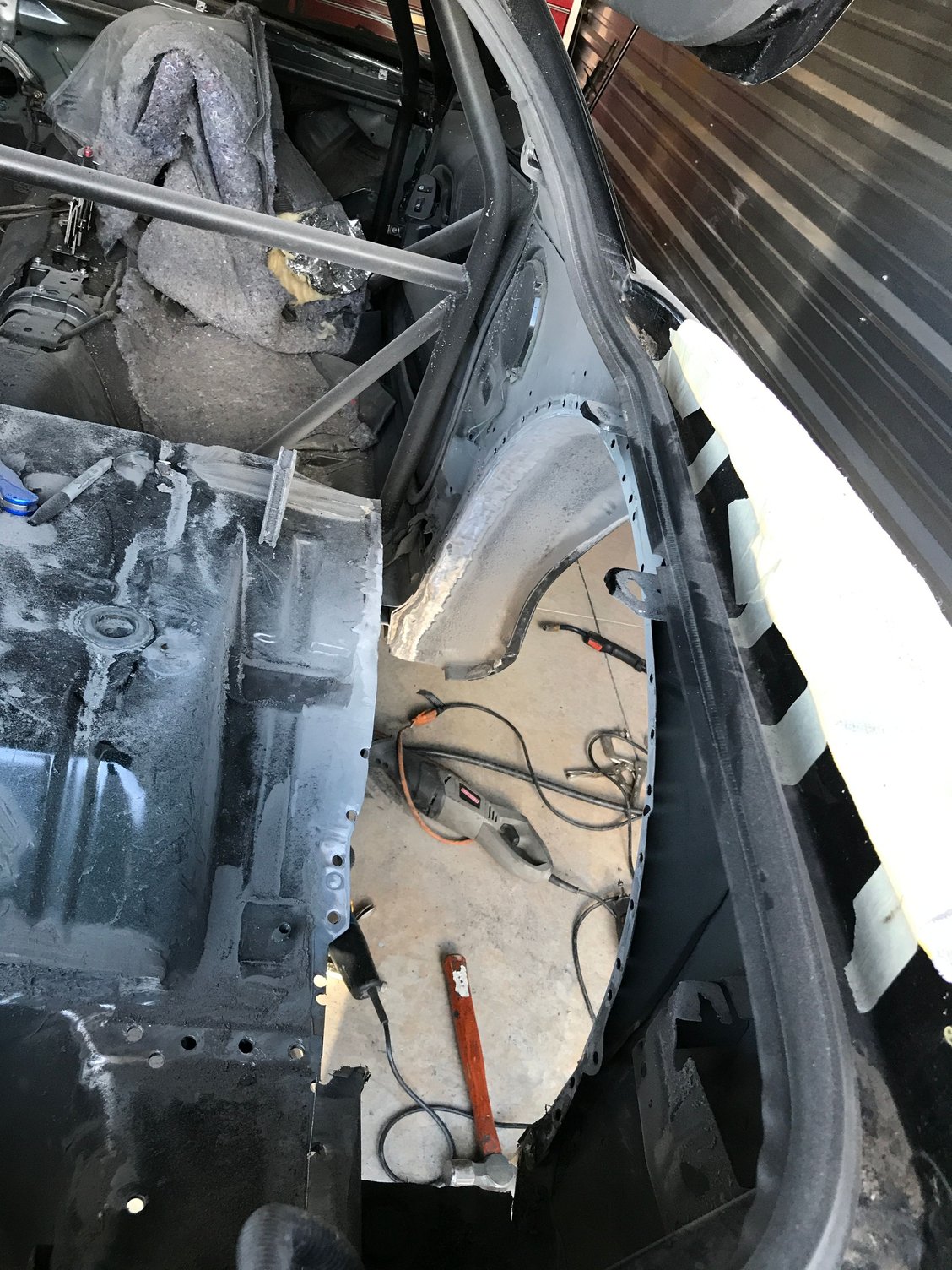

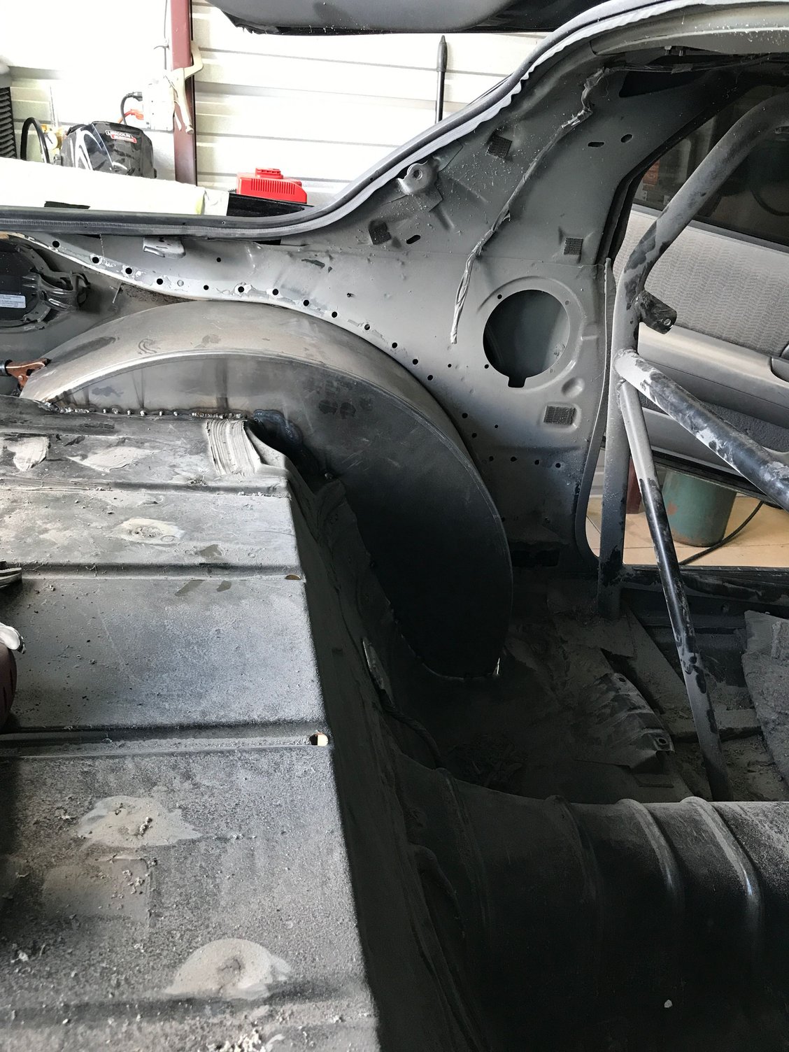

Nice work to date. Wondering if your planning on running the interior panels in the rear over those? What’s your plans on that?

why did you decide to keep the rear springs in the stock location vs using a coil over like people normally do?
My plan is to run the plastic over the tubs
So I can slam it how I want and measure for a shock

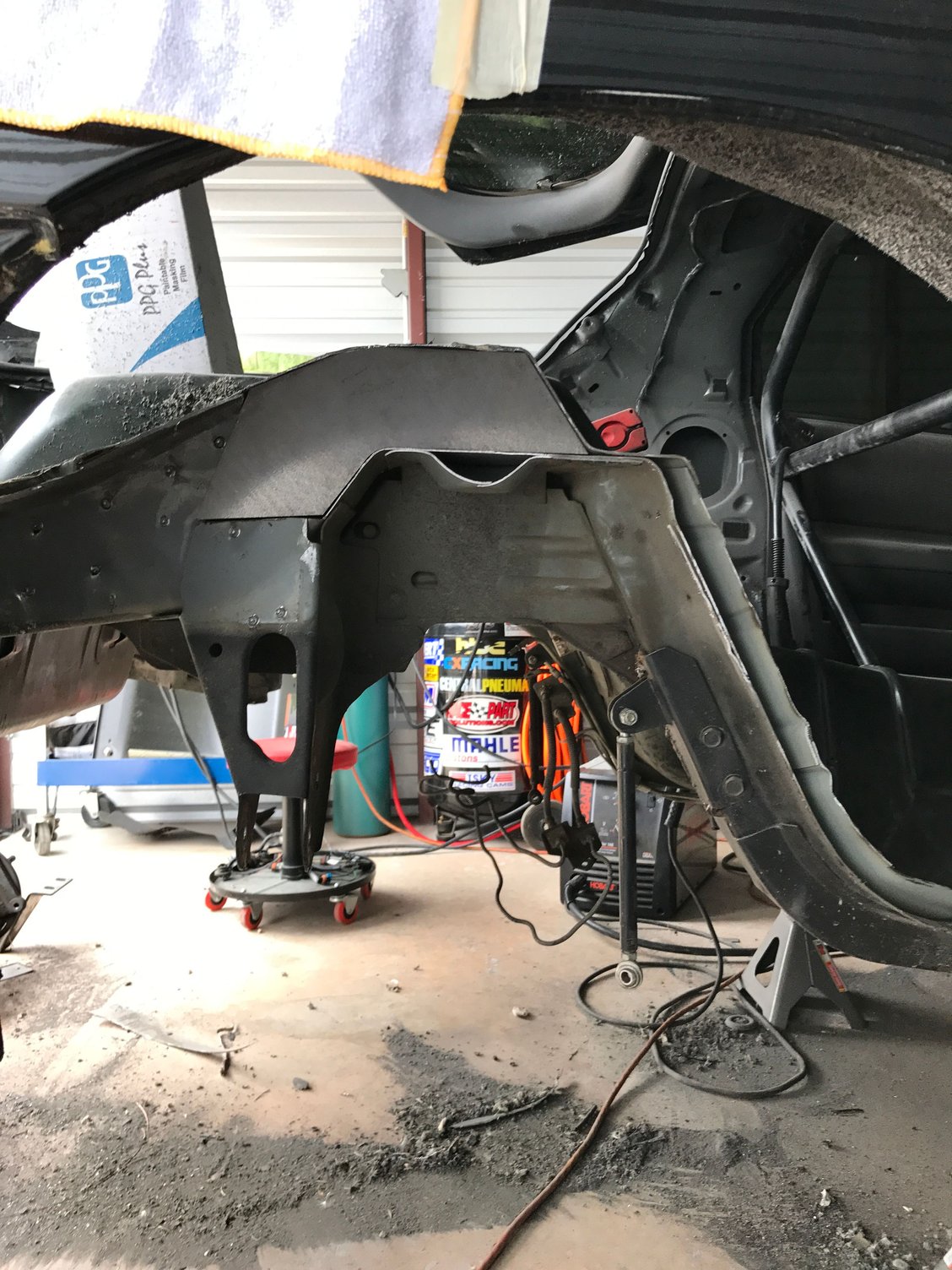

Did you keep track of all the metal you cut out of the rear? Weight wise?
I did not. But it was a lot!
