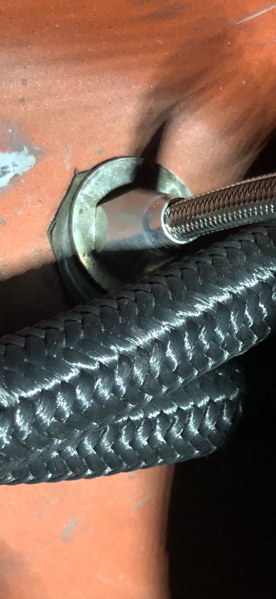

Hey guys, I've seen a lot of conflicting or maybe old information around installing a new TB Cable after removing TCS/Cruise. I purchased the TC-1000LS1 36" cable and had absolutely no issues other than using 2 washers for the firewall. If you have 2 people this shouldn't take you but 20-30 minutes. I've seen multiple people ask how to connect it to the stock pedal. (pic included) In this case i simply used the black retaining clip and left the TB cable alone. No modification to the cable was necessary. On throttle side I have a FAST LS3 102 intake and a NW 102TB. I've seen people say this didn't fit and I personally had no issue at all. I didn't even have to trim the existing cable. I did purchase the fancy billet adapter and wasn't able to get that to work with the FAST due to things not lining up properly. I think with a little work I can get that to work too.

added the firewall washer pic as well.
