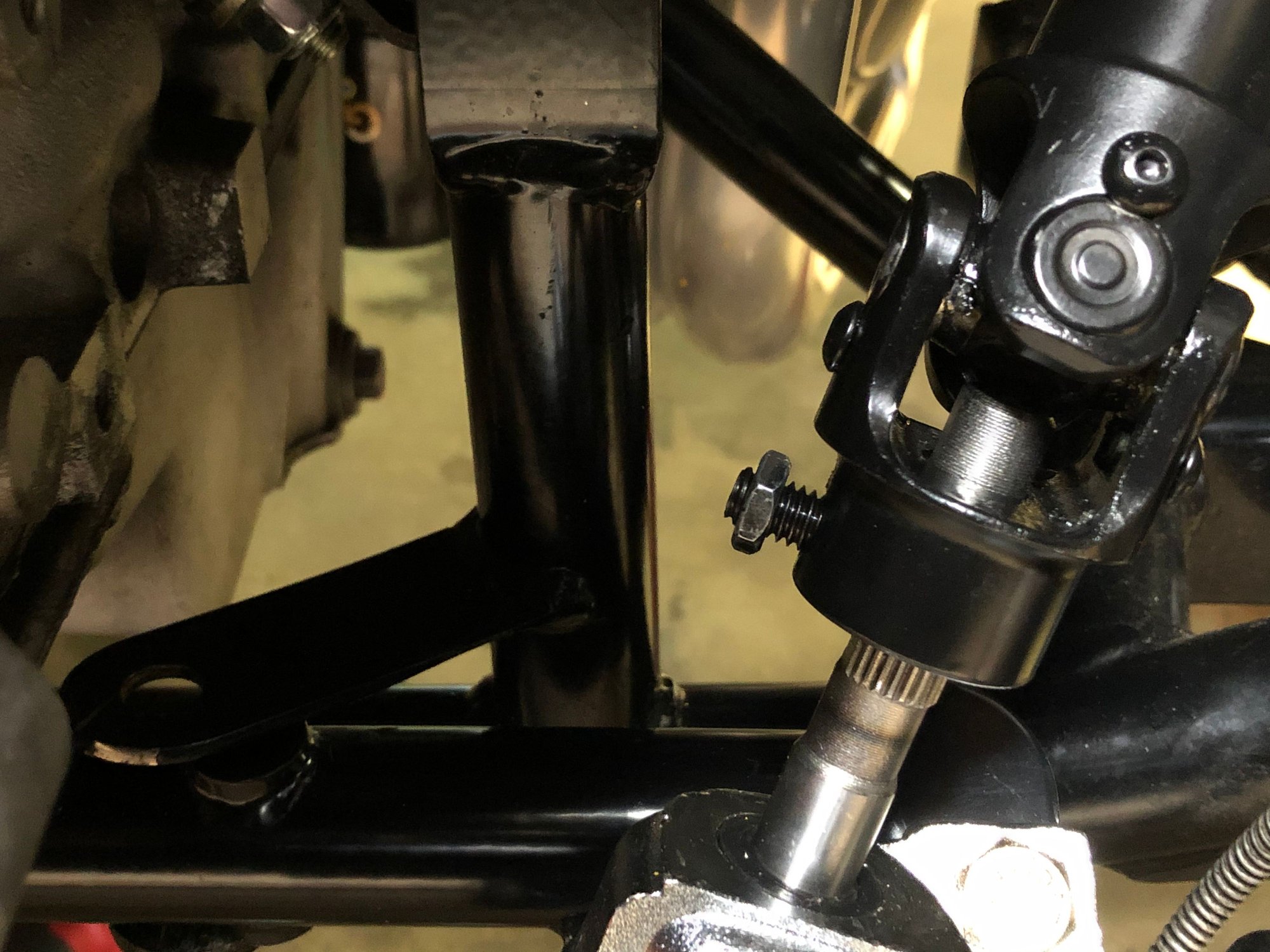

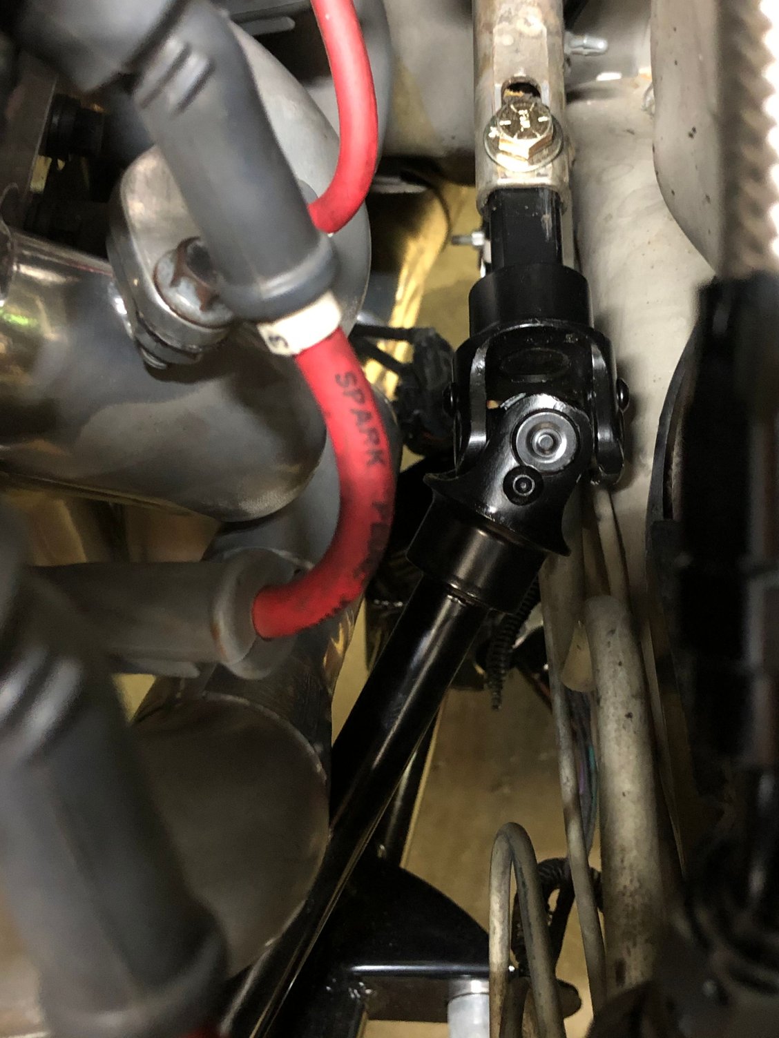

Has anyone installed or tried to install a MWC manual steering kit? I am having a huge clearance issue with the shaft hitting my headers (1 7/8 kooks, stepped to a 2in but the step is after where the shaft is hitting). The shaft hitting the headers is making the rack adaptor a full hole off. Anyone have this issue?

Kooks don't clear their manual rack. I had some 2" and they wouldn't clear
Bought ARH they clear fine as they are a diff design
You have 3 options
Dent the header in and run it
Buy new headers
Add a 3rd elbow for the steering shaft and rig something up to make what you have work
I vote put a small dent in the header as it will have no performance loss at all

Yeah it's the design of the kooks primaries, I had the same problem. I was running the same setup. I had ARH 1 7/8 on my car and they fit perfect with room to spare
Mocked up the kooks 2" and they aren't going to work, the primary flares out too much for me
I researched you could add a 3rd knuckle connector that will redirect the angle, I wanted a simple solution so I stuck with ARH and sold the kooks

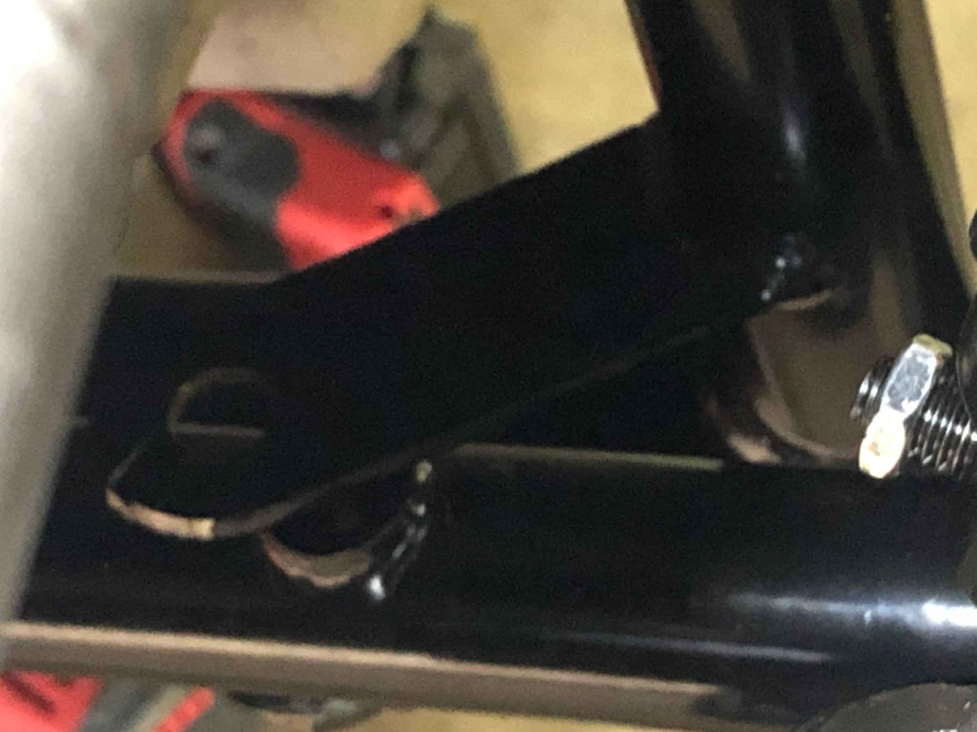

I think that steering joint can go up higher on the rack input shaft. Doing so would let the rack shift to the right. Now the header tube, sometimes you gotta do what you gotta do.

That slot is only for install purposes, the bottom is bolted to the rack and is fixed. No adjustment on it

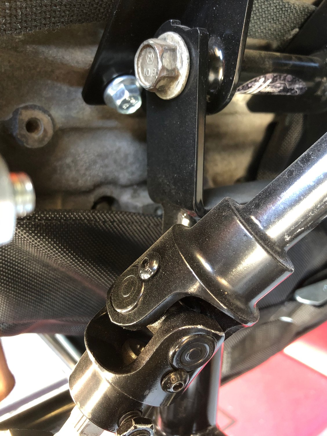

Best pic I could get. It’s actually flush with the bottom of the joint. This is not their bolt on kit but you get the idea.

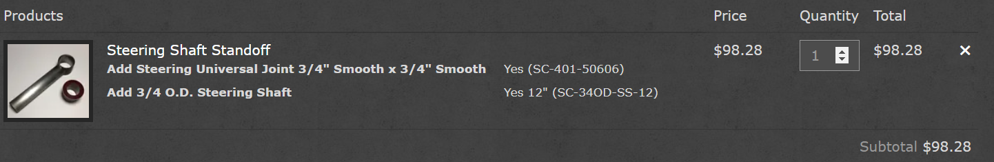

You are using our straight rack bracket adapter which is not the same as using a stock steering shaft onto a stock rack K-member. This version has the shortest steering shaft we offer but allows the best chance of no wheel to tie rod interference when using a factory width wheel. Our bent version rack bracket adapter may give a little more room as it moves the rack almost two inches further forward when using K-member designed for a power rack but swapping to a manual rack.
However we have sold racks and steering shaft combos with Kook headers we can only assume their tubes sit in the exact same location every time as our steering components can not be relocated. Unfortunately this is not the case for any header manufacturer.
A third joint may be the only option and not very uncommon. Here is our stand off with a second joint and extra 3/4 shaft.

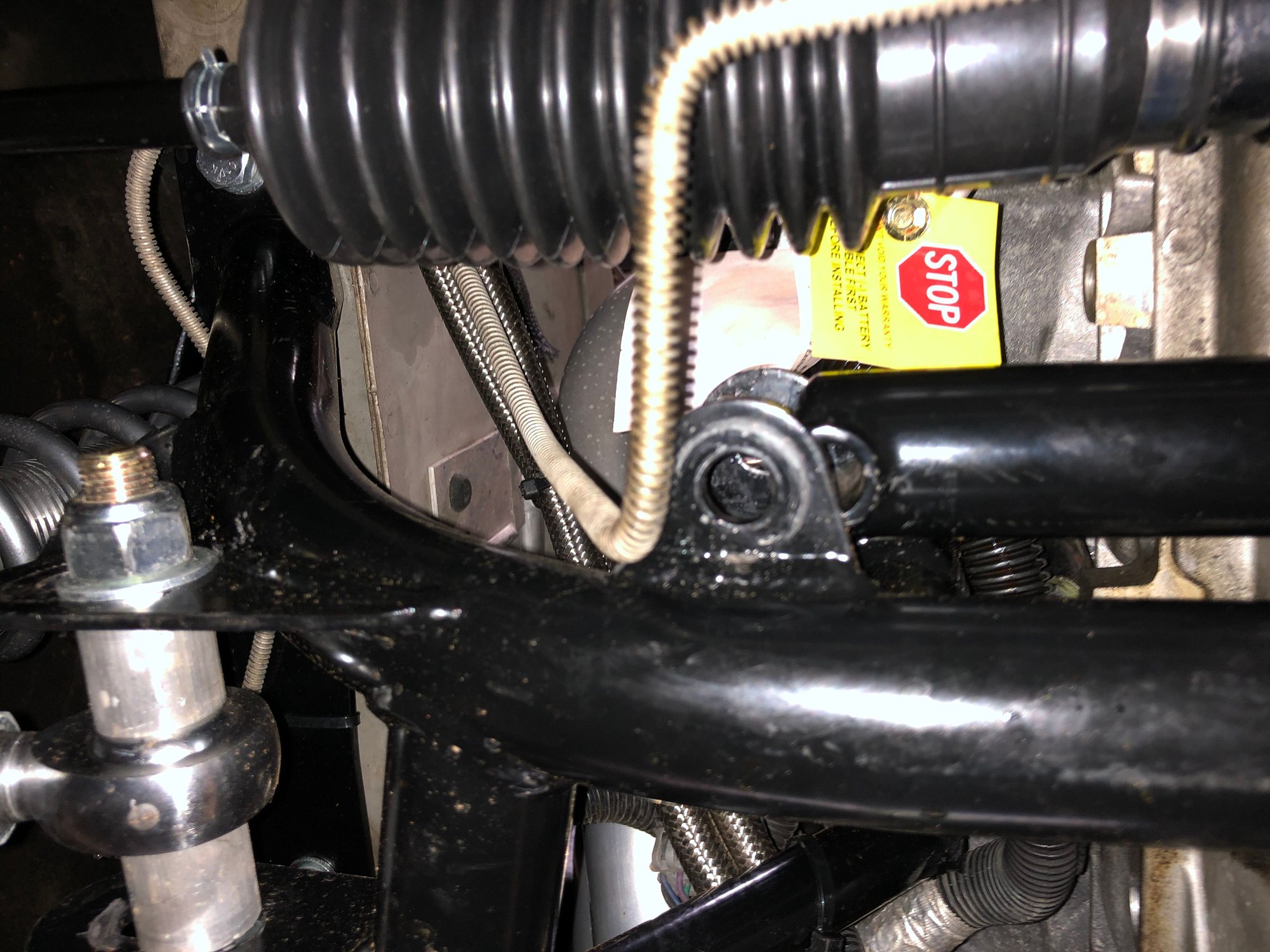

i emailed your guys and actually purchased a new joint and some double D rod thinking I am going to have to remake the shaft, but from that suggestion I ordered the wrong thing. I included a picture of the kit that I received as well.

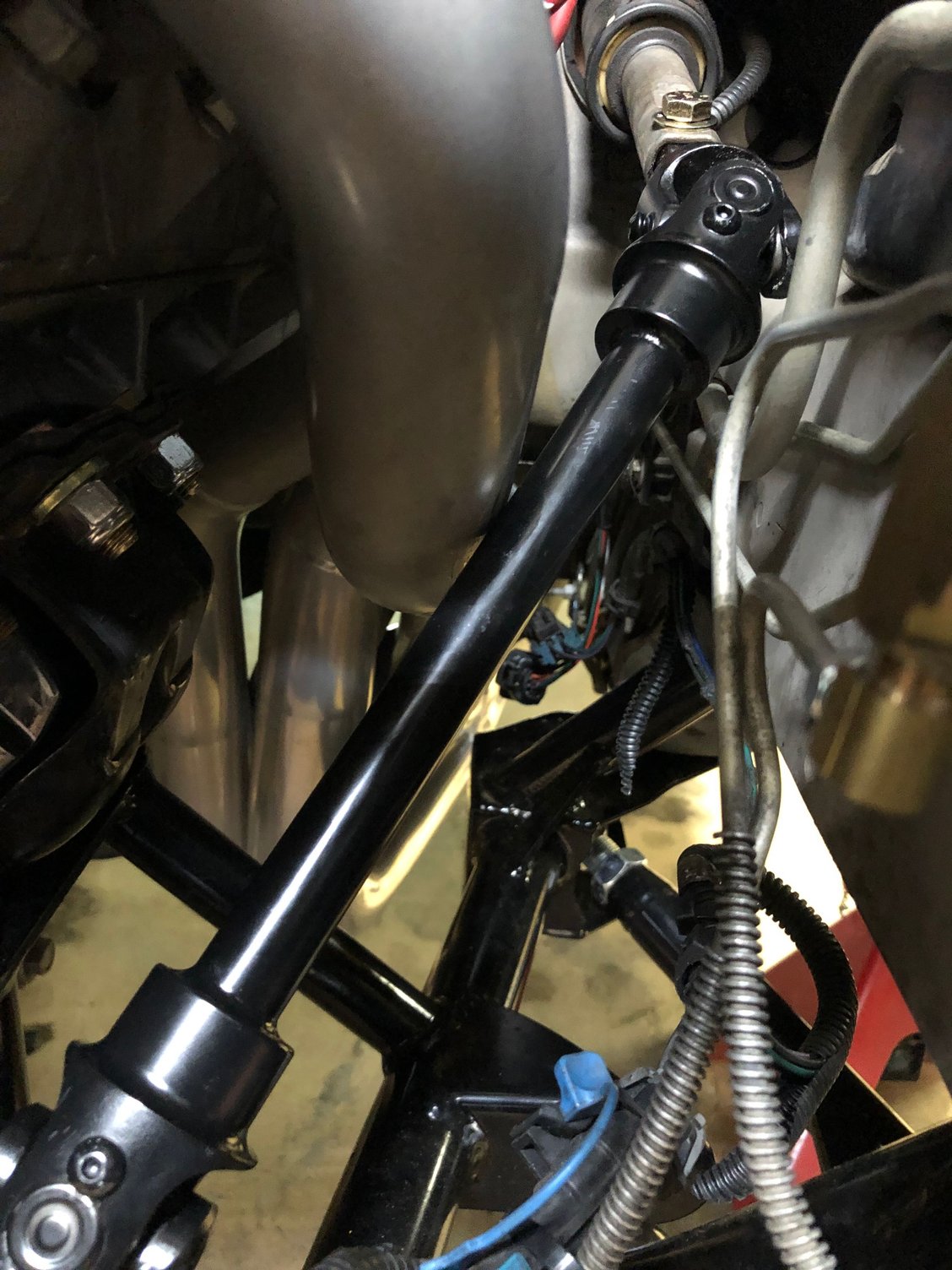

I got my DD shaft and a new joint from MWC yesterday and got to work today on it. Got it to work. I added length to the DD bar coming out of the column and shortened the bar coming up from the rack. Basically cut the top u-joint off the shaft that comes in the cut and trimmed down enough to get the new u joint to clear and then used the new DD and trimmed it till everything lined up. I have clearance on the header now and clearance on stock fuel feed line as I am not too worried about that due to running new lines here soon. If Eric and the guys at MWC are interested in measurements I could provide it for them. My only suggestion for them as I’m not upset it didn’t work is to send a steering shaft “kit” instead of one already put together for a customer with Kooks headers. With the kit I could of made one from scratch for the same price instead of adding an extra $74 on top of the kits price. Again I’m not upset and understand once modifying a car things do not always match up and the front of my car has basically nothing stock about it.

Good job man. I knew it would be an easy fix for you. No need to get rid of the best headers on the market. You are so right, that is all they have to do. Very simple.

Just so everyone knows that I forgot to mention. When you build your own steering shaft or modify one. It is imperative that you make sure the yokes are perfectly in phase or it will bind when it is turned. Just like a driveshaft.
