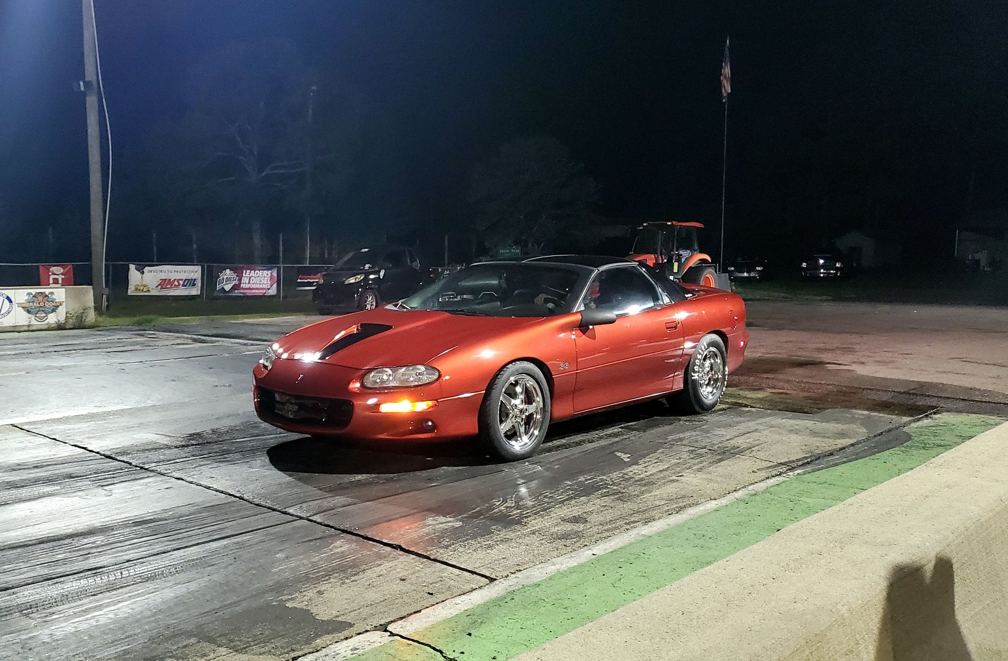

Welp, I got the car out on the 1/8 mile. 1st passed went amazingly. 3100rpm launch, 15psi tires, dropped the clutch, tires chirped and off I went with minimal rpm drop. Get to the booth and the timing system was down......
Next pass; didnt make any adjustments, dead hooked then bogged off the line. 2.0 60 ft, 8.3s at 89mph.
Third pass; didnt make any adjustments, dead hooked then bogged and about the same times.
I kind of expected the bog. Next step is to try around 17psi on the tires. If that doesnt fix, looking to up to around 3500rpm.
Anything else from the professionals out there?
