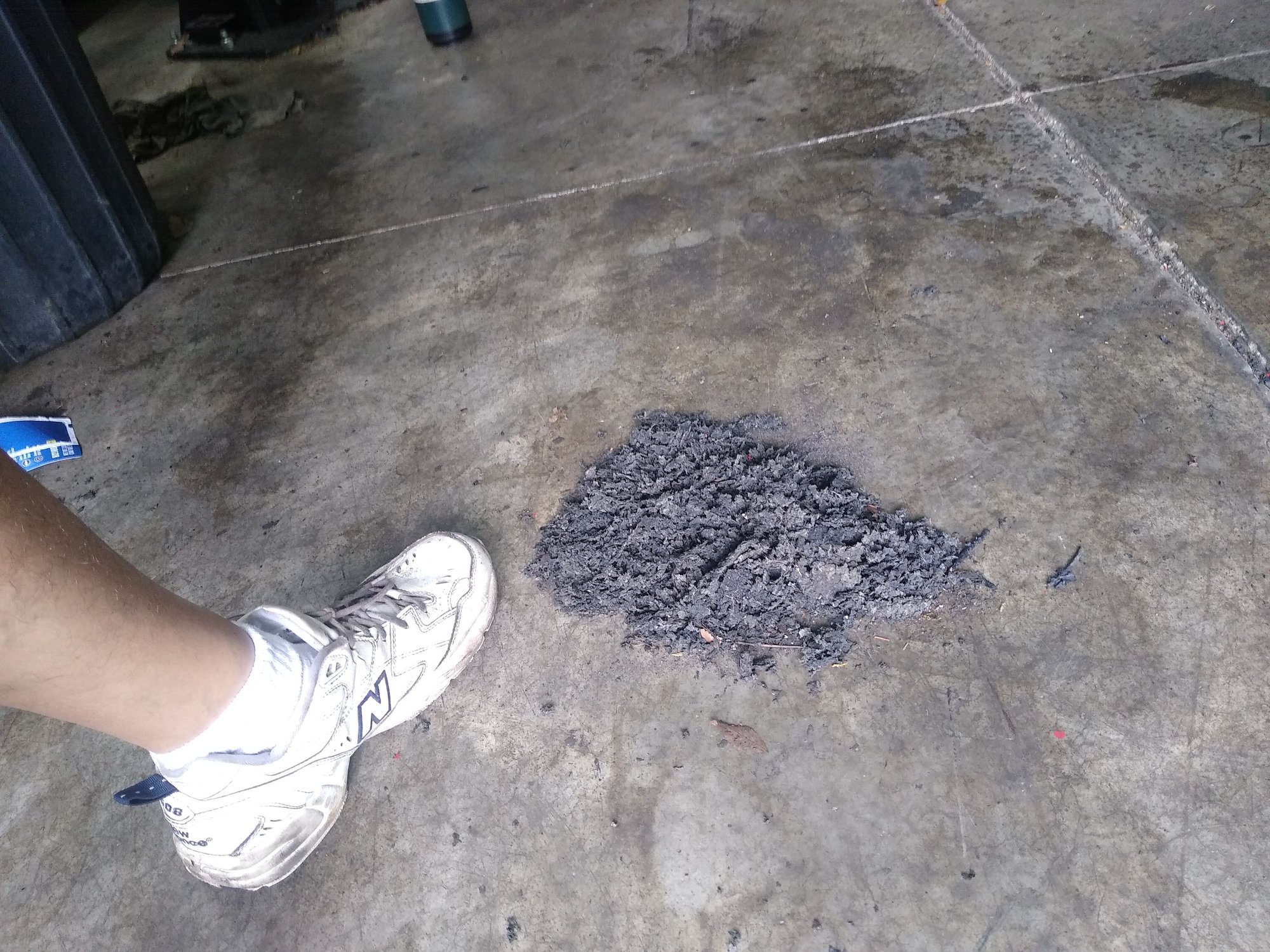

Forgot to weigh this, rubber just from under the driver's side. 😂

You know he isn't playing when he breaks out the white New balances
