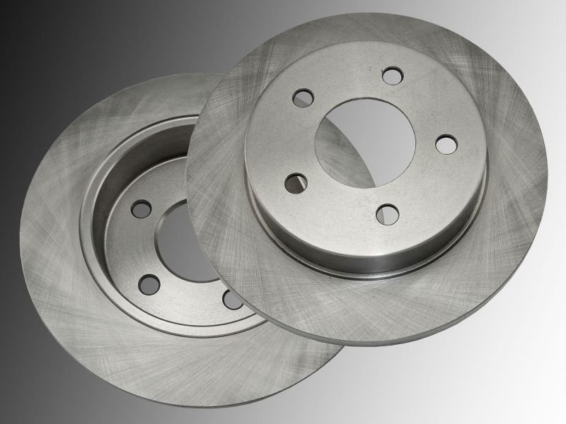

Just so we're clear the lt1 rear rotors are only very light like i said when they are the factory OE rotor. For some reason all the aftermarket ones are heavier because the center piece where the studs are is a lot thicker. It looks like GM made them how they did to be light on purpose, and nobody has copied the design over probably because they can't do what GM did and they'd be too weak if they ran a thin stamped center like the factory GM lt1 rotors are.
. You need to find factory original rear rotors if you want them real light. And if you do find some and you compare them to an aftermarket rotor both visually and on a scale, you will then understand what i'm saying.

I did a quick search for you. I'm fairly sure these are oe factory rotors below just going from memory how mine look on my car. Look at the center of it how it looks like a stamped or forged piece and has a curved edge and it is very thin material once you see one in person, unlike most rotors which the center piece is a lot thicker material. It's a unique design for a brake rotor and it makes them very light.
Another oe rotor i found on ebay from a 96 4th gen... ( the ones above may be from a 3rd gen but they look very similar )
These are aftermarket rotors.... you can tell the difference between the oe rotors and aftermarket from the corner of the center piece being just squared off versus rounded off above

I should get them this week, snowed here over the weekend so it will be a few days. Thanks for the pictures. I've looked hard to find some old factory ones and that's what I supposed to be getting from a guy local to me .
