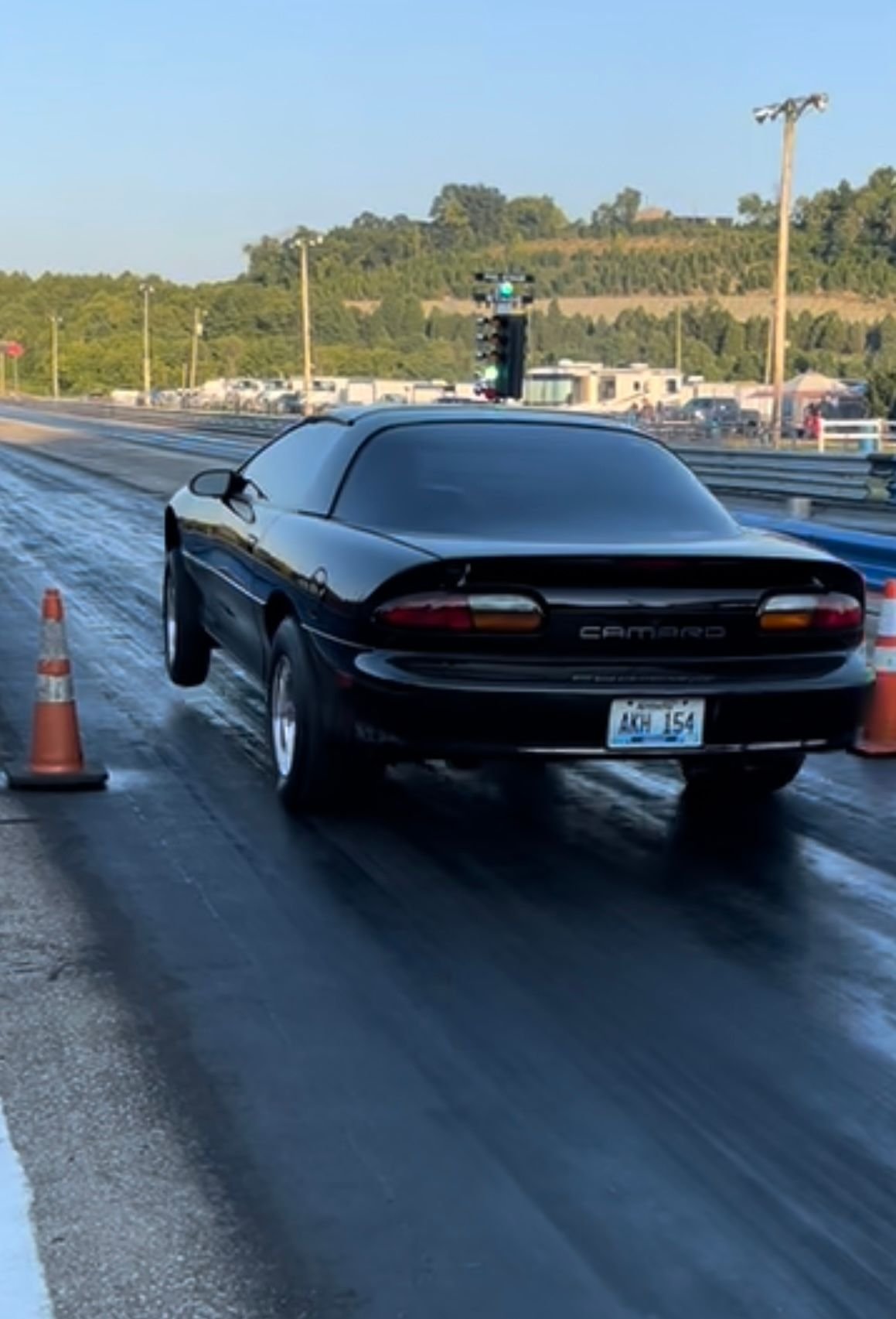

Needing some advice on which way to go with these shocks and other things possibly. I took the car to the track yesterday and had two good passes but it was like the car would hook, then spin for a split second and grab again. It still had a 1.488 and 1.536 60ft on the best passes.
Running mickey thompson at 15 psi and the shock setting was: 16C and 4R on the front, 16C and 0 or 2R on the rear. I experimented on the next pass and upped the Rebound on the rear to 6 and spun worse. I'm probably way off on the settings.
I dont have any video from out of the car but have some from inside. Thanks for any help/advice.

Ok, So I ran four times yesterday and the times in order were....
1st pass
60ft - 1.460
330ft - 4.509
1/8th - 7.05@96.75
2nd pass
60ft - 1.423
330ft - 4.452
1/8th - 6.99@95.95
3rd pass
60ft - 1.488
330ft - 4.524
1/8th - 7.06@95.40
4th pass
60ft - 1.441
330ft - 4.453
1/8th - 6.98@97.11
Now for the changes I was running a new 275/60 M/T pro at 17psi. Shock settings on every pass was 15c/4r on the front and 15c/10r rear.
The best 60ft was flashing off idle and the worst was when I stalled up to 1800rpm. I believe it hit the tire a little harder but hooked and spun for just a split second before grabbing again.
Car went straight and pulled the tires

Video from the other day.
Looks like I have an alignment or bump steer issue? Is it possible my steering wheel turned a little on the launch? I definitely felt that in the steering wheel.

Added an updated video to the first post.. For any one interested or looking for info on settings... From zero, Front 18C and 15R, Rear 16C and 9R. The drag radials were set to 20 psi cold.
The car is fairly consistent on a decent track. Usually 60's 1.42 to 1.47.
