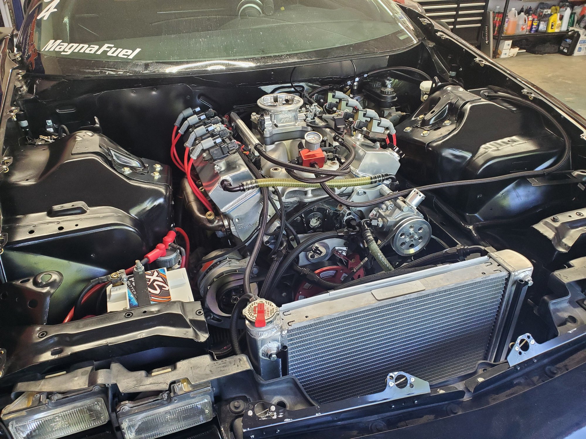

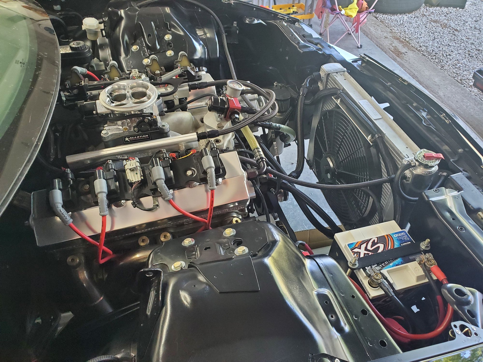

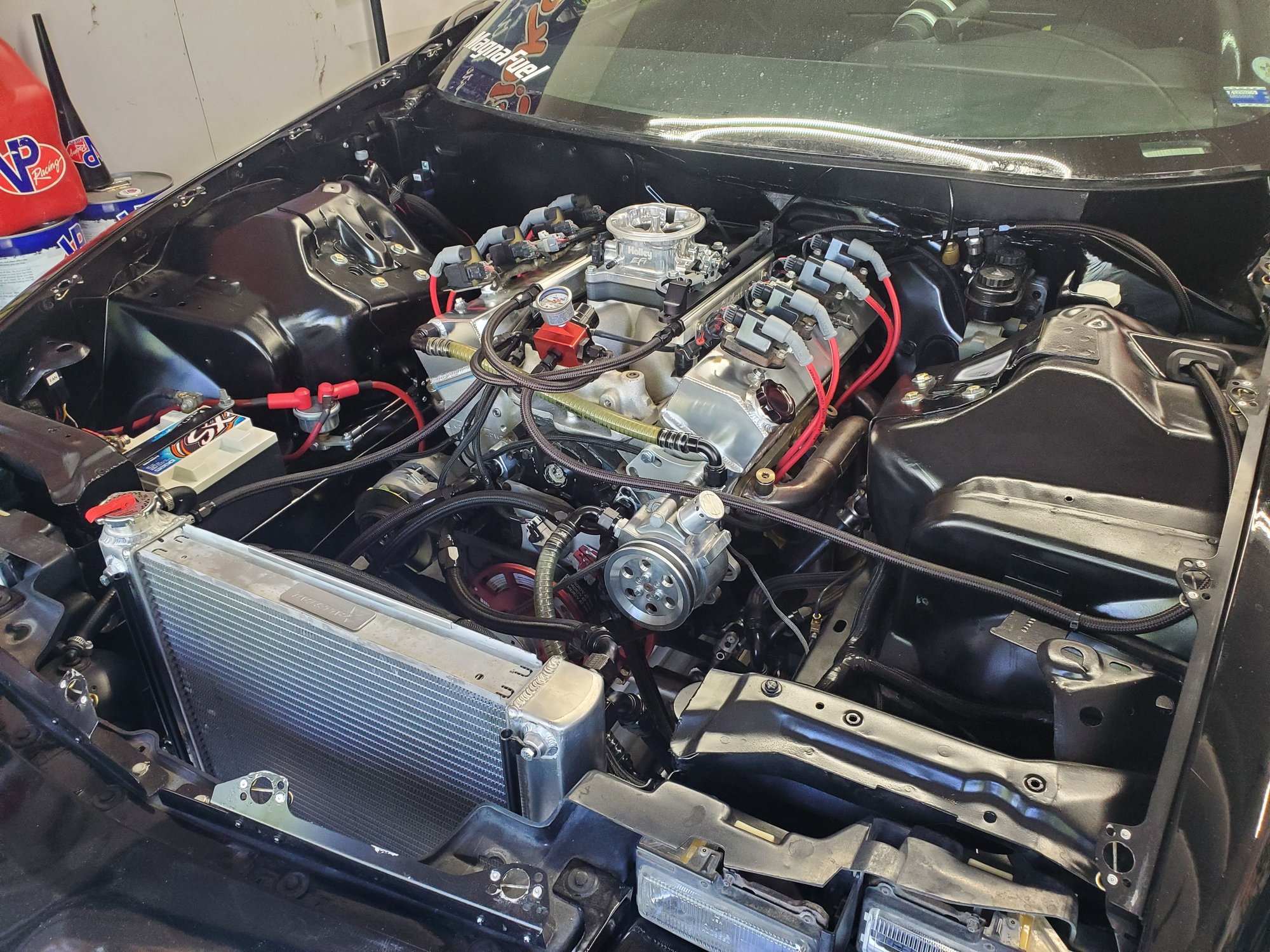

Old Sep 28, 2022 | 08:32 AM
96LT1355Z28's Avatar
Joined: Nov 2007
Posts: 841
Likes: 9
From: Holden, MO (KC)
These are what I have on my phone right now. I have an alternator so I don't see why the battery couldn't be used on a daily. XS would be able to give you a more technically sound answer.
