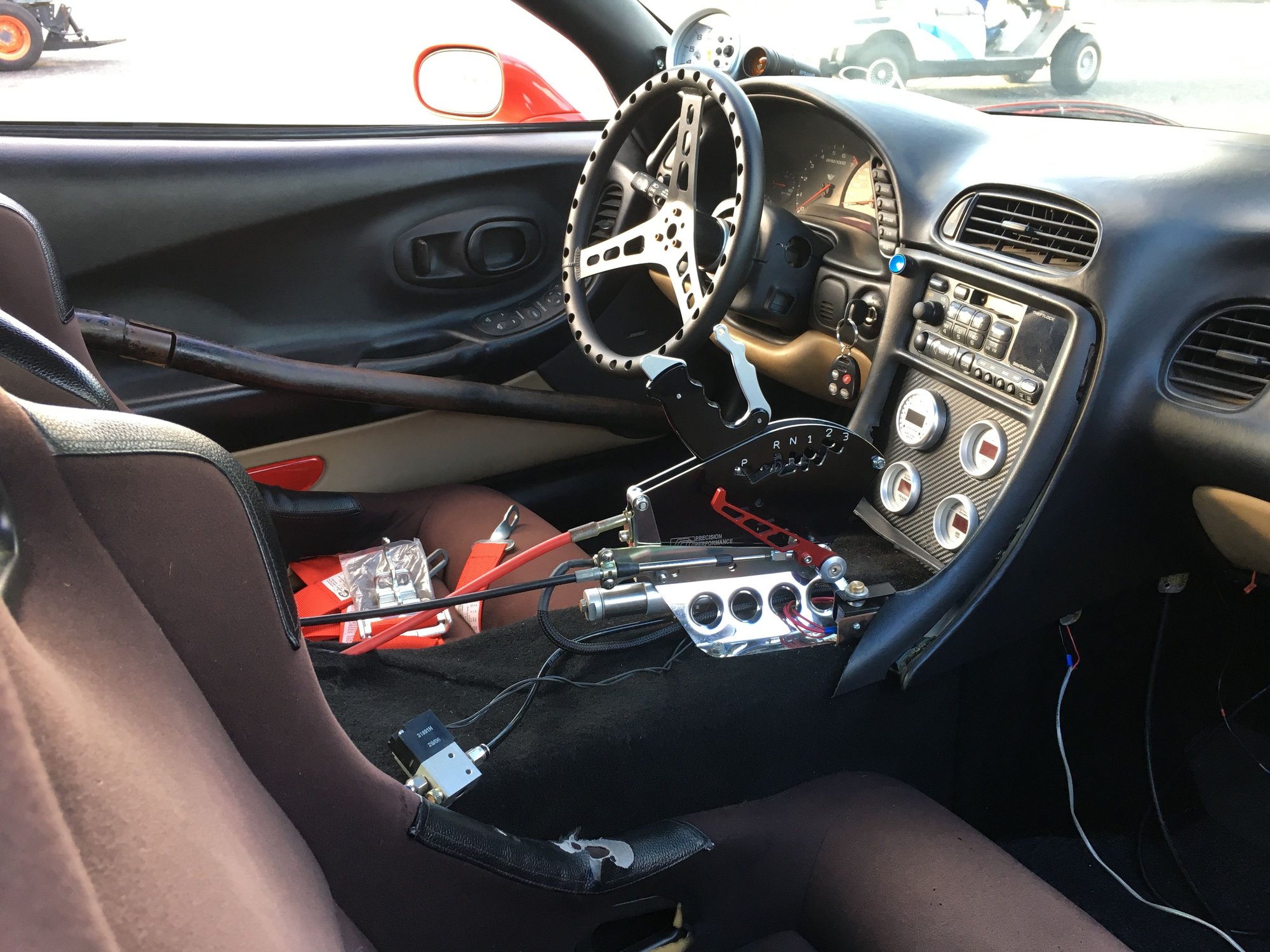

Old Oct 24, 2022 | 05:17 PM
C5_Pete's Avatar
Joined: Dec 2008
Posts: 983
Likes: 361
From: Washington TWP, NJ
Originally Posted by 96LT1355Z28
I used morse cable from my switch to a parachute release with a door handle attached to the console by the parking brake handle. The rod the at the back of the car is on a morse cable too, so I didn't have to run battery cables to the back. Switch is up front next to the battery. The car can be disconnected/connected from the driver seat or rear exterior.
That’s a good setup.
Lokar makes a remote handle that bolts to several brands of shifters to do the same thing. It’s the red handle attached to my shifter.
