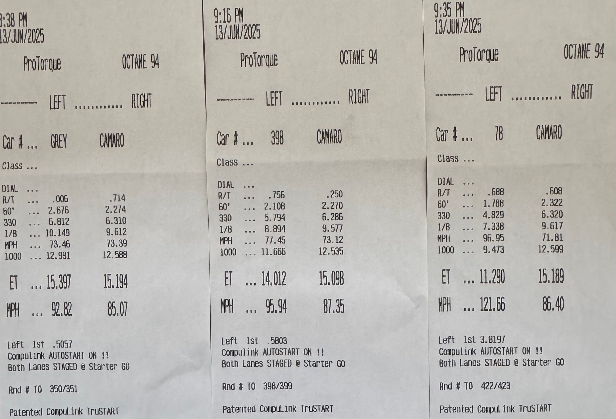

Brought my car to the track on Friday and I was super disappointed with the results. My best time was a 15.08. My mods are
cam 280/280 are the specs I was given
slp box
magnaflow cat back with a cutout
Bigger TB (can’t remember what it is at the moment)
and a 3400 stall.
I was hoping for at least 12’s with everything that’s done to it. It was tuned with HP tuners by previous owner. My fastest speed was 87mph in the 1/4. It
seemed to bog down towards the end. It just didn’t have the power I thought it should have. I’m thinking I need to take it to get another tune by someone who knows what they’re doing. Any suggestions???

Don't change anything yet Zach.
You have a few ways of approaching this.
Zach figures it all out on his own
-He buys an HPT cable and starts logging
-He makes changes in the tune because he figures out some stuff
Zach takes the car to a good local LS performance shop
-Shop figures it all out.
-They dyno it.
-They suggest changes.
My thoughts:
-3400 stall is not that loose. Maybe when it felt like it lost power was when the tune commanded the converter to lock up. Do you want the converter to lock up during a pass, yes. But figuring out when requires you use a tuner person or figure it out on your own.
-First, you should post a whole slip, even though it's pretty weak. Maybe you need to reset the ECU, maybe it's in low octane tables, maybe someone ran 87 in it for a while.
-Second, make sure all 8 cylinders are working. I'd throw a new set of plugs in there.
-Not knowing what RPM your cam pulls to makes this tricky. Again if you have HPT you can log a track pull and then look at the commanded shift points and what it's doing. Were it me, after I changed plugs, I'd look at my tune via HPT, make sure the timing advance is kinda in the zone (25-28 degrees), and I'd make a pass while logging. I'd make my first pull having the 1-2 and 2-3 shifts happening at 6200, then next one 6400, then maybe 6600. You should at some point feel the car nose over.
-Converter looseness is complicated. You go looser so it will stall higher, so when you hit the gas the engine can start off at 3400 vs 2500 for stock. The shift points are always some sort of compromise depending on how loose the converter is.
-Locking the converter, were I retuning it myself, I'd start off not locking it at all, then I would try locking it at 100 mph in 3rd. If it runs more mph it likes it. I might try then 97 mph and see what it does.
What gear do you have out back, 3.23 or 2.73? Are you racing on a DR or a street tire?

Thanks for the input! I’ll post the results of the 3 passes that I made later today. There’s a really good tuner who can tune and dyno the car in my area. He actually did my previous z28 and it made really good power. I’m going to contact the previous owner and see if he can tell me exactly what is in the car for sure (cam, stall, etc). He gave me the laptop he used to tune it along with all the HP connectors, cables, etc. but accessing it has been a pain. I’m currently running street tires. It was only a test and tune night at the local drag strip so I figured I’d try it out and see how it went.

Sounds like you have good resources to figure this out. 15.x is a weird 1/4 to run you know that.
You never mentioned what rear gear you have.
Did you spin your *** off at the hit on street tires?

Old Jun 17, 2025 | 04:26 PM

Yea, 15.x is terrible. Im working on finding out what gears are in the car from the previous owner. Didn’t really spin that bad. First pass i just took off from a dead stop. Second pass I tried to foot brake it and left at around 1,500 rpm. Third pass I tried to foot brake it again but at a higher rpm and I ended up spinning a little bit when I left.

Looking at your timeslips you are way down in power.
If there isn't a noticeable misfire,
pull the plugs and take a look at them.
Do a compression test.
If you have the funds I would put it on a dyno and check the tune.
Something is definitely not right

Yeah you have a lot of stuff to look at.
Does it feel like a 15 second car? My daily driver truck (2018 Colorado ZR2) is probably around there.
A stock 4th gen with 3.23s would run 13.4 and sometimes better back when they were new. I'd expect with headers, cai, 3400 converter on a tire with a tune it would run somewhere in the high 12s. With a cam, again on a good tire, would expect low 12s.
With skinnies, some weight reduction I went 11.7 back in 2000.
