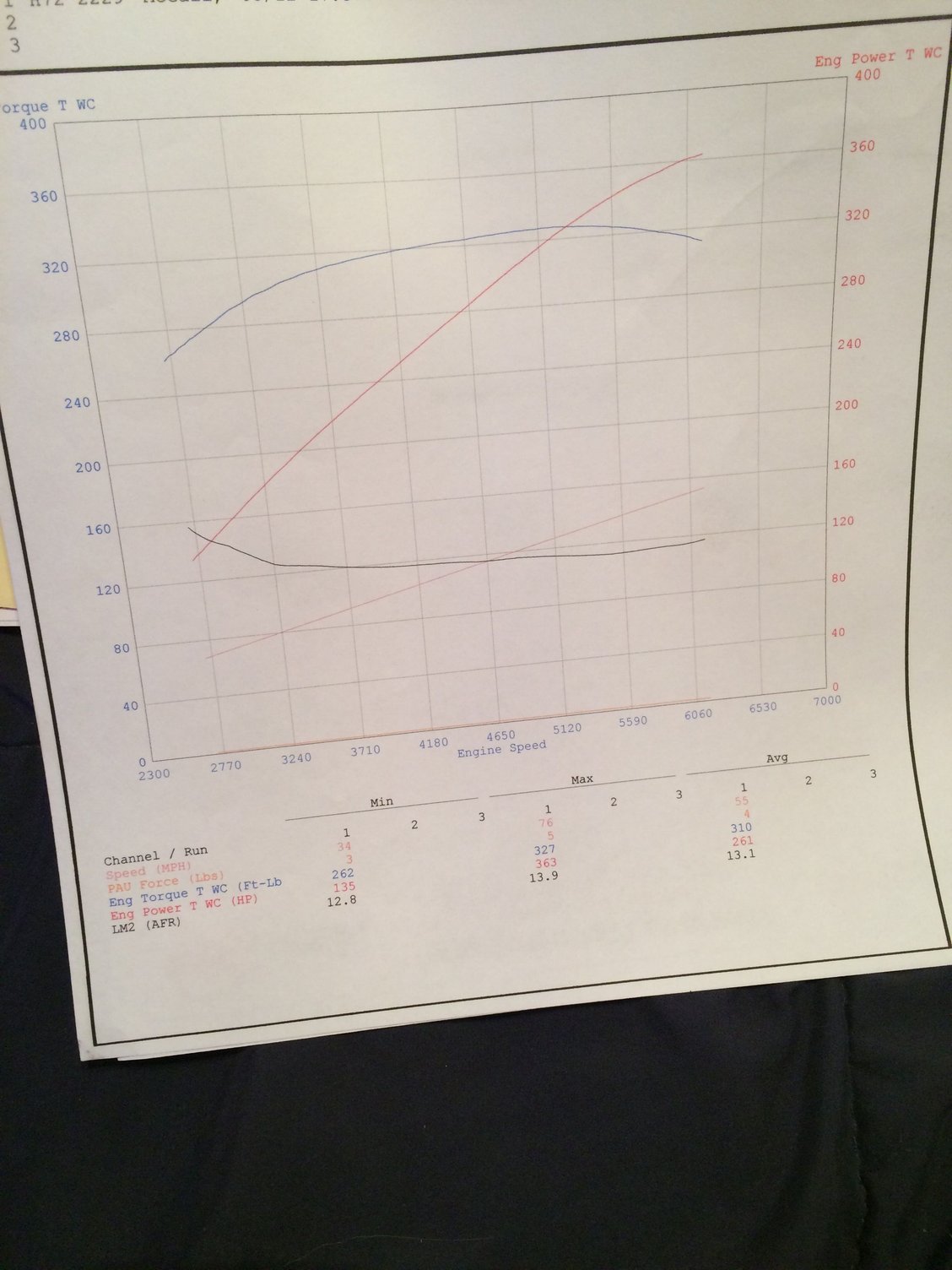

So I was told it was safer to dyno my car in 2nd vs 3rd. Lower numbers but still runs perfectly fine. Anyways my question here is a) are my numbers Low for a heads and cam car and b) what can I do to go faster?
The car has ported heads and a decent sized cam, no crazy huge but this one replaced a 228 cam.
It's a 99 Camaro with ported heads, custom cam, ls6 intake, slp intake, headers, exhaust, and the car has some weight taken off

What numbers??

Originally Posted by HCI2000SS
What numbers??
Sorry I guess it didn't load

Tell us what gears,tires and what your shift points are set at.

His trap is a miss with his current set up. I think its a combination of shift points, gear and tire combo.

is this on a mustang dyno?

also HP was still climbing when the run was ended...so it doesn't show max power

Yes mustang dyno
The car has a 18" mt et street on it and has 3.73 gears
I agree. You have some more power to show if he had run it up some more.

So should I go get my car retuned? If so by the same people or take it some place else?
