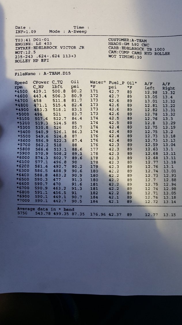

I'll have a graph by next friday! Sorry for the wait guys

Been a while but I should be picking up the dyno sheet today. Sorry it's taken so long.

i think thats a real nice motor setup espically for the cr and cam size hope you meet your goals but with that power 10s should be easy to get.my buddy has a regal with old school 383 makes about 520 flywheel hp it runs 6.90s so i guess that a 10 or very close to a 10sec
Well that makes me feel good. What does he have as far as suspension and rear end?

Well that makes me feel even better then. I should be in the 10s no problem. I don't want to count my chickens before they hatch.
