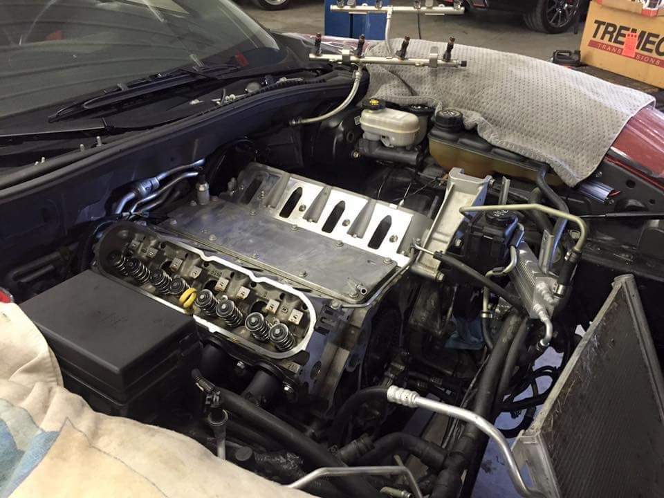

Ok, nothing exciting, pretty average probably but this is a mild cam too,,, but I am pleased,
Dyno temps outside was 94 Degrees in INDY
Baseline was 375 RWTQ & 362 RWHP
Bseline parts, Kooks 1-3/4" Kooks Hi Flow Cats, NXT STep cat back, Callaway Honker CAI, ECS Mail order tune
After BTR Cam
http://www.mikenorrismotorsports.com/
BTR Stage 1 NA - 224/230 115 Camshaft, Peak Speed radically ported LS2 Stock Intake, Peak Speed Ported stock Throttle Body, Callaway Honker Cold Air Intake, Kooks headers 1-3/4", Kooks Hi-Flow cats, NXT Catback, Upgraded timing chain and BTR Trunions, Double Springs and Pushrods, all else is stock

So you added the cam and ported intake and TB?

Actually I forgot that I had the ported TB already, but yes a new BTR cam, push rods, Radically Ported Peak Speed LS2 intake and obviously push rods and springs.
Spring mods will be CNC ported LS2 heads and maybe Meth Injection, that in total would put me at 500 RWHP
