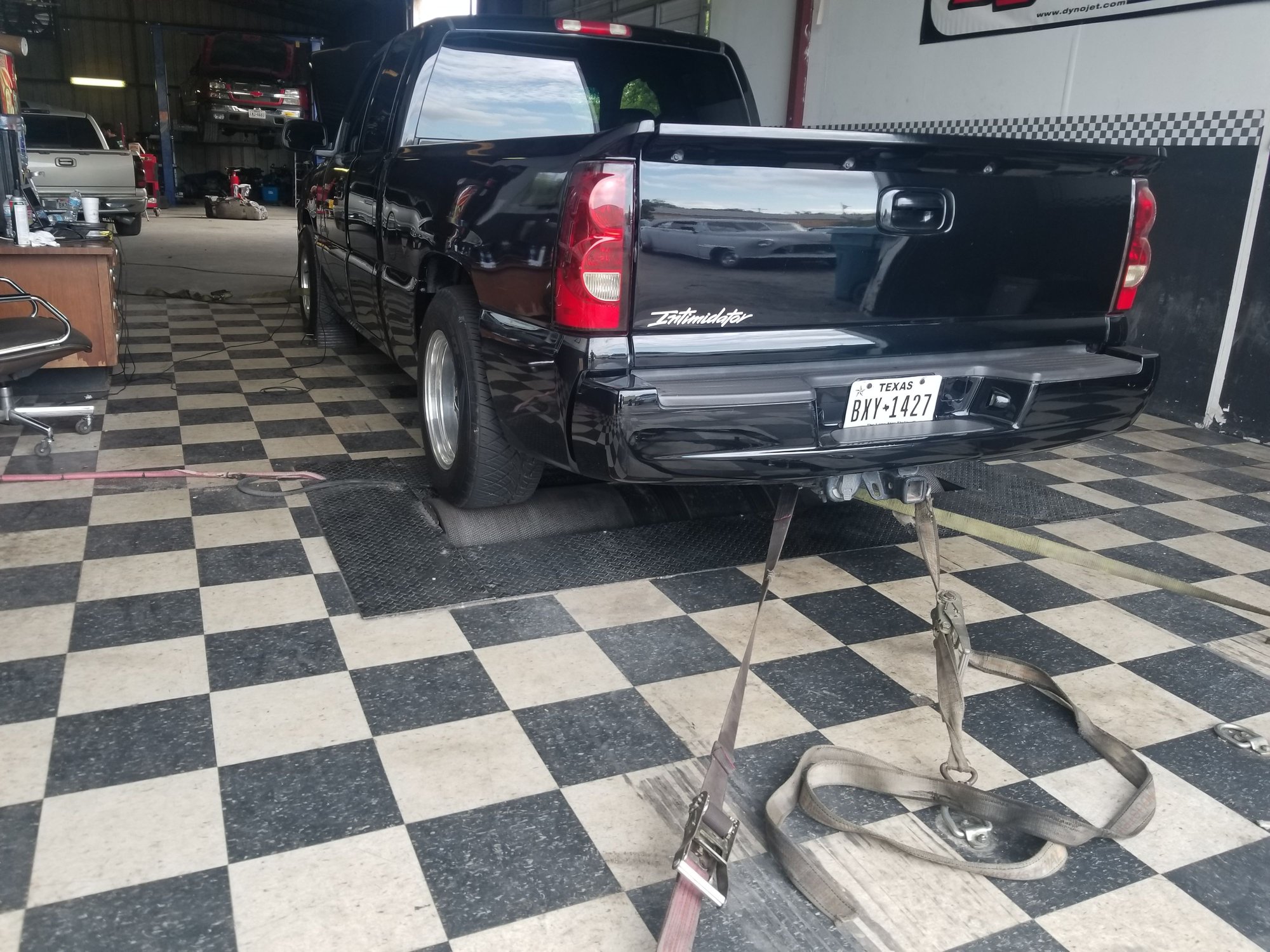

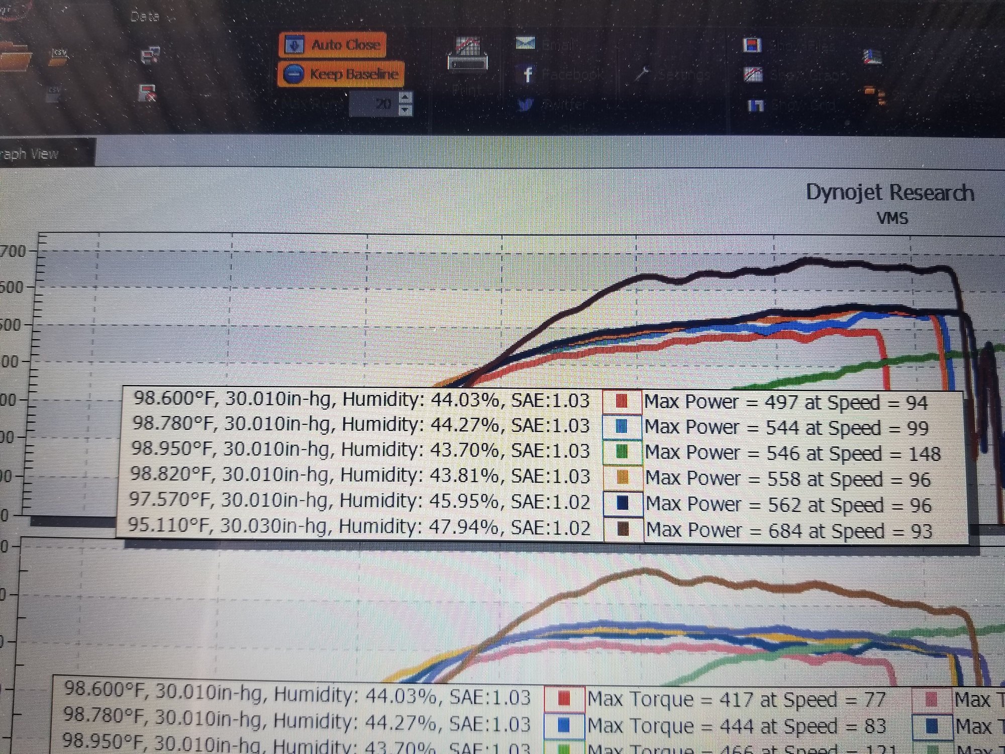

Did another gen 3 4.8 today. 16 psi 21* turbonetics 7865, btf turbo kit, 80 lb injectors , twin 450s, e75, my pnp flex fuel kit, pro flo intake, 4l80e, 2nd gear unlocked. Didn't get a pic of the 700rwhp pull as I had closed the runs by then. Shifting it at 7200, cam is a 220/224.
