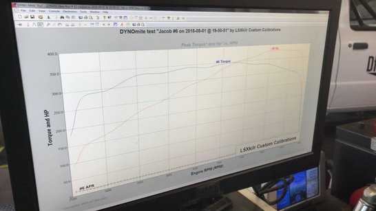

I had thought that at first but two things made me rethink it. The peak torque and hp RPM were basically right where they should be. And a 416 should clear 450 RW tq on accident. Its the low torque curve and its shape that point to 346 displacement

My built LSA engine did exactly that on the dyno, numbers were 440 where it should be close to 600 at the rear wheels, saw a small electric arc in cyl. #2 spark wire, replaced it and off it went up to 573 right away. The strange thing is it never showed anything when we scanned it, no misfire codes at all!

Three times Tq tried to climb prior to 5225 RPM, an appears to peak at around 5100 +/- a few RPMs. Doesn't that seem a little strange when compared to TQ curve of you far experienced HP junkies engine builders' engines have (By the way that's not a put down to you, just question of, doesn't that seem strange if it's internal engine component(s) problem!).
Is that not strange to you. Engine seems to still trying to make more HP/TQ. Doesn't seemed to have laid down and quit.
Is it the engine it's self, or something else?
Missing OP is another problem in it's self. Why!

No. Torque peaking at 5100 is not weird. The bumps before that are just harmonics/tune related.
The bigger problem is the torque is very low. It doesn't matter if it tries to make more. It's not going to make the 100-150ft/lbs more needed for it to be right.
It looks like a 5.3L motor, not a 416.
