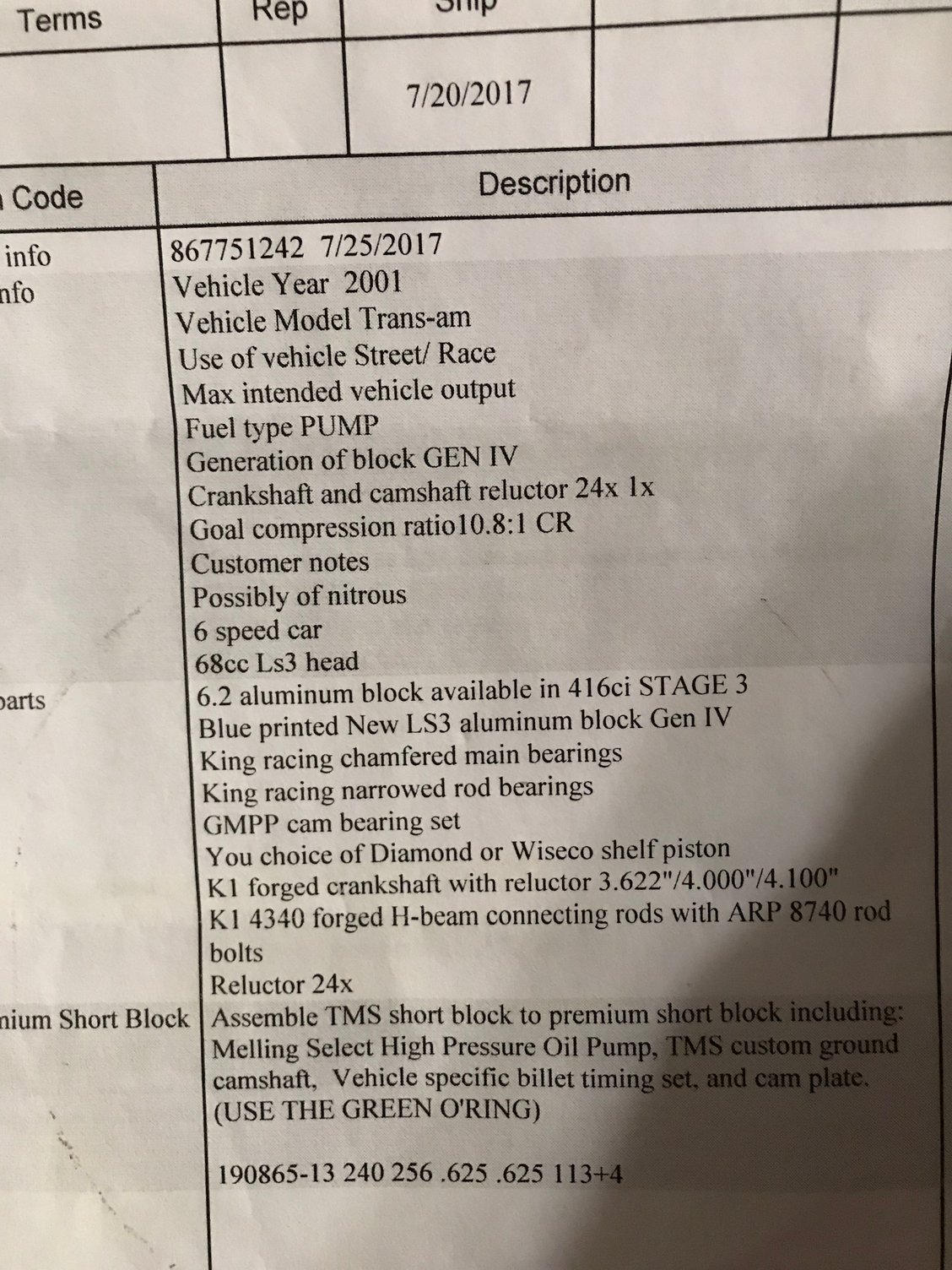

Hello, I have an 01 trans am with an ls3 416 stroker. Just got done & put on a dyno & made 380ish to the wheels Which from what I’ve seen 416s usually make 500+. And the guy that tuned it said it’s on a mustang dyno & has a stock ls3 intake & that’s usually what he sees 416s make. But I have a couple friends that have 416s and they made around 560 with a stock intake so I call Bullshit. What do you think? I’ll post all of the details about the car, which I know I’ll forget something so just ask and, keep in mind, I’m deff not a car guru, Still learning.
01 trans am
416 stroker built by Thompson motorsports, which build sheet is in the pictures
Stock ls3 intake
65 or 62 lb injectors
92mm NW throttlebody
ls3 CNC ported heads
T-56 6 speed with monster stage 4 clutch
MWC 9” 4.56 gears
Thank you for your opinions.

Originally Posted by JakeFusion
That's about 380rwhp? And 350tq?
What cam is in there? TMS assembled the long block?
Those are around the numbers.
240 256 .625 .625 113+4
TMS assembled the short block and then I had the heads out on locally.

JakeFusion's Avatar
Super Hulk Smash
Posts: 11,258
Likes: 146
From: Pace, FL
That's a healthy cam. Should be at least 470 to the wheels assuming the pushrod length is right and all 8 cylinders are firing.
Time to check the plugs (getting spark on all 8?) heat gun works to see if there's a dead cylinder. If all are firing, time to pull the valve covers and check lifter preload and pushrod length.
