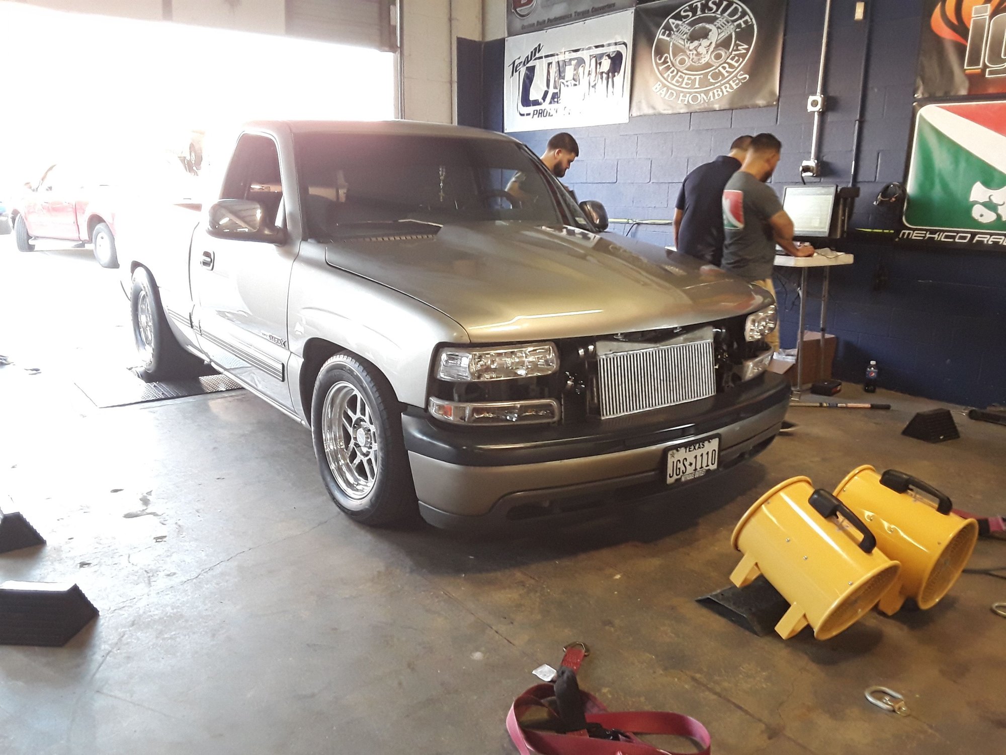

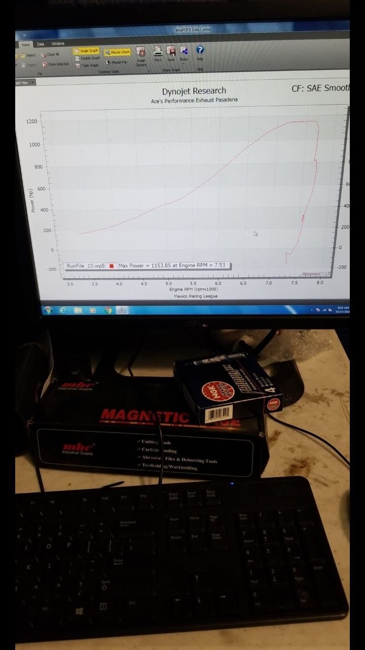

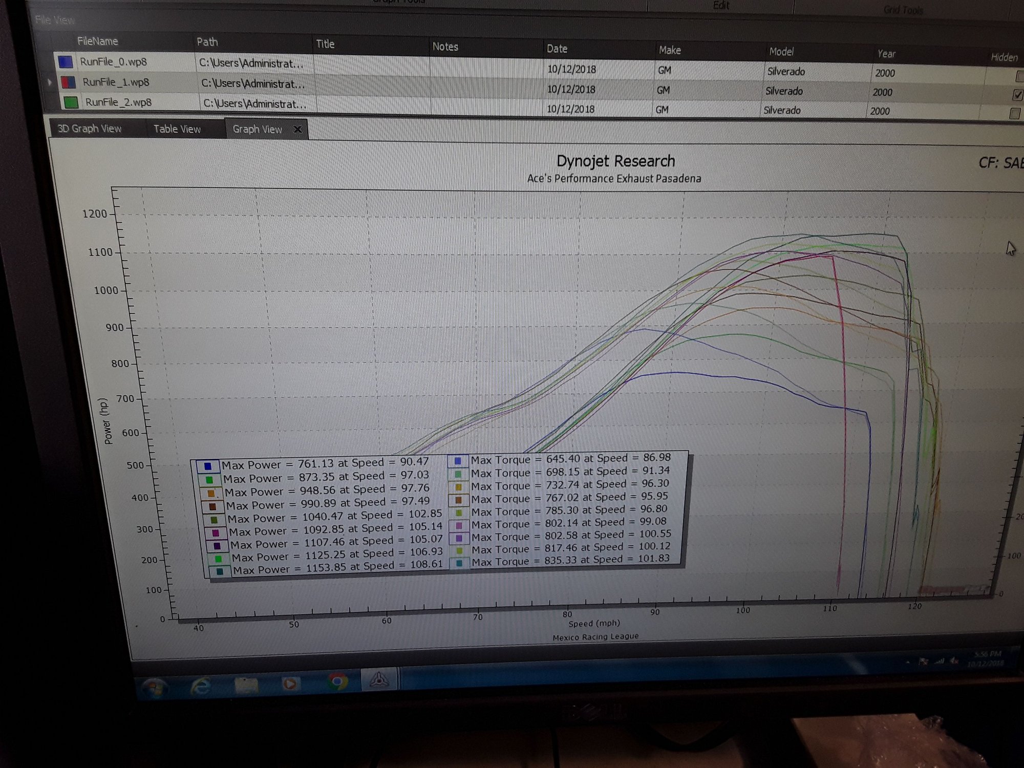

Made 1150 rwhp and 8xx rwtq
~25.5 psi
370 CI stock ls7 lifters LJMS cam
twin turbo e85
Holley hi ram, stock ls3 heads
made power all the way up to 8k rpm (for lsx power tuning who always doubts me :p )
4 bolt block
I know it can do 1300-1400 without lifting the head just b looking at the torque and where it generates it

Hard to tell with all the runs vs just a single run....Dont think that was a cam only 4.8 or cam only 5.3 like the one I was questioning? Still would like to see it in RPM and not speed.

haha you got the KR graphs labeled "suicide"

Badassness
Sweet truck too

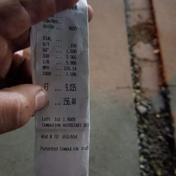

Here's the slip btw

let's see if it uploads this time

Got it now.... NICE time!!

Wait till you get that 60' figured out! 8's in the bag with that mph! Nice!

Yea it's got 8s for sure on this boost setting, owner pedaled it 3 times on this pass. Always has a 1.3 60' . Stock shocks and just traction bars btw lol leaf springs all factory.
