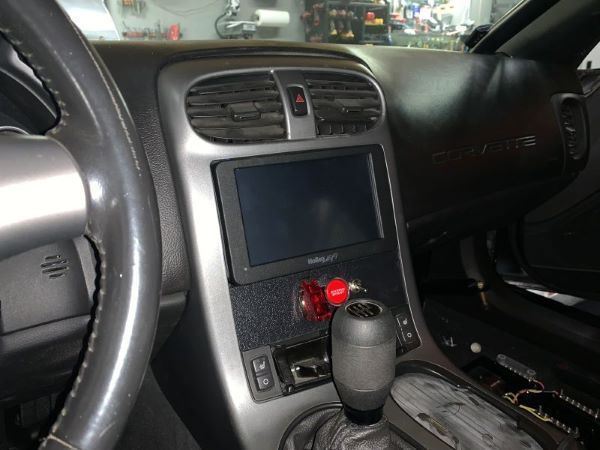

Base tune for Texas Mile with F1X and Holley Terminator X Max. This is the same car that blew out the tire a couple weeks ago. We be racing it this weekend at the Texas Mile. We put the 7" touch screen where the radio was.

Awesome placement of the screen. I assume that the stock cluster is fully functioning?
Nope, there is no stock ecm left in the car. The harness was getting in really bad shape and were constantly having electrical issues is partly why we went with holley and new holley harness. At 200+ mph your not trying to read gauges really. We use a shift light and warning lights if something gets out of limits. If this car was still a street car we would have maybe made the stock cluster work but with the full cage, containment seat and other safety required to run the speeds at the mile its not really practical to drive around. The Z06 we have that runs 216 is 100% street car still but we also can go faster legally at the mile.
I gotcha. I just assumed, with the placement. Do you have a build thread of the car? I also have a c6z that I will be installing Holley on. It's still a street car. We also have to deal with emissions. I'm not sure how to go about integrating them both to get it all functioning properly.
We were so busy with blowing out the tire on the dyno and fixing the car we never got around to doing a build thread. We will try to do one soon. You will have to piggy back the stock ecu and holley.
