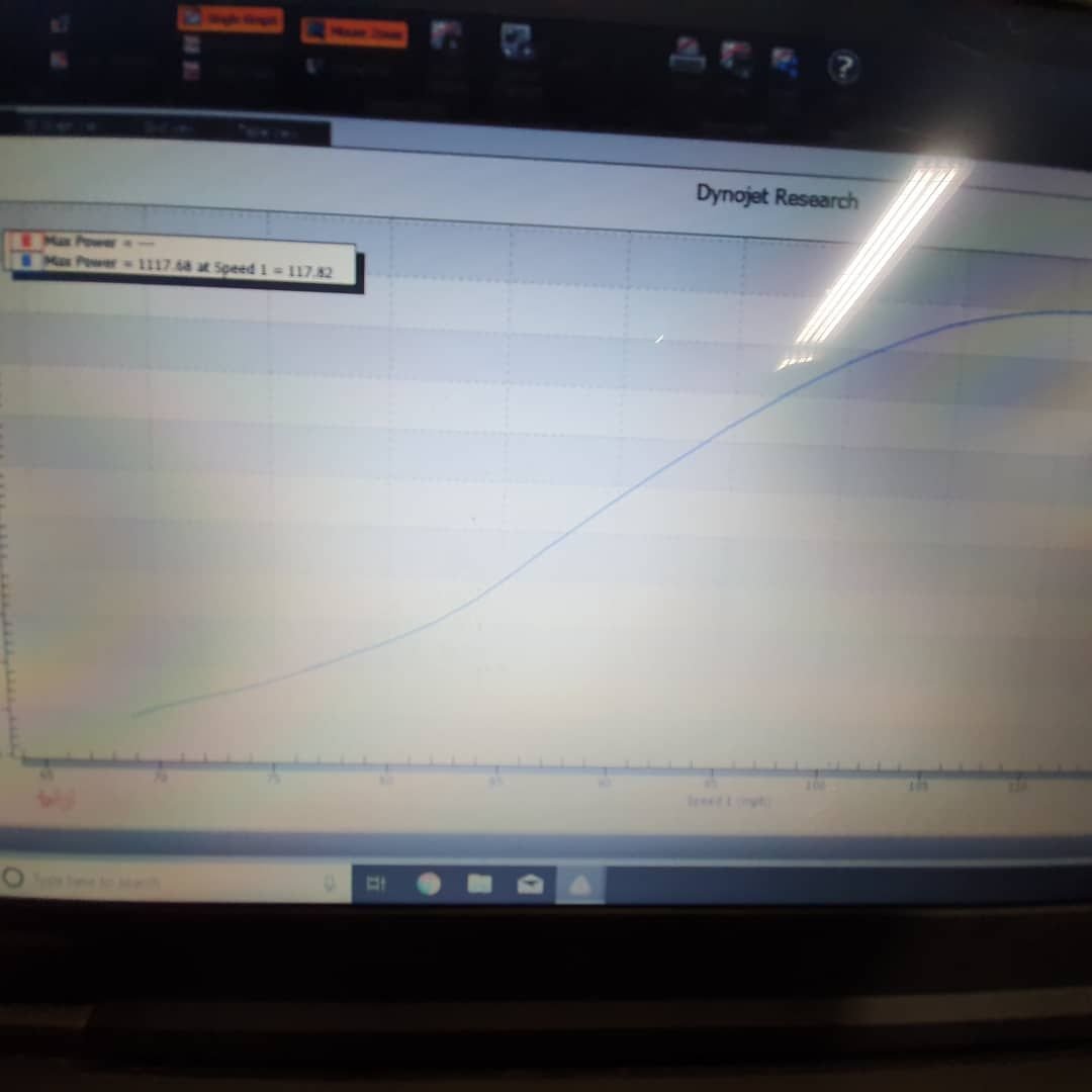

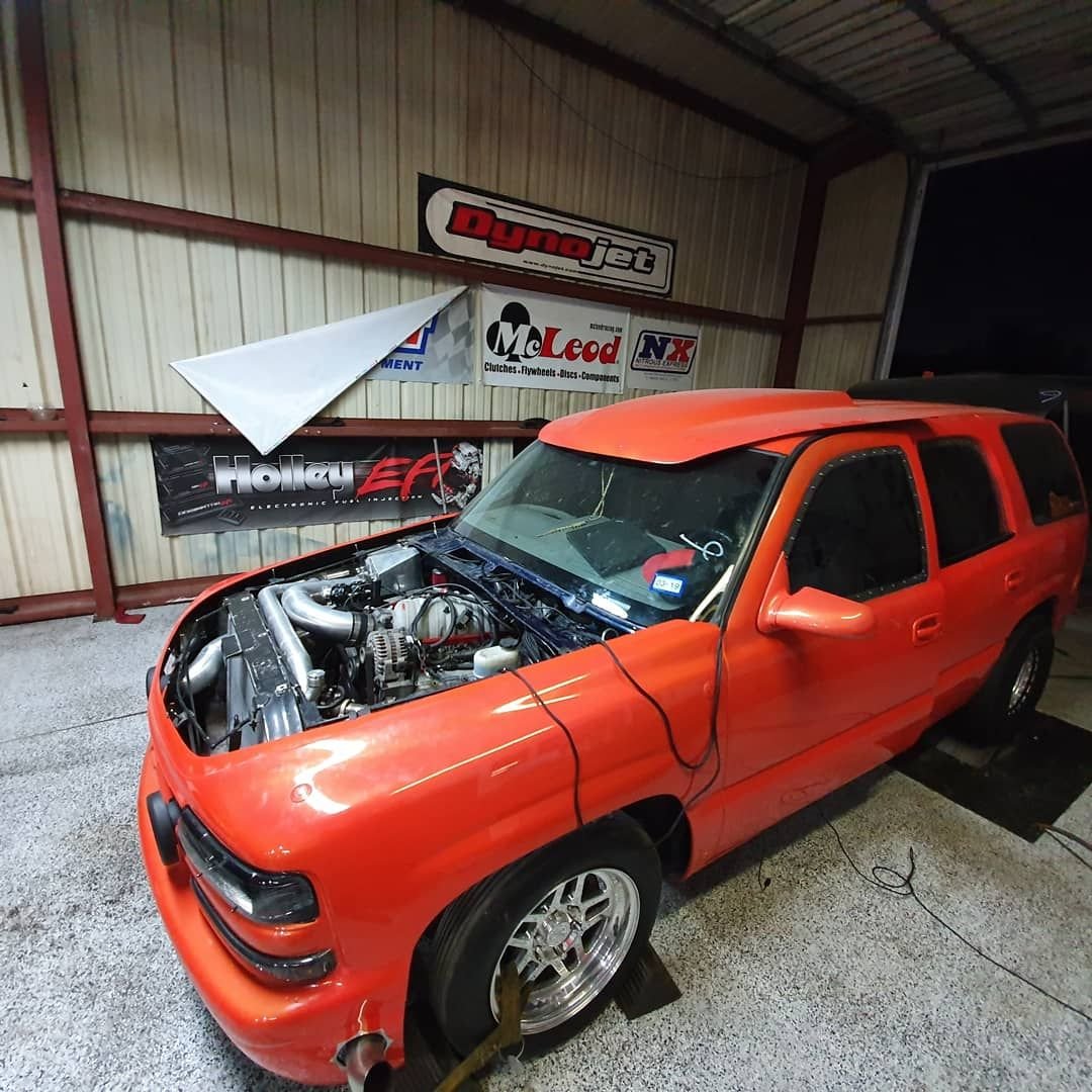

Default 1100rwhp suv
Gen 3 sbe 5.3
Head studs and gaskets
Btr cam
Fast lsxrt truck intake
33 psi
Twin s366 from FI
80e unlocked 3rd gear
Stock ecu
210s and e85
1100rw

This really slaps a lot of people in the face building engines for under 850whp! Congrats that's gnarly!
Why is the speed only 117MPH? Looks like a decent size tire and 3rd gear at high RPM should be rolling.
