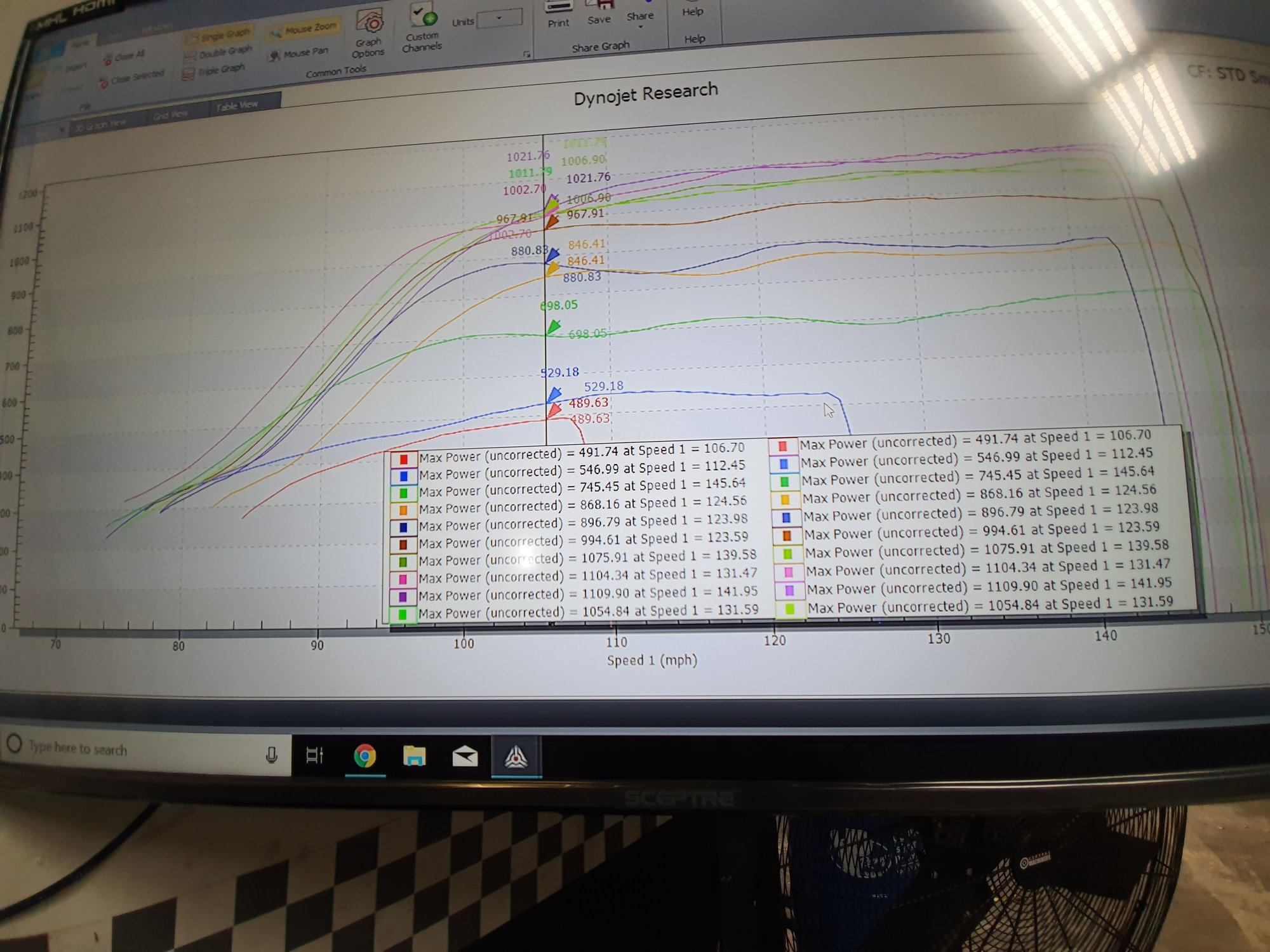

Default 1100 wheel chevelle
390 CI twin s366, 24#, e85, dominator efi
14* of timing .78 lambda

You gotta start posting pics of the cars/setups not just Dynographs!!! Seems like low timing given the E85.

Yea timing was soft, but im sure we ran out turbine

You don't have to get greedy on timing with E85 either, can go 160 with 12-13*. Considering its a 390 it prolly has better heads then your typical small bore cathedral that may want a little more as well. Just watch the plugs like anything else, if that's what it wants that's what it gets.

366's have a decent size turbine ? shouldnt be much restriction at that level yet ?
Yeah, 73mm. I think it was running out of compressor. It was picking up 25hp per pound above 15. Also, converter slip gets worse as you turn it up. At 24psi it was 8% (not bad). When I want more, I’ll throw s372sxe’s on it.
