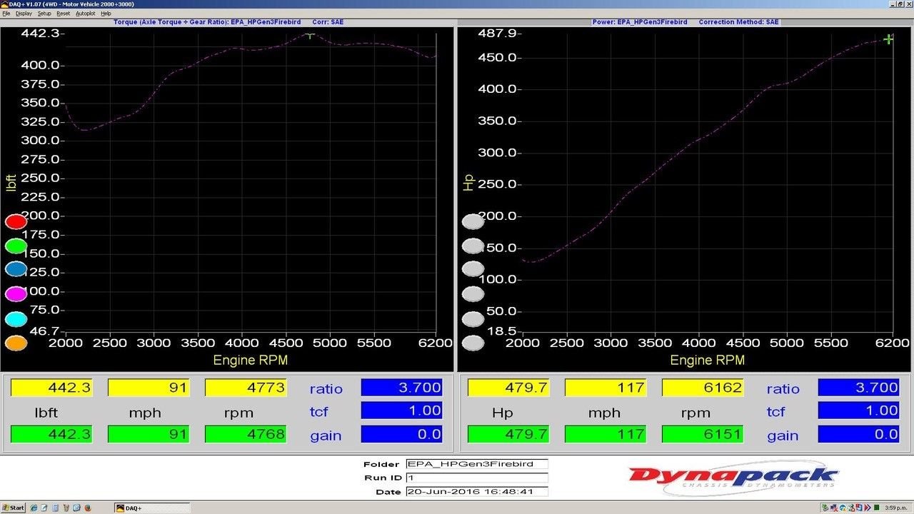

Finally got my car put together after the winter build was complete. I had a local guy put my moser 9 inch, racetronix fuel pump, and get me a new driveshaft made. He also did a bit of preliminary tuning on HP tuners to get the car drivable to get to the tuner. He suggested a local guy who specializes in Honda/Acura but also does online tuning classes. He asked if I would be willing to drop off my Gen 3 LS for his class in exchange for a tune, of course I said yes to a free tune! He has done a few Gen 4 LS vehicles in the past, and my mechanic was confident in his abilities as well. After a few days I got the results back 480/440, he used a hub dyno. I completely understand a dynamometer is a tuning device and am not obsessed with chasing numbers. I am just sharing my experience, my mods, and my results. Tick, TSP, BTR, Brute Speed, and WS6store/RPM were awesome and incredibly helpful and answered all my questions. I was wondering what peoples experiences were with hub dynos and how the compare to roller dynos? Here is my mods list.

At that RPM range with those mods, definitely not accurate.
He also took the reading at the wrong spot for HP.

I thought it was strange that the graph only went to 6200 rpm. Where should he have taken the reading?

Torque exaggeration due to no rear wheels mass? Like 100 lbs rotating mass not there do it reads higher?
