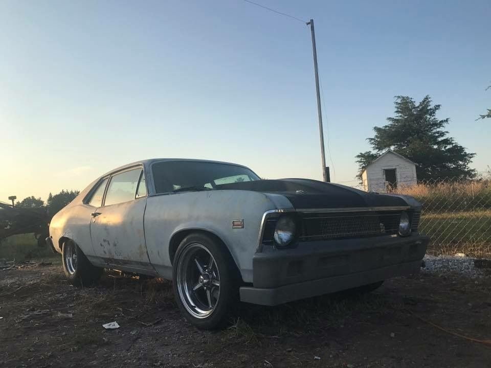

Hey guys, going stir crazy thinking about this build while parts are being finished up at the machine shop. Doing a hot little n/a ls1 in my 2700# nova
ls1 with stock crank, new gen4 rods stdx bearings throughout.
dss 6cc dome pistons 3.898 bore
.040 cometic head gaskets with the extra cooling holes to help cool the chambers
862 heads milled .060, ls1 diameter I take valves with new ferrea valves, 5 angle valve job back cut etc,
14.2:1 compression,10.94 dynamic
heads are ported by me with the guidance of months of reading and helpful tips from Ed Curtis. Bowls blended, etc
Ed curtis Cam, 255/261 .650/.650 on a 111
btr .685 lift platinum springs titanium retainers
Holley split race single plane with 4 barrel throttle body, port matched to the heads.
Billet double roller timing chain
ported dod oil pump, with bypass blocked and an external bypass controller. 20/50 schaeffers
tci 5500 stall / th350 with a brake
9” rear 28x10.50
