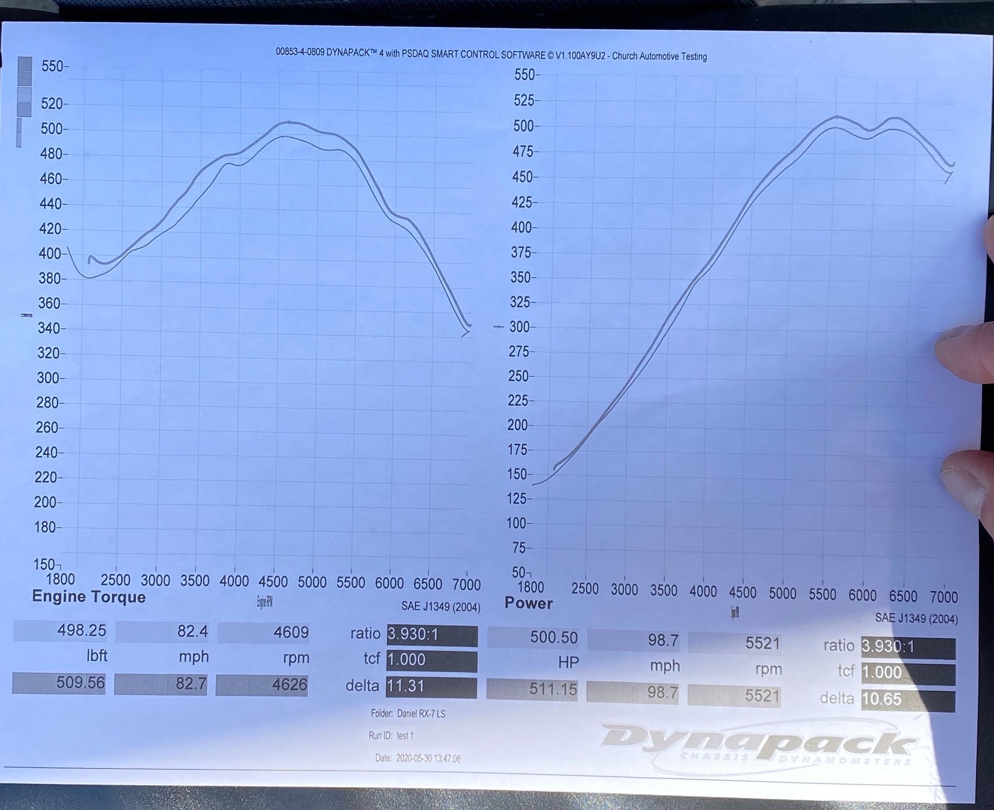

Fresh dyno results after a round of quarantine mods and getting tuned at Church Auto in Socal. Highly recommend these guys!
Changes from last time when it made 468/451 on a dynojet:
Optimized intake tract and swapped to LS3 maf from LS2
1 7/8” merge collector headers into existing dual 2.5” xpipe exhaust
IGN1A smart coils With tr6ix plugs gapped up to .060” (more for the next big cam engine on e85)
Longer Summit HDR pushrods 7.450” length .120 wall 11/32 diameter (killer parts!). Ls7 lifters at 2-2.25 turns trying to make the cam act bigger.
LS3 rod mod intake by GPI - no porting just the mod
RPS BC2 Carbon clutch 30 pounds total - in love with this thing
Engine specs -
4.005 x 4.00” LS2 11.1:1 compression
Stock ls3 heads
Baby Comp cam 226/242 on 117+3.5 LSG lobes
Diamond pistons ceramic tops and coated skirts
Callies crank and rods
GPI rod mod LS3 intake
1 7/8” merge headers into 2.5” xpipe
Dyno video:
View this post on Instagram
Wound up making 511/509 and really smoothed our the curve with the headers. Big midrange gains, and pulls higher before falling off although it still runs out of breath with such a small cam.
Stock c6z’s dyno 460whp at Church, and headers/intake/tune tend to be 500-505whp. Feeling great about the gains.

Thanks brother!! I was honestly not expecting a whole lot and came away very happy both with the tune, and how well the car runs with the new parts.
Very happy with stock ls3 heads on a 4" bore.

good numbers, great torque for a baby cam. Interesting choice in plugs. Probably some power to be gained stepping up from a 2.5" X also. Good stuff!
Yeah I blew some money I probably didn't have to on the coils and the plugs, but it is more for the LS7 I'm building that'll be 12:1 (was planning higher but would've needed custom pistons and cheaped out) and I'm going to run it cold on E85. The cam will have 35* overlap so I'm hoping the big arc with a lot of energy behind it will keep the thing running somewhat smooth despite the reversion due to the overlap. The smart coils will fire off a 3mS continuous spark which is pretty sweet and should really help with igniting a diluted mixture.
I will say though part throttle and idle this engine has never been happier. Idle is rock solid at 850 and the car doesn't shake anymore due to idle correction kicking in.
I think dual 3" would pick up a chunk, and definitely would with the bigger 427. It is hard to package dual 3" in the rx7 and not bang it off the ground. The headers are touching on speed bumps as it is. Dual 3" would hang low enough to scrape on driveways in the center I'm worried. There's not much room in the tunnel width wise to run oval tubing either. It's been done with dual 3", and definitely with big 4" single exhaust, but the sound of dual exhaust is so much nicer. I think for the LS7 I'll look to increase the size of the X-pipe to a 3" in and step it down to 2.5" on the outlet. That would give the exhaust more room to mingle and hopefully cool down a bit when it expands in the larger volume. As the gas expands it doesn't require as large of exhaust diameter. At the collectors and the first 18-24" is the most critical for flow. My mufflers are straight through 2.5", and the exhaust is all hand tigged mandrel bent 2.5" it flows really well obviously.

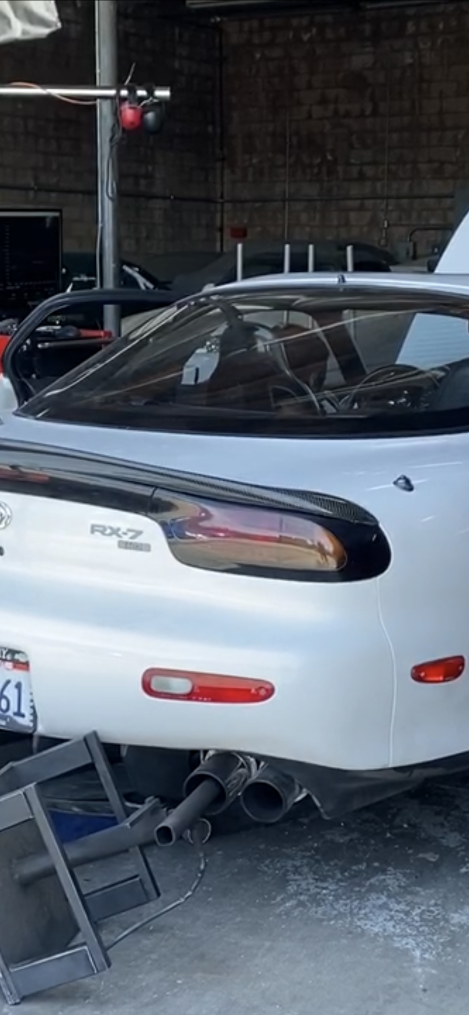

They use a pipe like this
Old Jun 5, 2020 | 08:34 AM
ddnspider's Avatar
Posts: 14,628
Likes: 1,778
From: FL
That's an interesting contraption. I usually try to slide it up in the tailpipe a couple feet to keep it away from oxygen that will cause a false lean during tuning....which will make it run overly rich post tuning.
