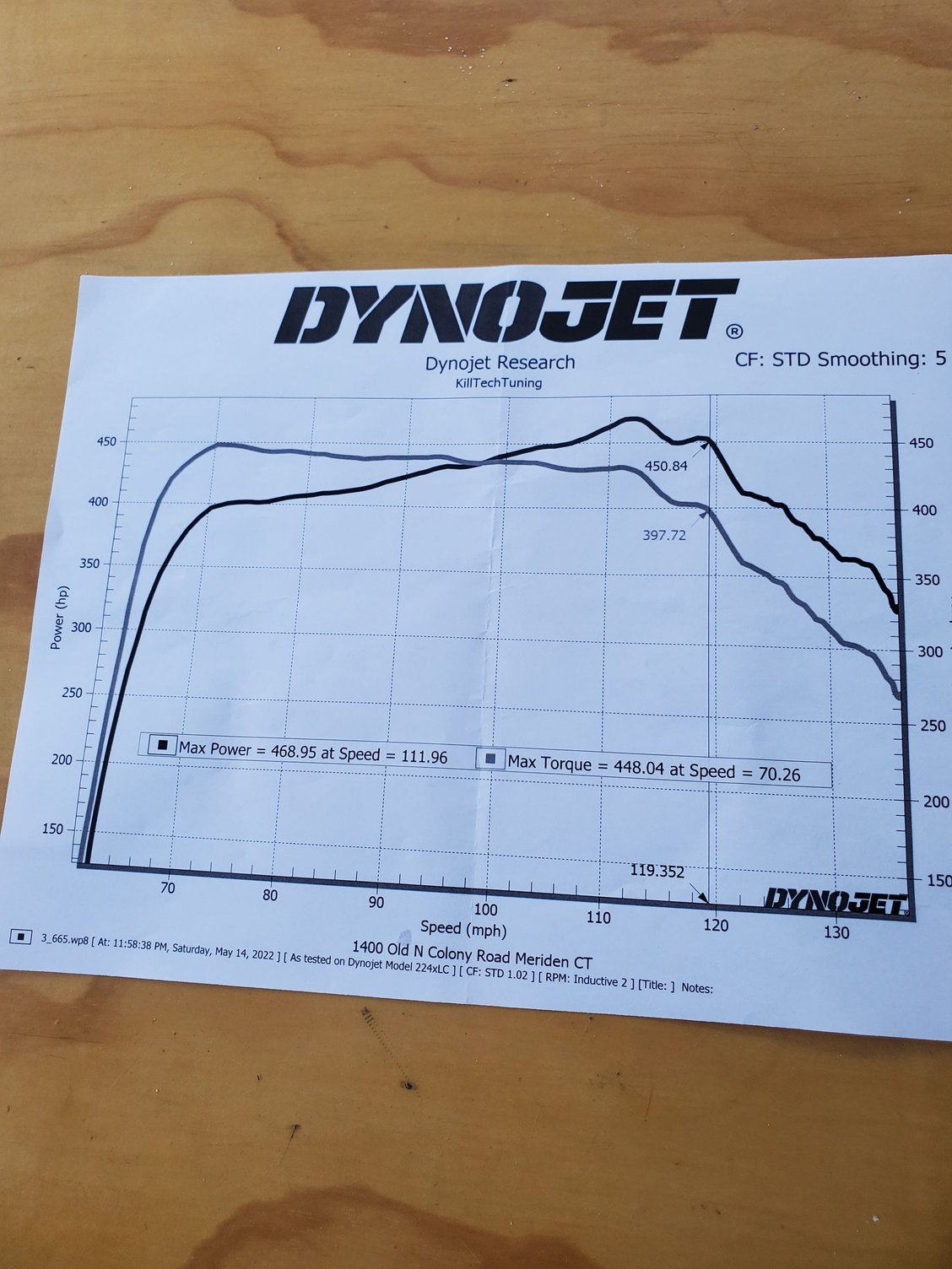

Here are my latest Dyno results. ADDED WITH RPM
LQ9 with mild can and not a blower cam. stock bottom end,stock truck intake.
2004R trans with 2800 converter and 4:10 GM 12 bolt rear

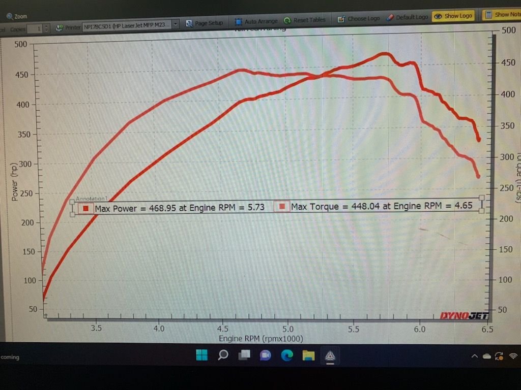

How much boost?

I wish RPM was on the X axis, can tell much more of the story than MPH.

Originally Posted by INIT2WIN
How much boost?
5lbs is all. Might go with smaller pulley in future

It appears you have some valve float...

Peak rpm should be peak boost. That doesn't look right at all.
that’s always the first thing I look for. I totally agree
Exactly. Speed is pretty irrelevant when it comes to dyno numbers, RPM is essential.
Old Jun 2, 2022 | 05:10 AM

Added chart with RPM

That is NOT what it should look like. Either you have major belt slippage or you have a valvetrain issue.

Could be both. I have a cam designed for the LQ9 NA not a blower cam. cam specs 222/226 586/569 114+2
The cam itself is not the issue whatsoever.

Only a 6 rib belt that drives everything. Most likely the issue. have upgraded behive springs and truncated rockers. only made 5lbs boost another sign of belt slipping

Something else I thought about is the crank pulley is not pinned and could be slipping. Going to pin it this week.

Should help. Does it feel better after pinning the crank?
