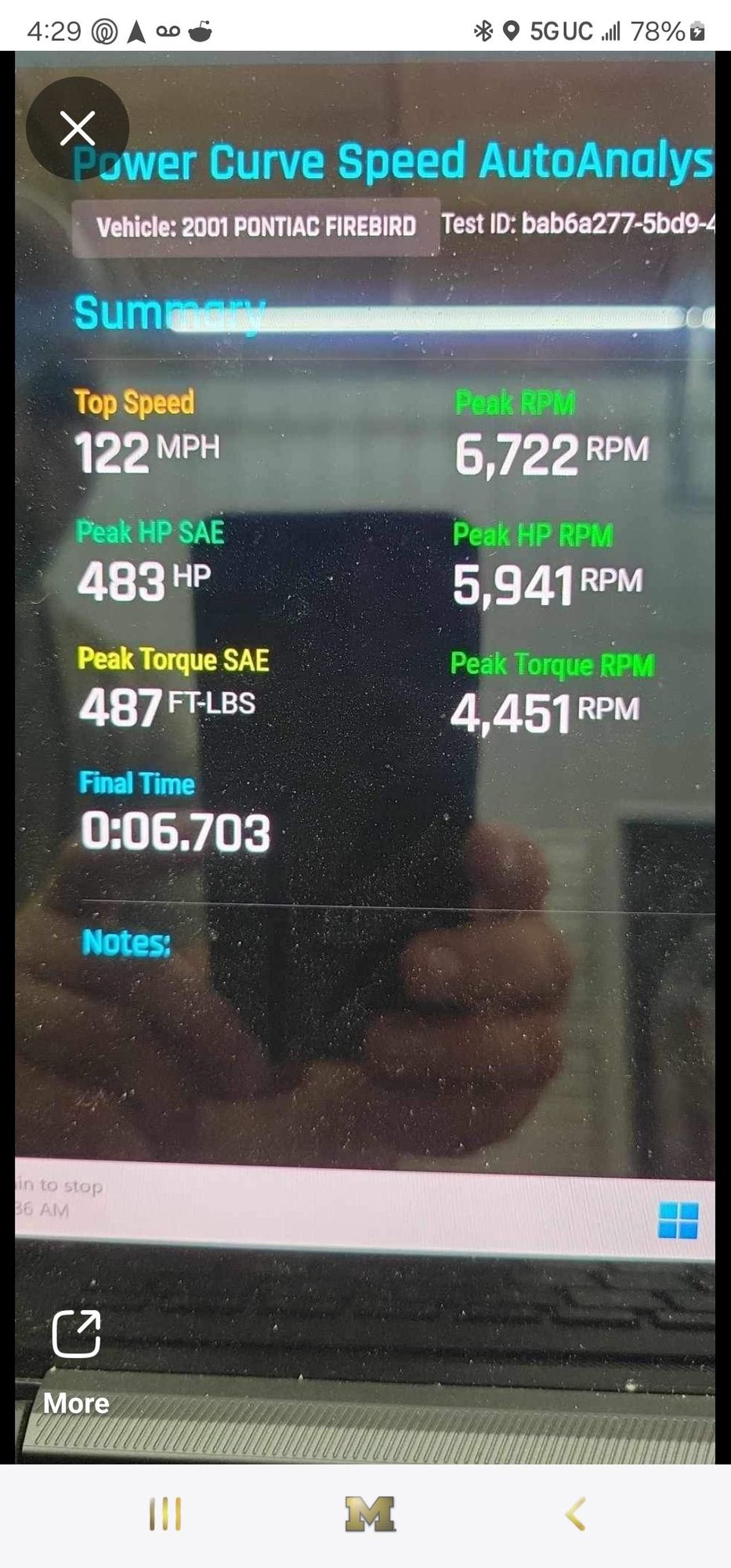

Why did my car come in so low on the dyno
Old Feb 7, 2025 | 07:54 PM
Lsx427hp's Avatar
Joined: Feb 2025
Posts: 5
Default Why did my car come in so low on the dyno
Build sheet will be posted I'm curious why my hp is down so low and what do I need to change to make this work better thanks in advance

No slouch, but look at the phone screenshot where HP peaked @ only 6k. It held it nearly flat after that, well up to 6700rpm; but it should've continued climbing (likely peak around 6500-6700). It's being held back big time. There's a nice area under the curve missing from 6000rpm+, maybe even some below that. He either needs to change the camshaft to match the exhaust, or the exhaust to match the camshaft.

The smaller GENX 235s are only 20cfm less than factory CNC ported LS7s (on intake, exhaust flows side flows more). So the larger GENX245s OP is running should be nearly, if not equal, to factory LS7 heads and their runner volume is more than sufficient to support a 427 up to 7k if everything else is properly matched.
The cam, while being somewhat small for the displacement, should also still gain power past 6k. (If the exhaust system was free flowing, the 18.5* overlap would allow the exhaust pulse to draw more intake charge at high rpm despite the intake duration).
Dyno type and altitude aren't going to cause the curve to peak and prematurely drop off after 6k.
Either there's:
  1. A mechanical/electrical problem above 6k e.g. cam off a tooth, valve float, ignition, incorrect a/f, etc . (Although with ignition or valve float I would expect the curve to look jagged). Or
  2. The intake manifold or exhaust setup is restricting it
If it's the setup, bets are the exhaust side as the problem (does look like a single 3" intermediate). Which means either it needs to go, or the camshaft events need to change to compensate with the exhaust he's running on the street. Running open collectors with extensions on that chassis dyno, would confirm it really quick.
Have seen cases where insufficient runner volume, insufficient head flow or too small a camshaft for displacement has caused the rpm to peak early, but for this setup, it's not the cause. If this was on just an engine dyno with the typical setup, peak hp rpm point would be way higher.

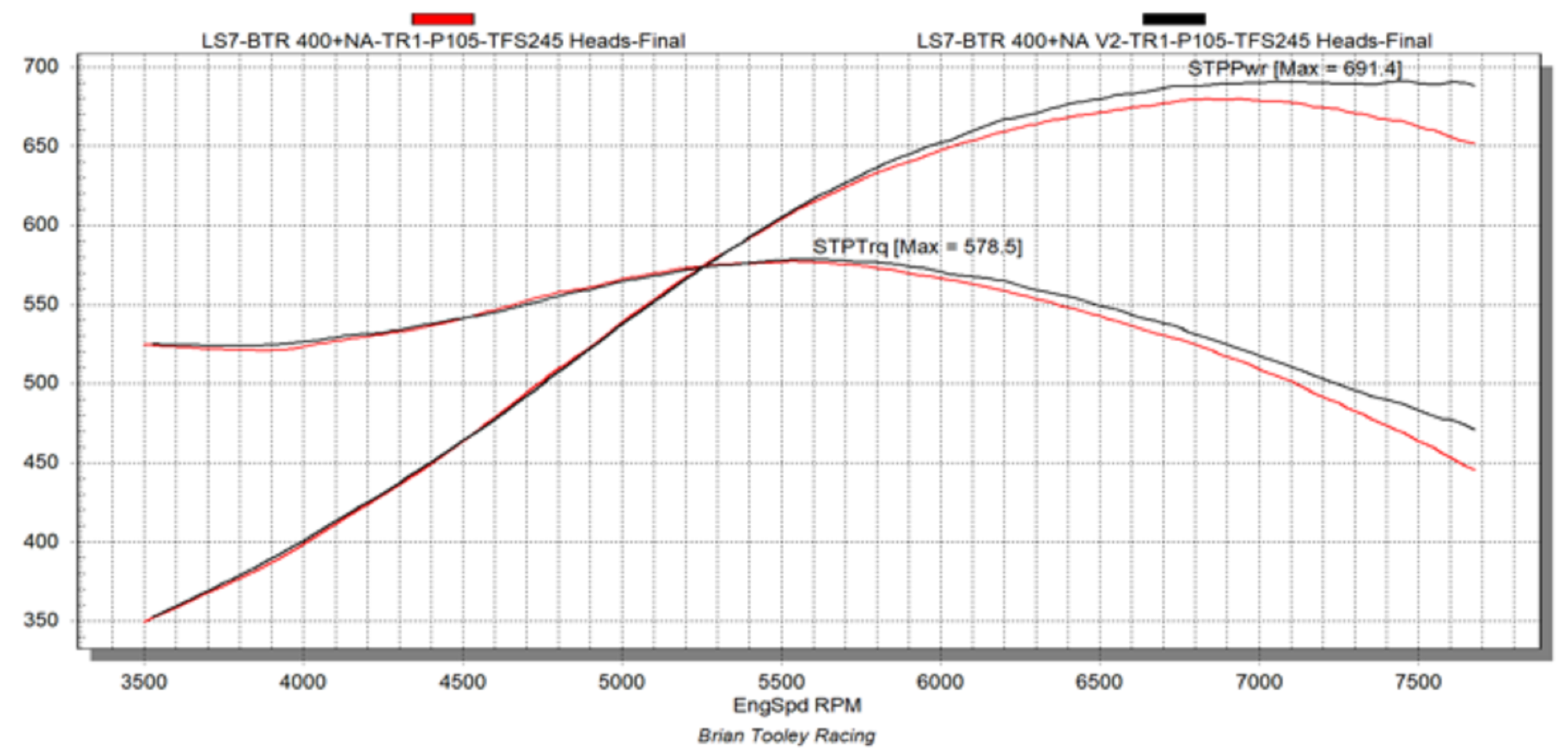

Interesting find:
Here's an engine dyno test of the camshaft in question. Note the curve of the label for the cam: "LS7-BTR 400NA....TFS245 Heads Final." Seems like they ran the same heads with that camshaft on a LS7 and it's peaking around 7k and carrying past. We don't know what intake manifold was used, but the exhaust was probably headers with collectors exhausted straight out the dyno chamber tubes.
