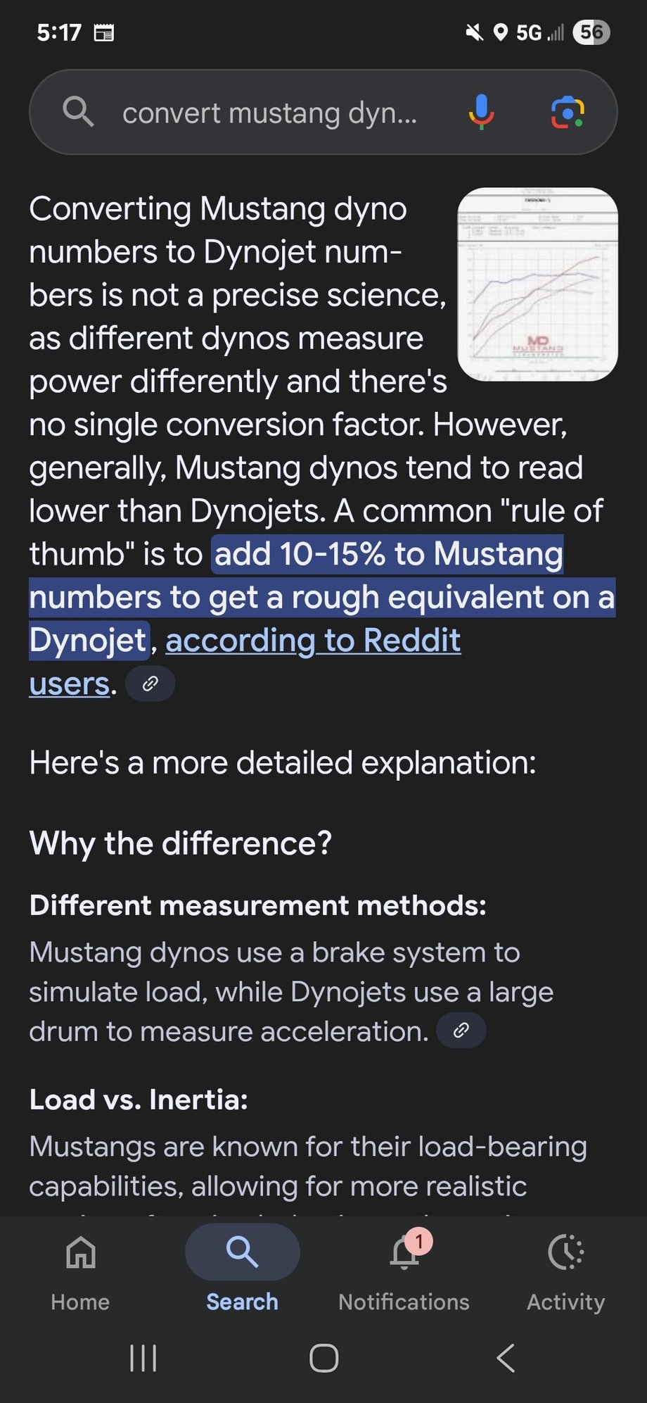

My tuner was the one that said that your can pretty much multiply Mustang results by 1.13-1.15 and get comparable Dynojet numbers. So I googled... Google says the same thing, as you I'm not trying to start a debate just going on what I was told. I've got someone much closer than my guy that has a Dynojet and I'll find out for myself he just seems really expensive to make a rev limit change and make 2-3 pulls no tuning.
Google's AI, just like everything else on the internet, just repeats whatever myths have been written the most in the info it scrapes. Regardless of what you hear, Mustang AND Dynojet numbers can and sometimes are manipulated for various reasons. Even the air pressure in your tires or the tension on the tie down straps can make a difference, and that is without getting into weather correction or other issues. Even engine dyno numbers can be intentionally manipulated, simply by changing the sweep rate. Unless you do pulls on the same dyno on the same day at the same temperatures under identical conditions, the numbers can't be 100% accurately compared to anything.
