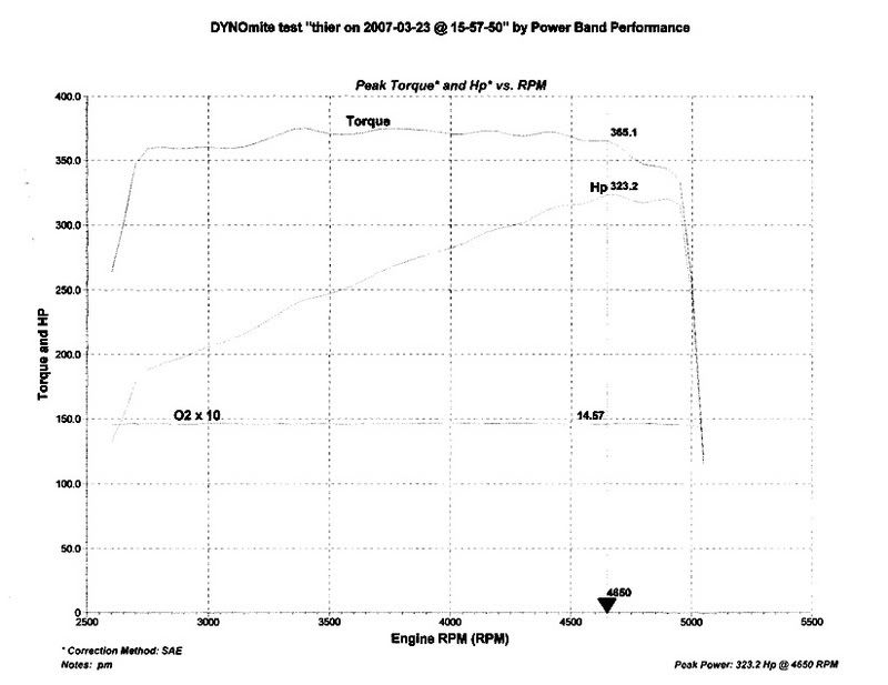

Here are my results:
Better then i expected
My mods: SLP Lid, Magnaflow Catback with no Cats, and LS6 intake manifold that came with car (2001).
Kooks coming on next week + tune.... i should do very nicely

How come the car was only ran to 4800 rpm?

right?! thats weird. looks like you could have ran it a bit higher. looks promissing once you get things worked out.

yea i dont know why the guy didnt run it higher..

am i reading the torque at 365??

A/F looks real lean says 14.57 Maybe that's why he only ran it to 4800.

Those torque numbers are definitely inflated...not sure I'd go believing those.

Seems high to me too... but thats what it says....
the car is an M6
Well, 14 is considered stoich... so its not really lean... but max power is in the 12's so if your talking about as opposed to where the best power output is then yea...

14.63 is stoich, but is dangerously lean for WOT operation. 13.1-2 is as high as I'd ever take mine.

Going to have to agree.
It basically shows over 360 lb/ft from the second he hit the gas at 2700 RPM's.
Not to mention that you don't LT's, ported TB, nor an UD pulley.

Too lean.... Eventually *** boom ***

That dyno run is f*cked, lol.
