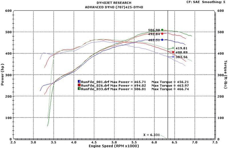

Here is the final N/A numbers for the 01Z.
Mods
383 stroker
Advanced Dyno/ GMPP 243 CNC heads
Fast 90 w/ LS2 TB both ported in house
Callaway CAI
MS3 cam
LG LT's Catless X-pipe
Stock TI cat back
Cartek Clutch
When I got the car it had TSP 2.5 Heads, LS6 intake and TB, and Breathless Vortex CAI. Which is represented with the Blue File
We then put the Callaway, Fast intake and Ls2 TB. Represented with the Red run file.
The Green Run File represents only the addition of our 243 GM CNC heads with stock MLS head gaskets.
The Goal for the car was 500rwp and we just squeeked by.....
Robert
Now for the spray in a few weeks........

I have a dyno question about your graph. How come your horsepower starts at 465 in the first pul then goes on up to 506 in the third run? Is it because you started the run higher in the RPM's? Just wondering because thats what happened on my pulls too. Seemed if I started around 2500 it read lower than starting around 3000. Have always wondered that. Thanks

The reason is that if you actually look at my numbers the first run is actually run number1 the last is run number 33 and was a month later, the reason it was making more on the last run is we changed heads intake and some other items

Aahhh I see
