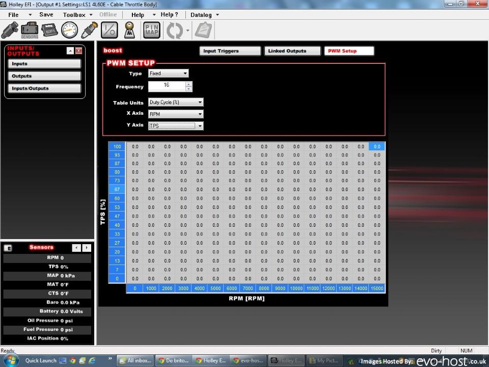

You can configure spare outputs, and you can build a 3d table using lots of parameters to control the output. So yes you can control boost now.
In it/s most basic format use TPS vs RPM.
Using the above, you will be able to control boost vs rpm quite easily
At least the base file LS1 4L60E will let me do it.
Open up the I/O window and go to outputs.
Then choose an output configured as PWM -ve ( ie solenoid receives a 12v from ignition and is pulsed via this output )
Generally below say 20-30% throttle you dont want the solenoid to do anything or it would always be clicking away.
Then just adjust the PWM values in the table vs rpm and you can adjust boost as required. This will of course be trial and error
typically 0% duty = wastegate pressure
100% duty = max boost which will vary on every setup.
Looking at it, you can also control the duty via trans speed, or trans gear. So with either of these vs rpm, it would allow a boost by gear or speed option too.
Old Sep 16, 2012 | 02:31 PM
stevieturbo's Avatar
Joined: Nov 2003
Posts: 13,616
Likes: 185
From: Norn Iron
Something like this. Not sure why it has the axis for gears with multiple rows for each gear. I would just fill the same values for each row to avoid any issues if using boost by gear.
Ideally you would configure the table for your rpm range and gears actually used if it allows you to do that.
Set it as a fixed PWM at around 16Hz ( most valves will be happy at that frequency )
You'll just need to figure out which output pin you are assigning this channel to.
Or with the table TPS vs RPM.

So once the I/O table and config has been set up.
Go to the pin map and you will see this in unassigned channels. Just drop this into one of the GP- outputs and then use that pin to wire the solenoid to.
job done...get out and get tuning.
The software does look pretty nice. They have gone out of their way to make it easy to view and fairly easy to set up.
Although not sure why some stuff isnt there on some maps. Obviously you must be able to add them though

It actually lets you change all the values on the x/y axis quite easily. Just enter the values you want. So you can change the rpm range to a more sensible range, gears etc etc very easily.
You can also add the I/O to the toolbar, just load it up from the Individual Config files.
So even despite no dedicated boost control setup, you will still be able to achieve a very very good level of boost control as it is now.
