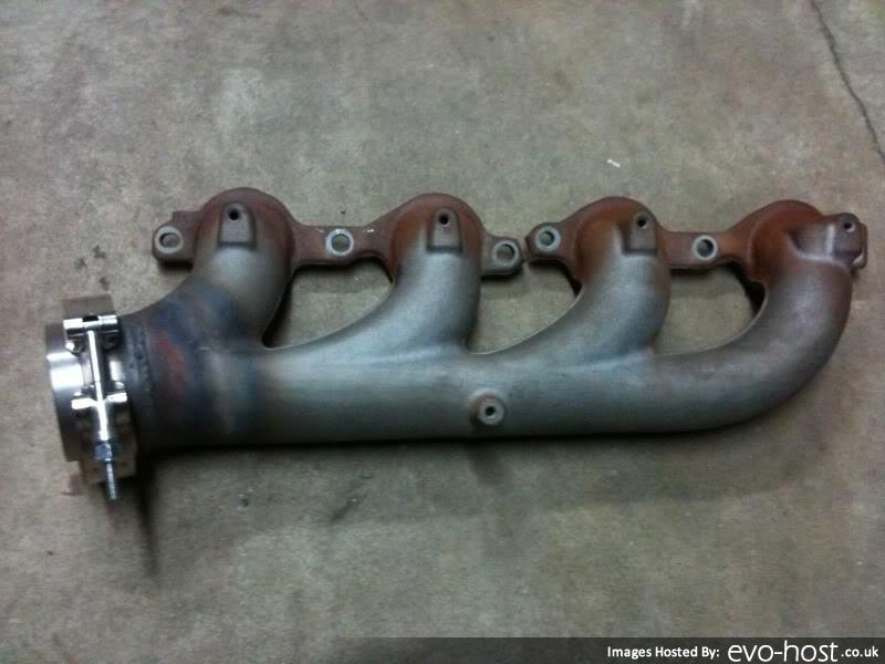

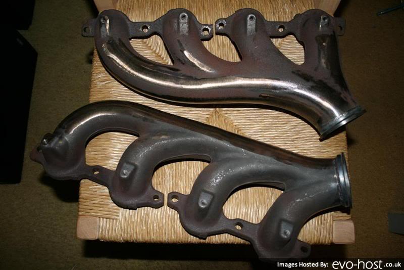

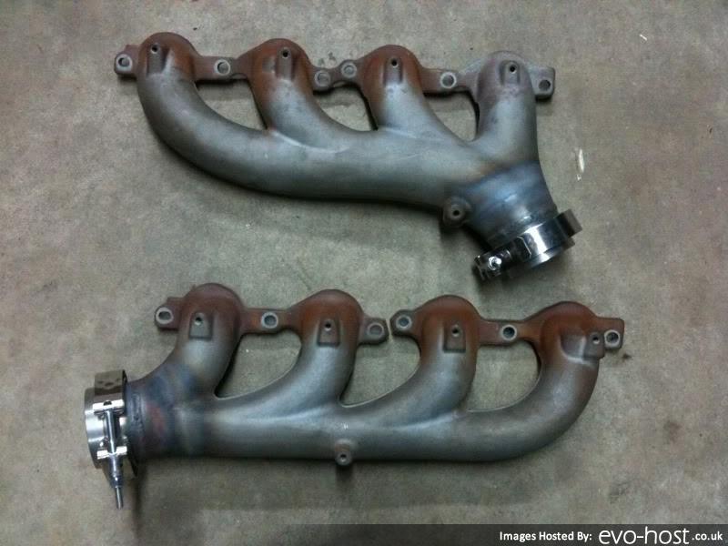

What vehicle are these from ? Mostly the right hand side of the vehicle, but both look useful. Looking to buy a pair, but need to know exactly what I'm searching for.
Same as this ? Would be even better if both had the same profile as this top manifold, relatively straight

they look like truck manifolds to me. the straighter one is the passenger side cut shorter to get rid of the bend

If you are creative you can cut both of them and using a piece of heavy walled pipe shoot them straight out and weld on the V-band that's how I did mine and they come out great. The pass side will require you to cut back further but no issues doing so many here have done it this way.
