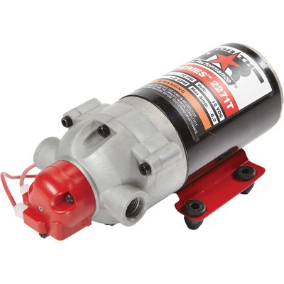

Summit 3gal fuel cell (plastic)
Filter/Regulator - Wix 33737
100% Duty Cylce Sprayer Pump (2.2gpm @ 70psi)
http://www.ebay.com/itm/1-4-NPT-Electric-Solenoid-Valve-12-Volt-DC-12VDC-N-C-RO-Air-Water-BBTF-/290723310425?pt=LH_DefaultDomain_0&hash=item43b075ab59
M5, M10 or M15 Full Cone Misting Nozzles from McMaster (GPH @ 100psi)
http://www.ebay.com/itm/Boost-Pressure-Switch-For-Turbo-Water-Injection-hobbs-/231079977189?pt=Motors_Car_Truck_Parts_Accessories&hash=item35cd70a0e5&vxp=mtr
Plus misc fittings and tubing.
I buy my WWFC (actual product name) from a local manufacturer in 5gal pails. But they also sell it in 55gal drums which would make about 110 gal of final product. Works out to about $2.75-$3/gal for 48/52 mix meth to water.
Every spring, most of these items can be had on sale. I can build a kit with the exact parts I've listed for less than $200 all fittings and tubing incl.
For N/A Applications, I've had the best success with this controller. Pricey @ $150 but it works extremely well. I use this on my high compression N/A Race Car and it made 8% more HP.

I honestly don't think you could put together a kit cheaper that works better. You need a pump that puts out some serious PSI to atomize the mixture well. IMO a 70psi pump doesn't cut it. Add 20lbs of boost through the manifold and now your only seeing 50psi of head pressure. The new 300psi pump is the way to go.
Depends on where you inject it. Most people I've chatted with about meth injection, inject pre-poweradder and let the s/c or turbo do the atomizing. Misting nozzles are not bad to begin with.
No loss of head pressure this way.

The turbo does a poor job of atomizing compared to the nozzle under high pressure. With pre-injection you don't want large droplets striking your impeller blades at high speeds. It will damage them, esp if your using a high water low alky mix.
The nozzles will produce much finer droplets at 300 psi than they will at 70. Also the finer the mixture the more easily it flashes and the better it works in general. Alky also does the majority of its work in the actual cylinder.
