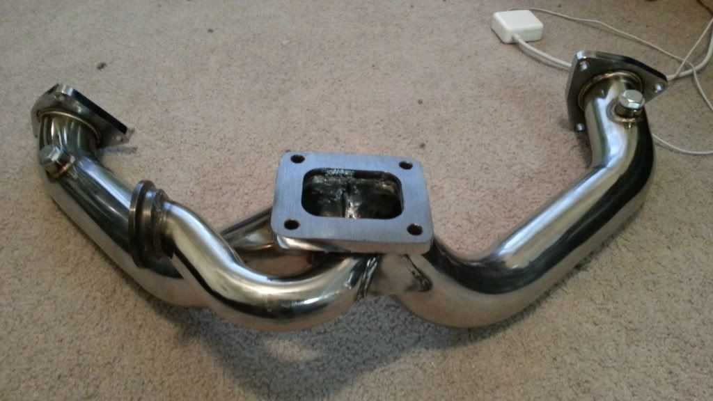

Here is what I have to work with. Would you 1. add a pipe to wastegate in the center on the bottom or 2. cut that one off, weld in the hole, and add two, one per side.
Making the outlet for the cold side in the same location shouldnt be a problem. If the whole hot side needs to go forward any I've already thought about making spacers to go between the hot side and truck manifolds. Up or down any and I can find silicon couplers if the ones I have dont fit.

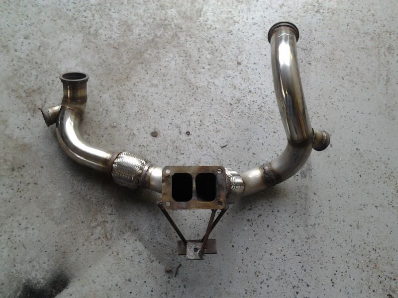

2x3ish. But I would cut the pipes at the bend right before they turn up, do away with the wastegate section entirely, have the driver's side go into one part of the divided T6 flange on the driver's side and then the passenger side go into the passenger side of the flange. Fit one wastegate on either pipe and call it a day. Give me a sec, I will post a picture of mine if I can find one.
Old Oct 29, 2013 | 07:22 PM
Sarg's Avatar
Joined: Aug 2011
Posts: 2,838
From: Atlanta, GA

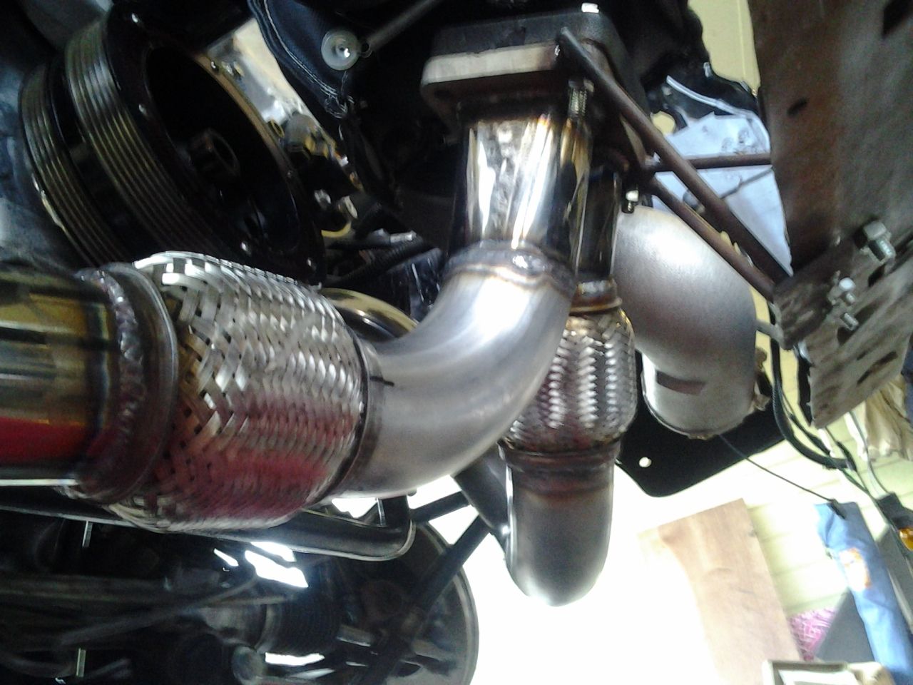

Not the same car, but you get the general idea. For wastegate placement you want to place it where the flow of the gas will be going...try to make it Y off the pipe rather than being perpendicular to it. Mine looks a little odd as the pipes I welded off the C6 manfiolds were a little different for each side. On the passenger side I was making room for the AC should I ever decide to put one on, so it was longer and bent around that area.

The flange with 2.5" pipes going to it...it's not perfect and if/when I redo it I will change some things, but here it is:

Sounds good to me. Thanks for the pics that helps a lot. And I see what you're saying about the wastegate flange angle. Good to know t6 flange will fit 2.5" pipe just fine
