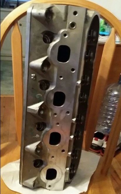

I have a pair of 799's from a 2012 medium duty truck, 7,xxx miles. Unmodified/unmilled and ready to ship, $520 shipped.
good deal here. put a good set of BTR springs on them and they are good to go for 25 psi.
