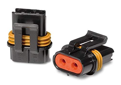

NoGo's Avatar
Joined: Jan 2002
Posts: 2,814
Likes: 110
From: Mass
In addition to what TheBallSS said, don't cheap-out on the plug. The plug is often overlooked, but if you use a plug that isn't rated for the work, despite everything else being right, it can be the reason you are melting connections, wire, and blow fuses after a period of time. The delphi 2-pin metri-pack (630 series) is a good OEM-quality plug rated at 46 amp and makes a good reliable connection that won't cause voltage drops that can cook your stuff.
