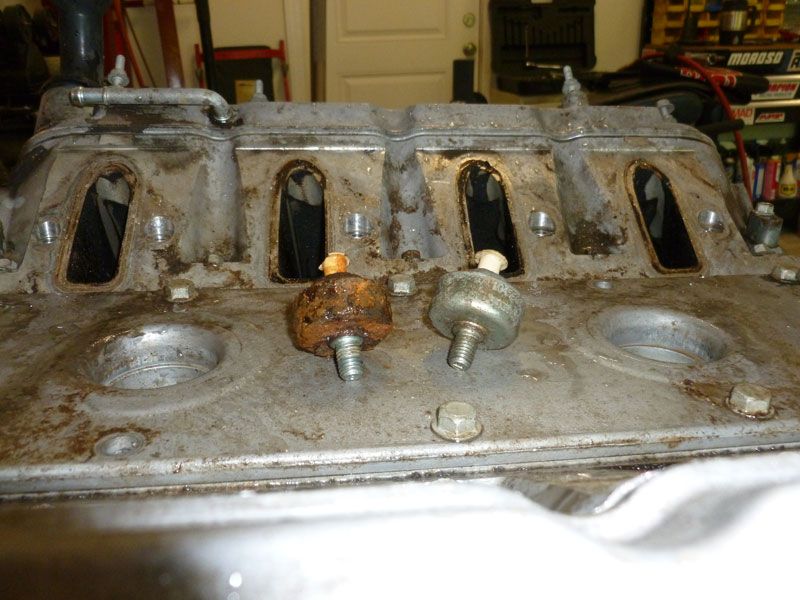

Has been a busy weekend, but this evening I finally got around to tearing this engine down and so I've attached a few photos for anyone interested.
First I pulled the oil pan plug and found some tasty little treats in the form of three needle bearings and a few shaving of metal. Exciting stuff...
Next I noticed after taking off the intake the the valley pan was missing two bolts which leads me to conclude someone had been into it at least this far
Pulled the heads
This is not the best picture but the cylinder walls looked good overall as I could still see the cross hatches in all of them
The #5 cylinder ended up holding the failed lifter. I could see the lobe on the cam was in bad shape as well
That is as far as I got tonight. Hopefully in the next day or two I can get the oil pan off and see how the rod bearings and crank look.
