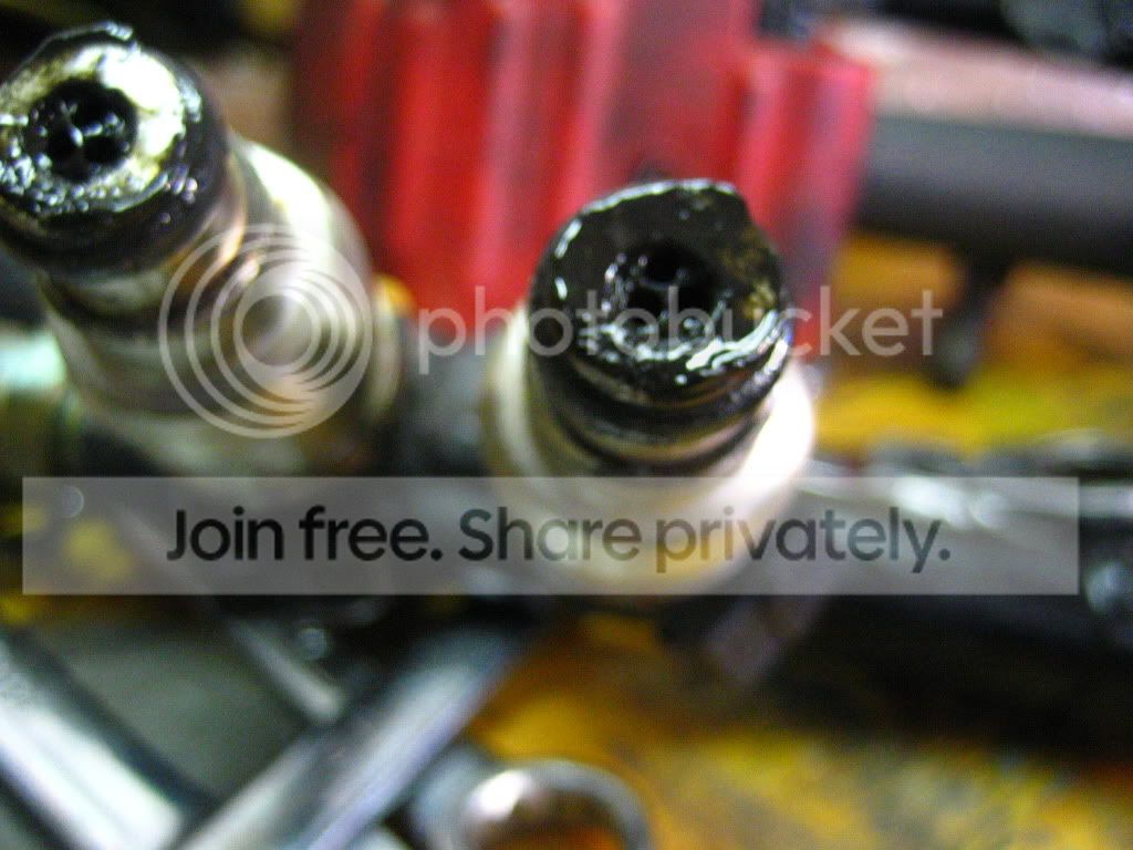

Reason I ask is I have E85 injector "Goo" build up. Which is due to an additive (PIB) placed in the base gas that is mixed into the E85. It is not a product of E85 nor is it Gunk/rust etc form the fuel system/filters. It "crashes out" of the fuel mixture as it exits the injector.
Everything I've read about products claiming to clean your fuel system with a little bottle have always seemed like total BS to me. Especially when you look at the MSDS and see it's mainly petroleum distillates (paint thinner) and dye. But if this Lucas Safeguard actually helps/cures this problem I'd be very interested. I'm just skeptical is all...
Heres the info on the E85 build up most locals I know see. Again, it has nothing to do with gunk in the fuel system or incompatible materials in ethanol. Not that E85 won't break down sludge in a dirty fuel system as well, but it usually doesn't make it to an injector tip. This additive is also region specific. Not all gas companies use the PIB additive so some lucky folks out there never have to deal with this garbage.

Here is the build up on my injectors...

Your talking about Lucas Safeguard Ethanol Fuel Conditioner specifically?
Yes I am talking about the Lucas stuff. I dont personally use it (I do plan on it) but my tuner swears by it and he tunes a TON of E85 cars cus its so popular around here. I have been lucky enough to not experience that "goo". i have heard of it and i even know someone who has sent samples of some E85 by-products (goo, buildup, etc) to independent labs and they cant come to a definitive answer on what exactly the stuff is or how it forms. Its a very strange thing.
I'm convinced its the additives you are talking about because i have yet to hear about people experiencing these problems when they fill up from the stations i do. I usually only fill up at a select few stations during the year once i know they are good. Some call it crazy but I have had absolutely zero issues and i'm not doing anything special other then sticking to a few specific stations. My 80lb injectors were spotless after 2 years of nothing but E85. I threw in FIC 127s this year, so we'll see what happens.

Probably not the same stuff. The build up I'm talking about only shows up where the fuel can crash out of the air/fuel mix at the injector tips and or carb/intake. Guys also experience less goo with external pumps and large fuel returns. Seems like the more the fuel heats up the worse the injector tip build up is.
Shouldn't be any air to expose it to in a sealed fuel system. That was probably crap in the barrel or your fuel system? Not sure though thats just me guessing from what I've read about it.
