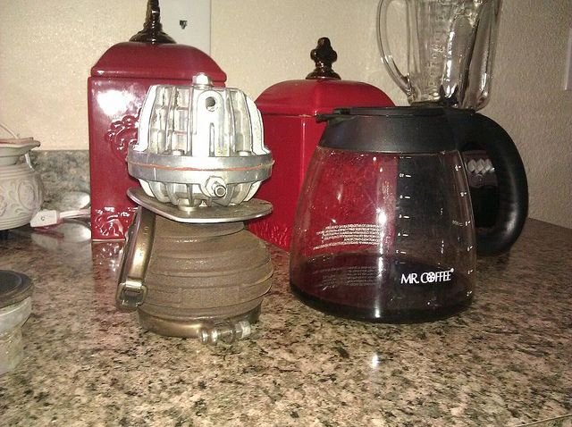

i want to run a single wastegate, what size is the right for me ? is 60mm too much?
this is the 60mm wg im asking about https://ls1tech.com/forums/forced-in...l#post17112245

Its hard to have too much Wastegate. It's easy to have too little Wastegate...

With that turbo if your trying to keep the boost down, run a 44mm. higher boost, the 38mm should be okay.

so the 60 is a complete overkill?

Check out the Turbosmart Big Bubba 52mm. I use to have a 38mm but I was getting some impeller flutter with it. No problems with the big bubba at 700rwhp.

like the man said, can never have too much gate. Course then the Gate is 1/2 the size of the turbo then, that would look "interesting"

a turbosmart hypergate 45 will be plenty for that setup...
