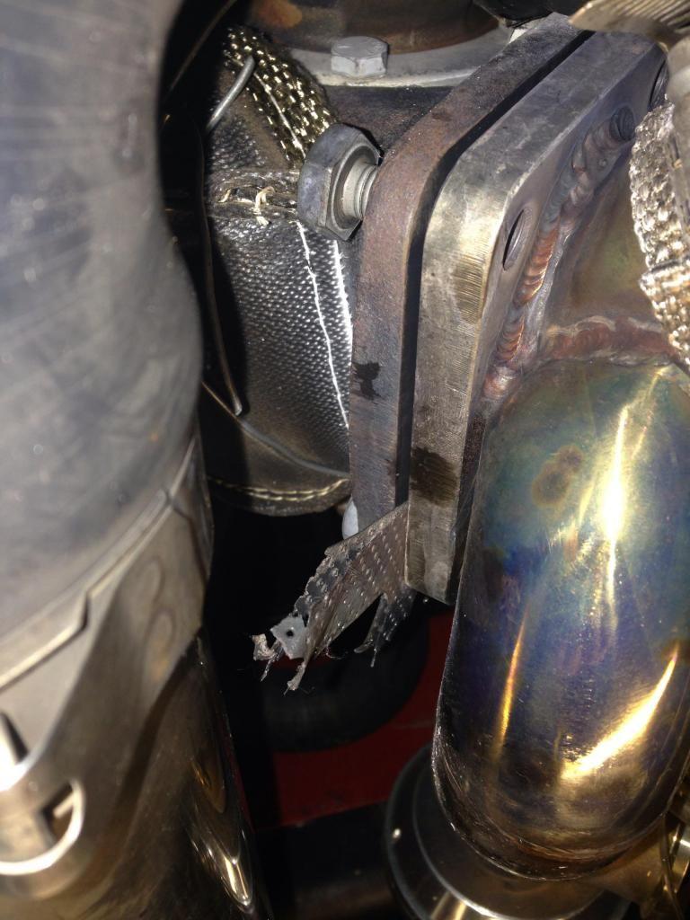

Yea... Well I found the problem. Anybody have this happen? Not sure if I blew the gaskets out and than the bolts backed out or the bolts backed out causing the gasket to blow out... I didn't have a boost leak, but I had a HUGE exhaust leak lol.

^^That's not good. I stopped using gaskets and only use the copper spray.

Now there's why you slowly lost boost, if it were the controller you would have lost it all at once..
You were saying you hoped for it to be the controller but this is cheaper fix.
I would use some copper spray on the flange (both surfaces) an stick the gasket between it still. And then use some ARP thread lock on the bolts. Its meant to withstand high temps Vs locktite. .. I have almost stripped out bolts trying to remove them a day after using the ARP ... it's that good
.. it's like $8 for a big tube off summit. . About 10x bigger tube than the locktite tube so it's well worth the $ ..... its white paste not blue or red
Cool sounds like copper spray and some thread lock in my future!

I had mine do that to me once. The only time I ever had problems was when I had a gasket in there.... Only use orange RTV now (no gasket) and haven't had it leak since.
Yeah if both pieces come together straight with no resistance(freely) than there's nothing wrong with no gasket.. especially if your having problems blowing the gasket..just spray the **** out if it and get that ARP stud sealant and blue locktite. 'I use it on fuel fitting and everything, but it's made for fuel fittings...non hardening (but it locks your threads)
I'd use blue locktite on the bolt ends and the thread sealant down the center of the bolt where it will going though where the gasket would be. ..I tend to do stuff a little over kill but better than ******* with it twice!
