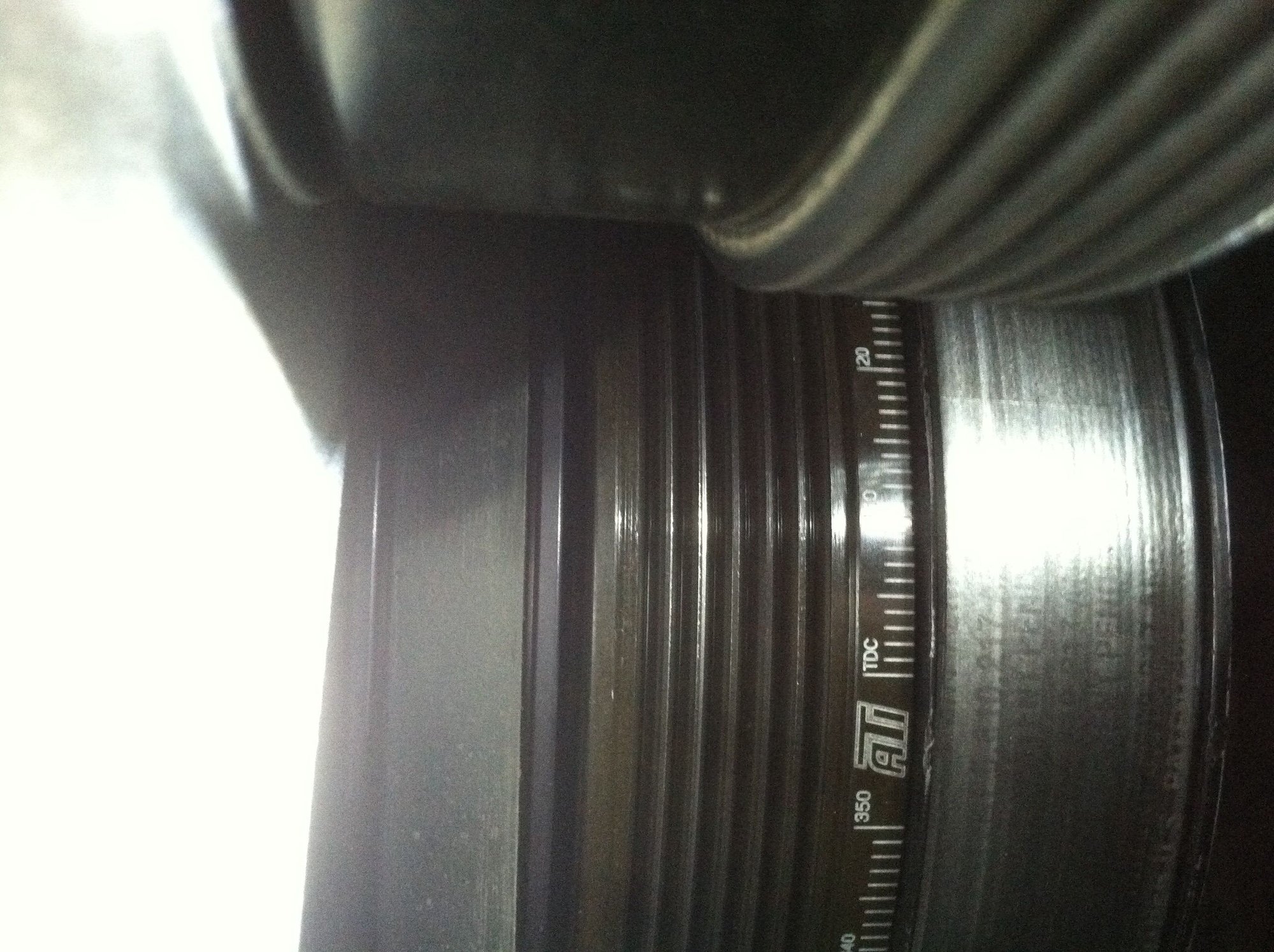

I cant seem to find a pic of what way it should go on. I got it from the previous owner already assembled. I can say that the flange where bolt holes are in the a/c pulley is tapered away from the hub. Gonna go pull it and revers the pulley to see how it looks. Thanks for the idea.
Ya a/c pulley shouldn't have any gap between it and the main pulley that might be your problem

My bad I lied lol was able to snap a pic real quick. should look like this. Hope it helps man

Originally Posted by 6togo
You can also install the A/C pulley on the main hub backwards which throws the alignment off.
Winner, winner, chicken friken dinner!!! This just goes to show that you never just install something without checking first, even if its already been ran and presumed to be assembled correctly. Everything lines up correctly now, thanks guys.
Yes that helps to make sure I have it right. It was reversed and there was no gap at all between the two rear pullies. Some people, I tell ya.
