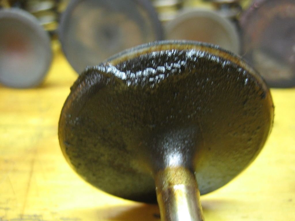

Gunks up the valves? WUT? Got any pictures of this? I just curious, all my engines have been crazy clean inside.
I have only had black goo on my filters, haven't had any issues with injectors. Unless you you want to talk about junk id2000s.
Dealt with it for years here on many different cars. There is also a product called "Carb Defender" that works well. Also had good luck with straight toluene.
I didn't have good luck with the lucas stuff. But I didn't run it consistently either.
http://www.summitracing.com/parts/jg...mqgaAjMm8P8HAQ

HOLY ****. **** that.
Never witness anything like that. Sure it was from the fuel? And not something from the system?
Yes, It's the fuel.

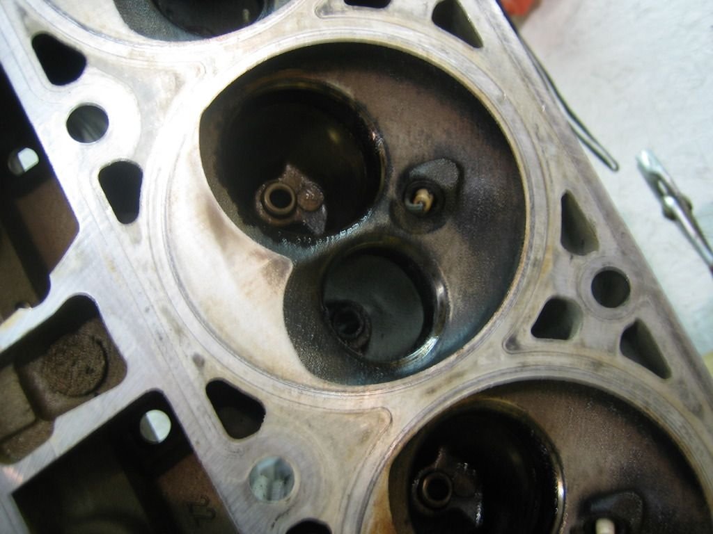

Man Ron, yeah you sure were getting some goo. Here is a picture of my heads after have been on e85 for about a year. I took out my siemens 60# injectors after the same length of time, and they looked pristine.
Old Jan 14, 2015 | 06:25 PM
GMCtrk's Avatar
iTrader: (23)
Joined: Jul 2004
Posts: 9,853
From: Houston, TX
Get your e85 from a different gas station/supplier. I've never had any buildup whatsoever on my injectors and the truck sits for a month at a time sometimes.
