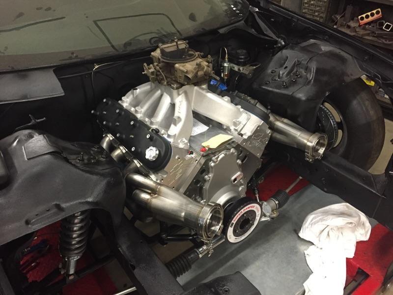

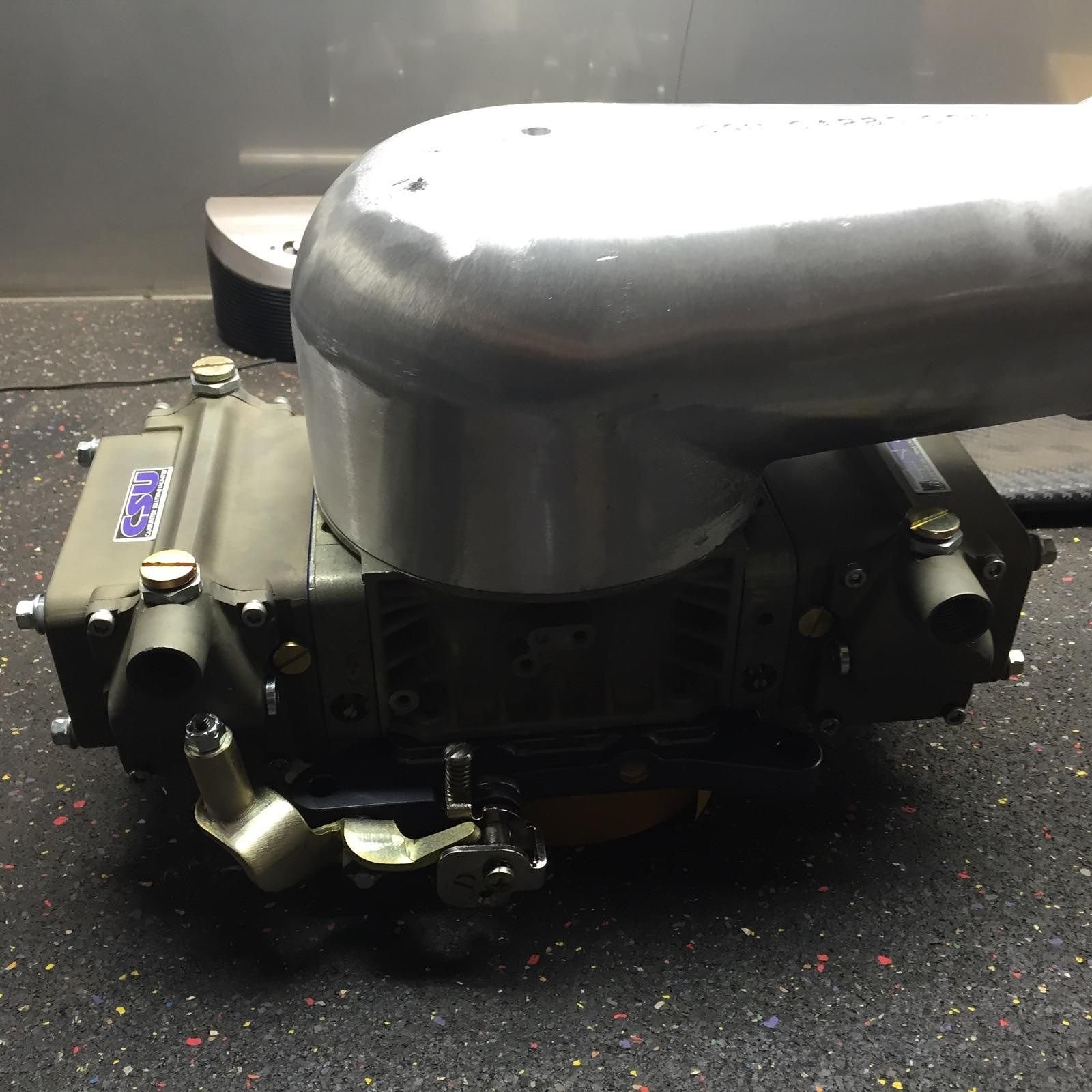

Posted in carb section no luck there. My blow thru csu carb setup dart lsnext block basically ls3 valvtrain, Carillo rods callies crank it's a 410 destroked 454. and the car starts right up and runs idles fine but on the msd software it comes up "cam sensor failure" any ideas? I heard about the sensor being to close to the cam gear and putting a washer inbeetween the sensor.the cars not q100% done but I want to figure this out .

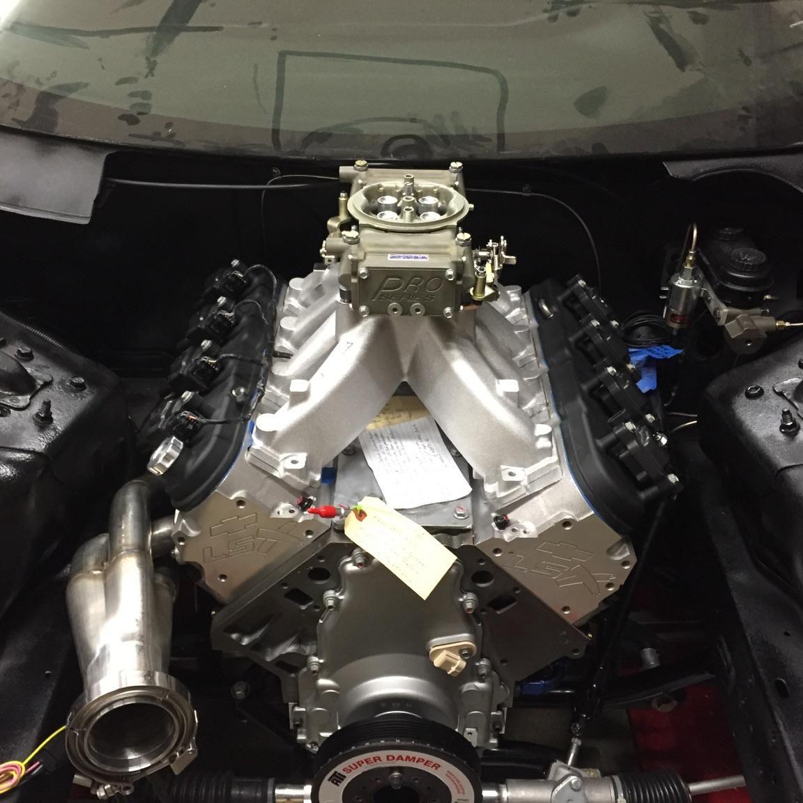

That's odd, I didn't have any problems with mine. What cam sensor are you running? Try a known good sensor? I haven't had much luck with other carb blown thru guys on here.
