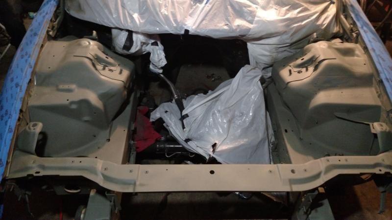

While everything is out I'm painting the engine bay. Got the radiator support cut out and ready to go. First time doing something like that but it turned out great in my opinion.

Engine bay is getting there. Still have to finish sand and clear.
